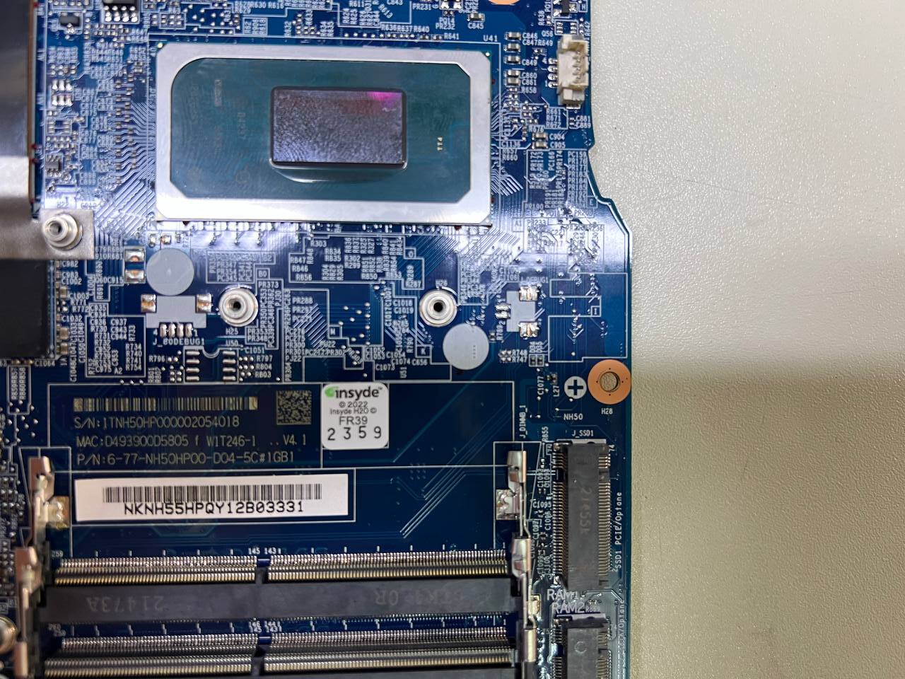

Looking for a working BIOS for GIGABYTE G5 KD laptop motherboard NH50HPMB-0D
  • dl1nn1u
    • May 2019
    • 6
    • Ukraine

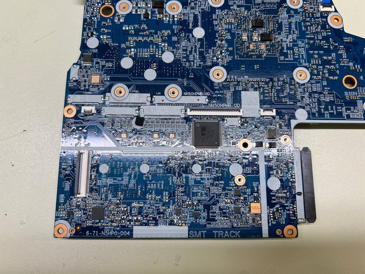

    There are also markings on the motherboard
    6-71-N5HP0-D04
    SN/ 1TNH50HP000003054018
    P/N 6-77-NH50HP00-D04-5C#1GB1
    The problem is as follows
    The laptop turns on, there is no image or backlight, after a minute the fans turn on, there is no old BIOS dump, please help​

      I installed the firmware for the u52 chip and flashed the EС, the result is the same, if there are options I'll still wait. Thank you
      After pressing the button, the laptop turns on the keyboard backlight, it changes within 1 minute, and then the fans turn on to maximum, and after one minute the laptop turns off. There is no image on the display, there is no display backlight, there is also a reaction to the on and off button. Without RAM, the laptop behaves the same way, I'm surprised.

        The dump is working, the problem was on the motherboard

            The hub was damaged, replacing the hub solved the problem
