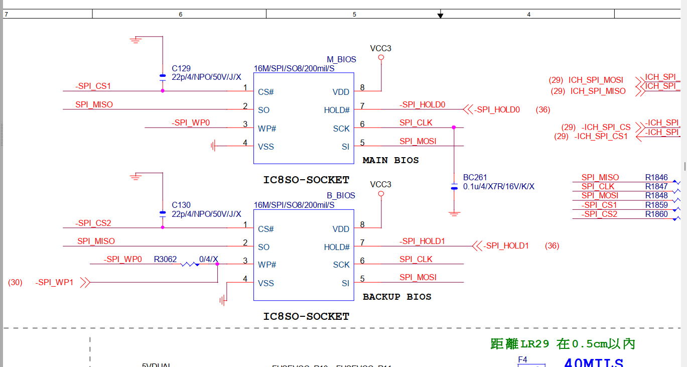

Gigabyte G1 Assasain motherboard Bios IC model or Schematic needed !

    Gigabyte G1 Assasain motherboard Bios IC model needed !
    Bios ic fried and I cant read the model on top.
    Thanks !

    mx25L16 or 25x16 or25q16 Click image for larger version

      Many thanks - Can you share schematics as well ?

        Schematic G1 Assassin
