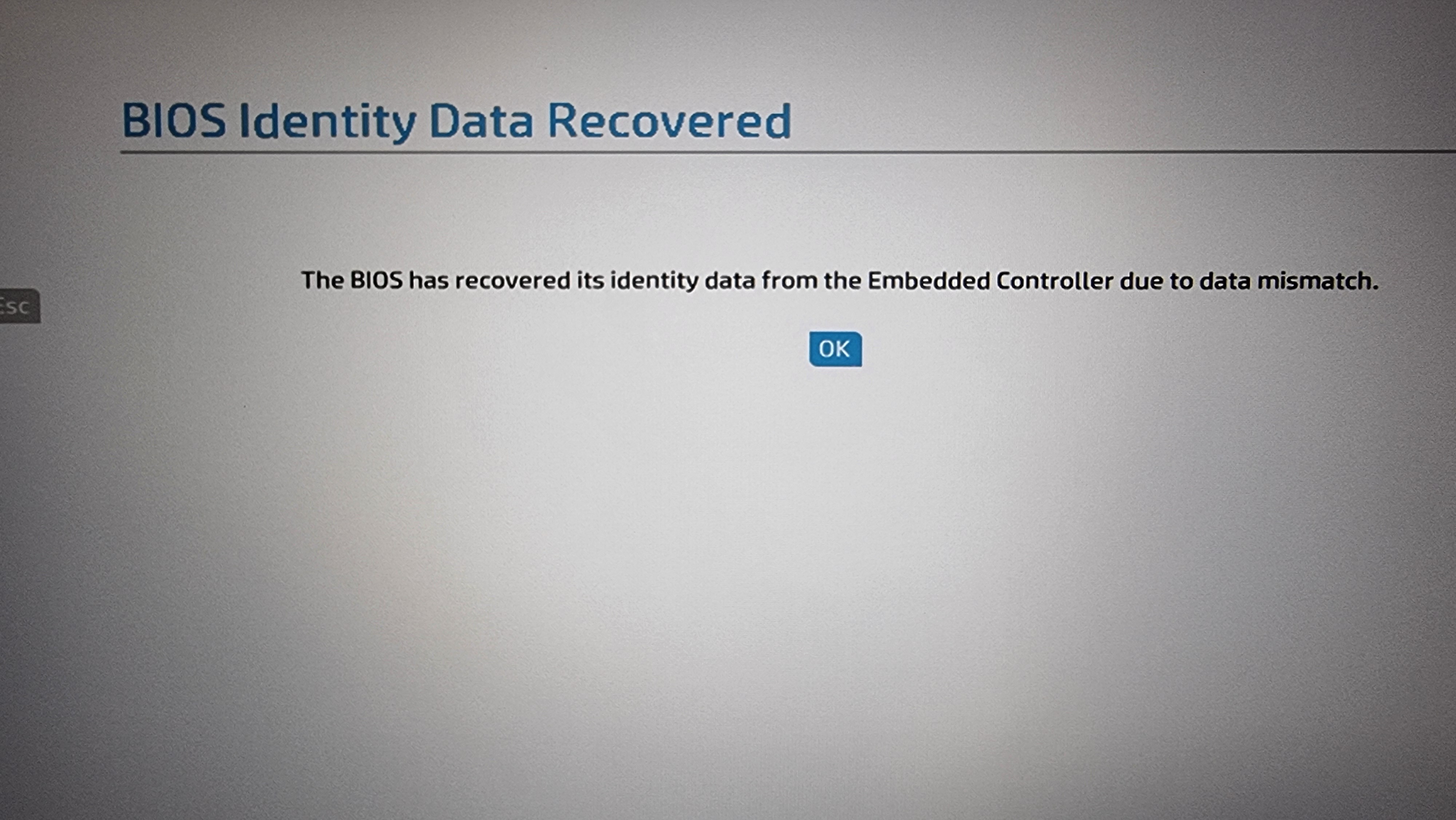

Hi, after applying post 120 the password prompts for F9, F11 and F12 were disabled, but unfortunately not F10. After flashing both chips (and re-reading and verifying against supplied bins) the HP Elitebook 840 G10 went through its normal few reboots, but before I got the opportunity to get to a point where I could press F10 to set factory defaults, I was presented with "BIOS Identity Data Recovered: The BIOS has recovered its identity from the Embedded Controller due to data mismatch"
Anyway, please see attached dumps. Hopefully they can help identify a resolution

use my post # 120Hi, after applying post 120 the password prompts for F9, F11 and F12 were disabled, but unfortunately not F10. After flashing both chips (and re-reading and verifying against supplied bins) the HP Elitebook 840 G10 went through its normal few reboots, but before I got the opportunity to get to a point where I could press F10 to set factory defaults, I was presented with "BIOS Identity Data Recovered: The BIOS has recovered its identity from the Embedded Controller due to data mismatch"

Hi rex98, yep attempted post # 120 twice before reaching out. Never got the opportunity to F10 to reset factory settings as the "BIOS Identity Recovered" occurred before that

Yes, also re-read both main and EC to verify again against bins. I have tried another two times today with same result.
After the "Recovery" screen I also tried just reflashing the EC. Password still required for F10Comment

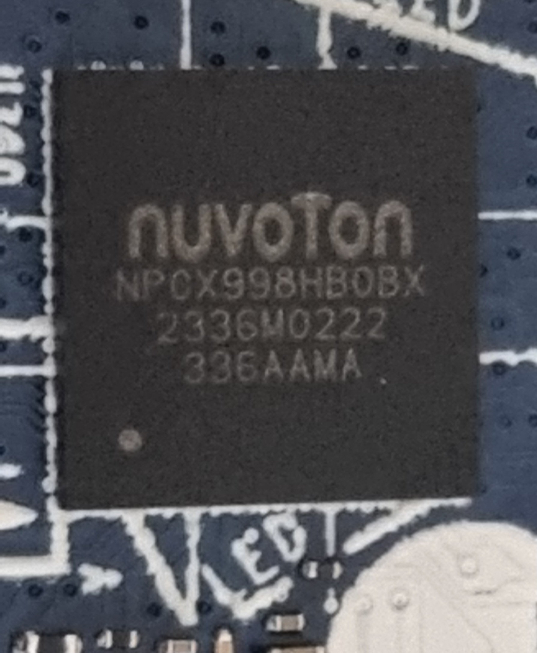

dont try anymore, replace super I/O with other which no password. what's your mainboard super I/O?Comment
Managed to solve the issue. I modified your EC.bin provided in post # 120 and cleared NVRAM ActiveRegn.
This time, instead of the EC recovery screen, it threw the "Entering MPM" and was able to F10.
Password now gone. You are a legend rex98.
Probably best to verify attached before use.
