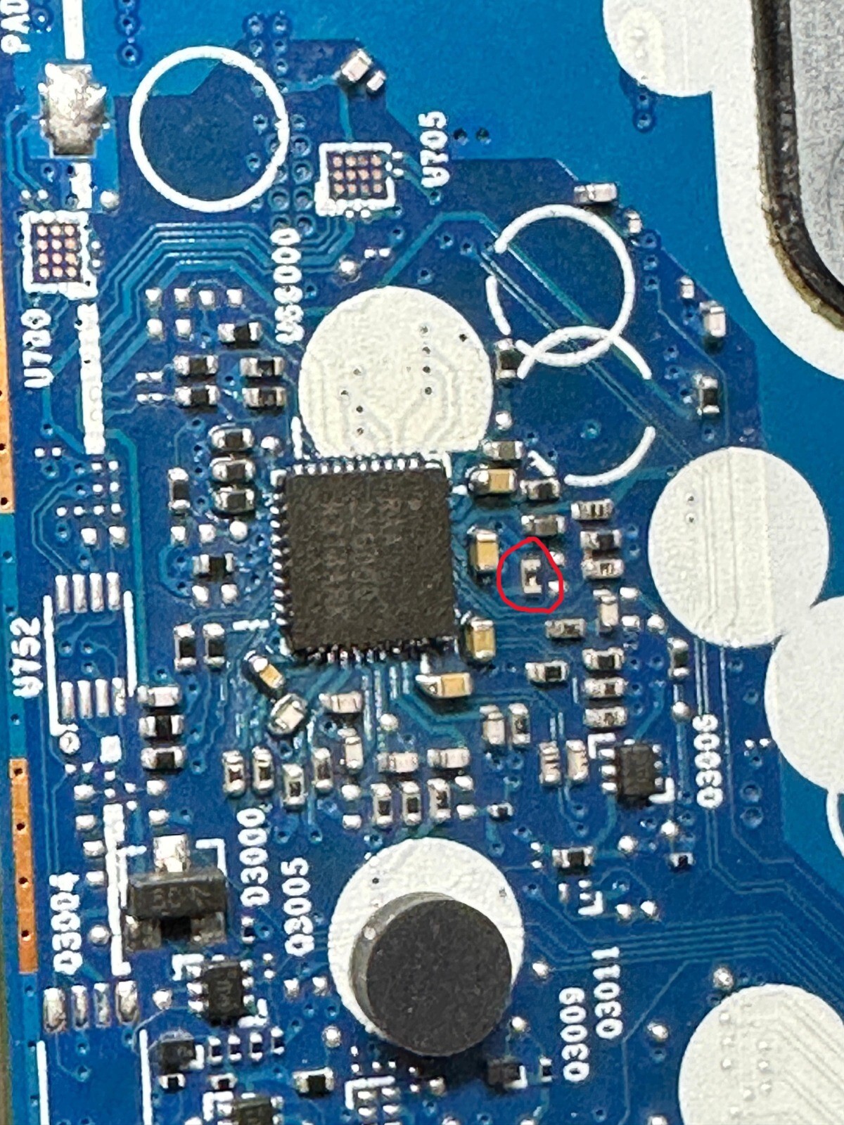

                            #174
                            plz if someone have 840 g10 motherboard can tell me this resistance value
