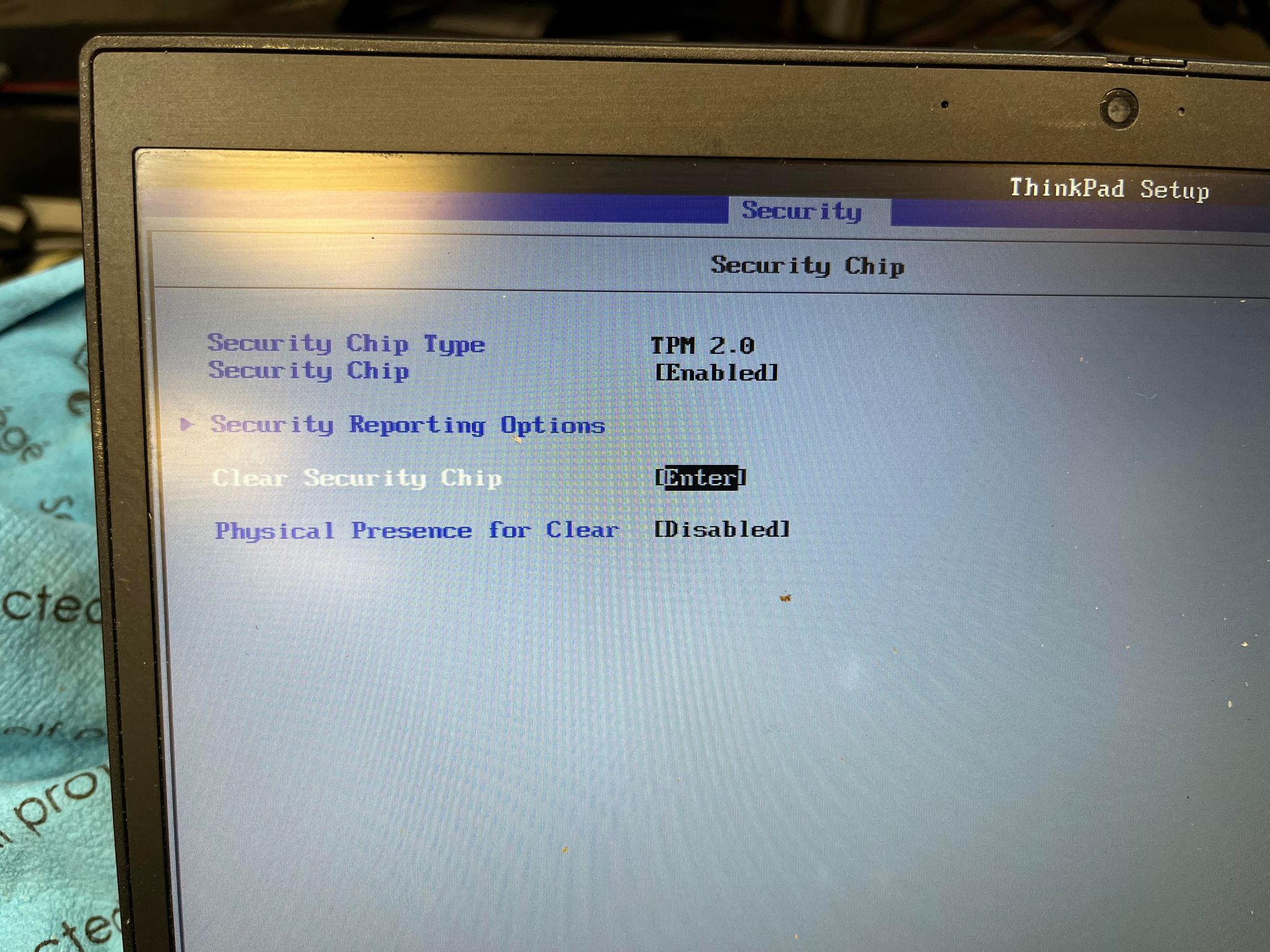

            Please can you explain "clear security chip"??
            Sorry but I never do it before.
              look
              • gsoft
                • Jul 2023
                • 38
                • Italy
                look
                Thanks really thanks.
                I will try and then update you

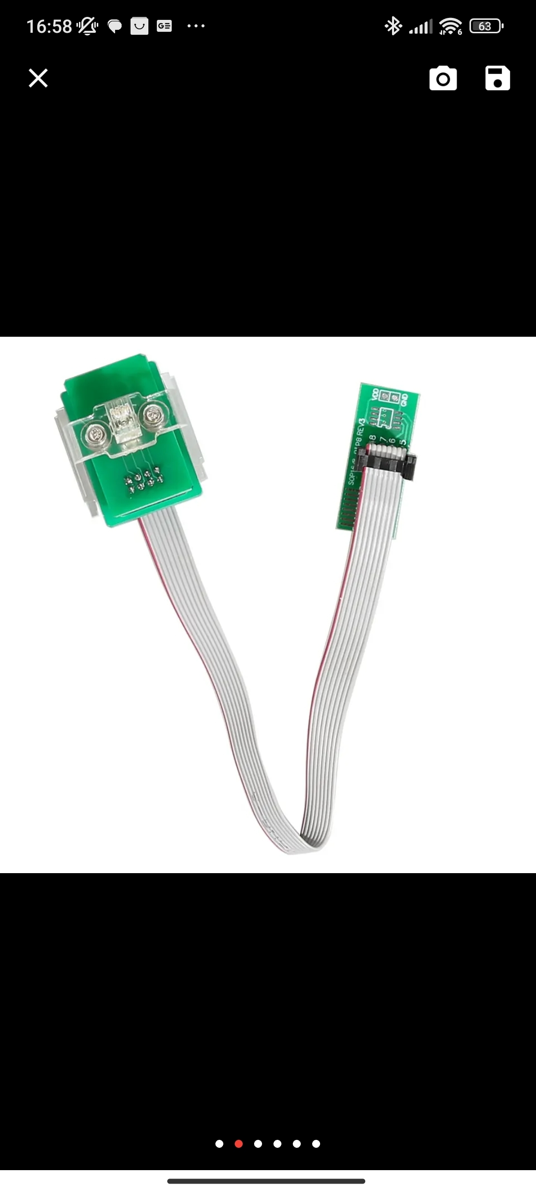

                  Sorry I can't try it now because soic8 clip not want to fit on chip 😞 I ordered a new one hoping it fit better
                  • gsoft
                    • Jul 2023
                    • 38
                    • Italy
                    #29
                    Because with the clip I have problem ti CLAMP the IC, do you think this che be good for a winbond 25q128fw?
                    https://a.aliexpress.com/_EuNeV8J
