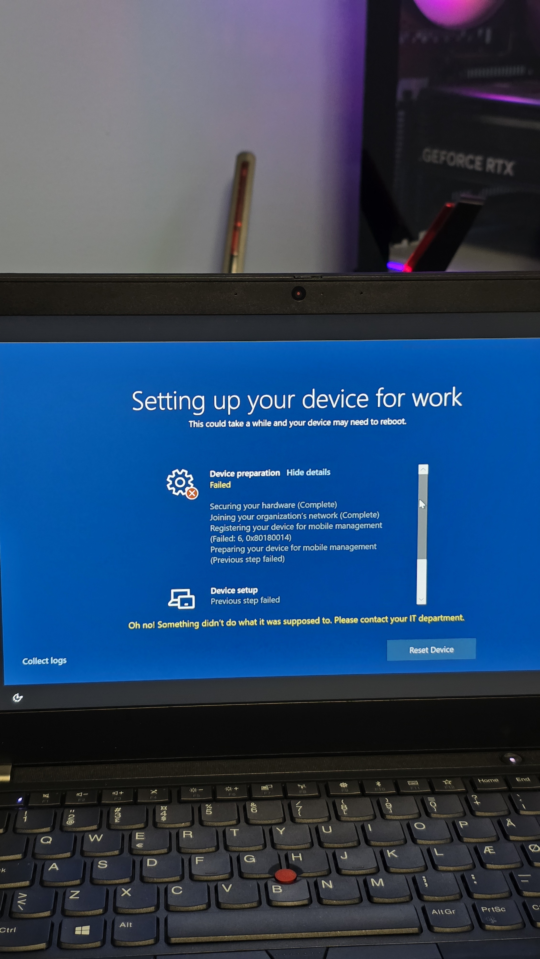

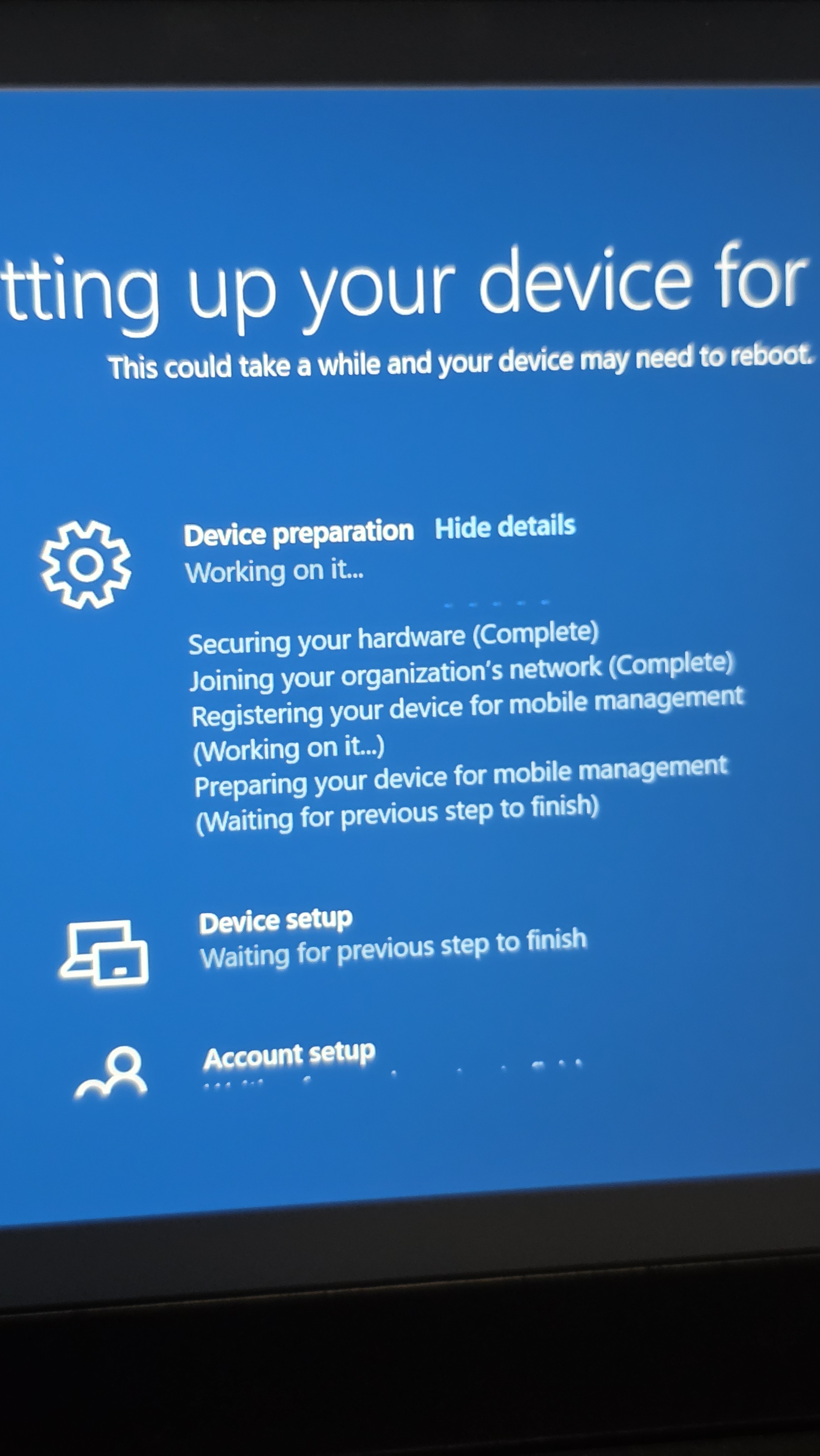

                                  Hello. I bought this laptop T495 and i think he have autopilot or MDM i don't know sure.. but the thing is that i can't install windows on it.. after i install windows i have to log somewhere.. this happened few days ago.. but now.. after i tried few things i generated another UUID and now this laptop can't connect to that server or idk how to call it... "mother ship ". I will attach bellow one picture. And one more thing. I saw that in bios i have OA3 license installed, preinstalled license. And one more thing, the laptop had supervisor password on bios.. but i managed remove it and to disable everything on bios that could block me to install the windows. It's there a way to resolve my problem? Thank you very much!

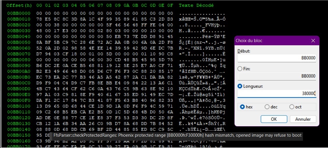

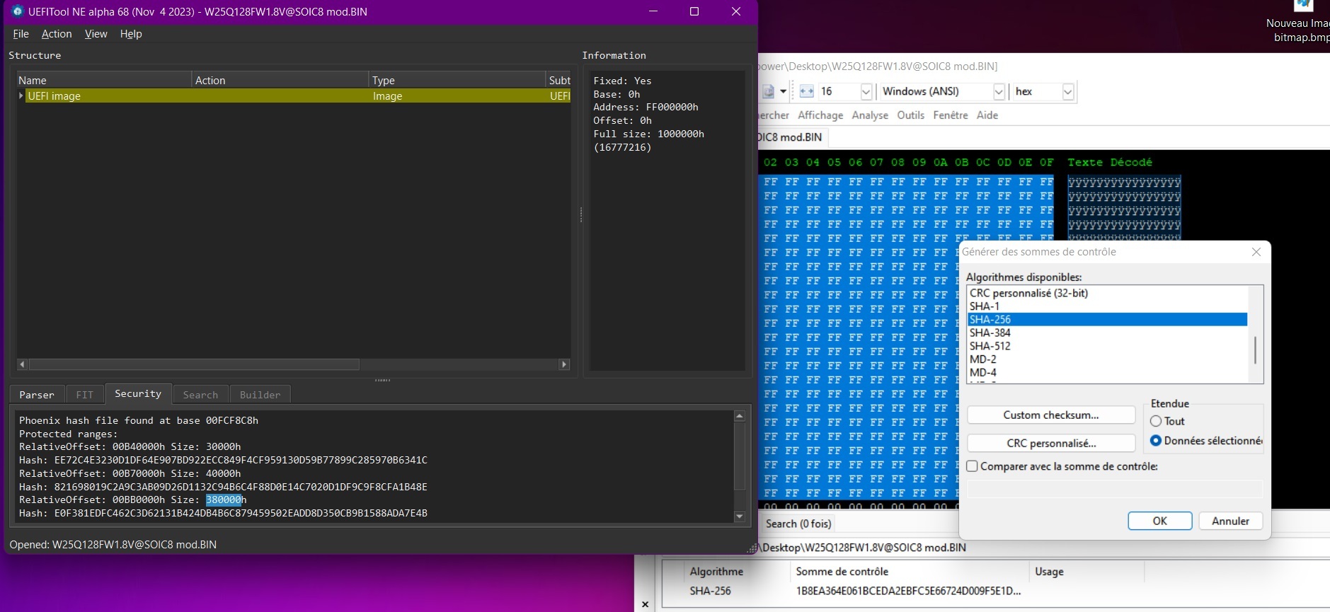

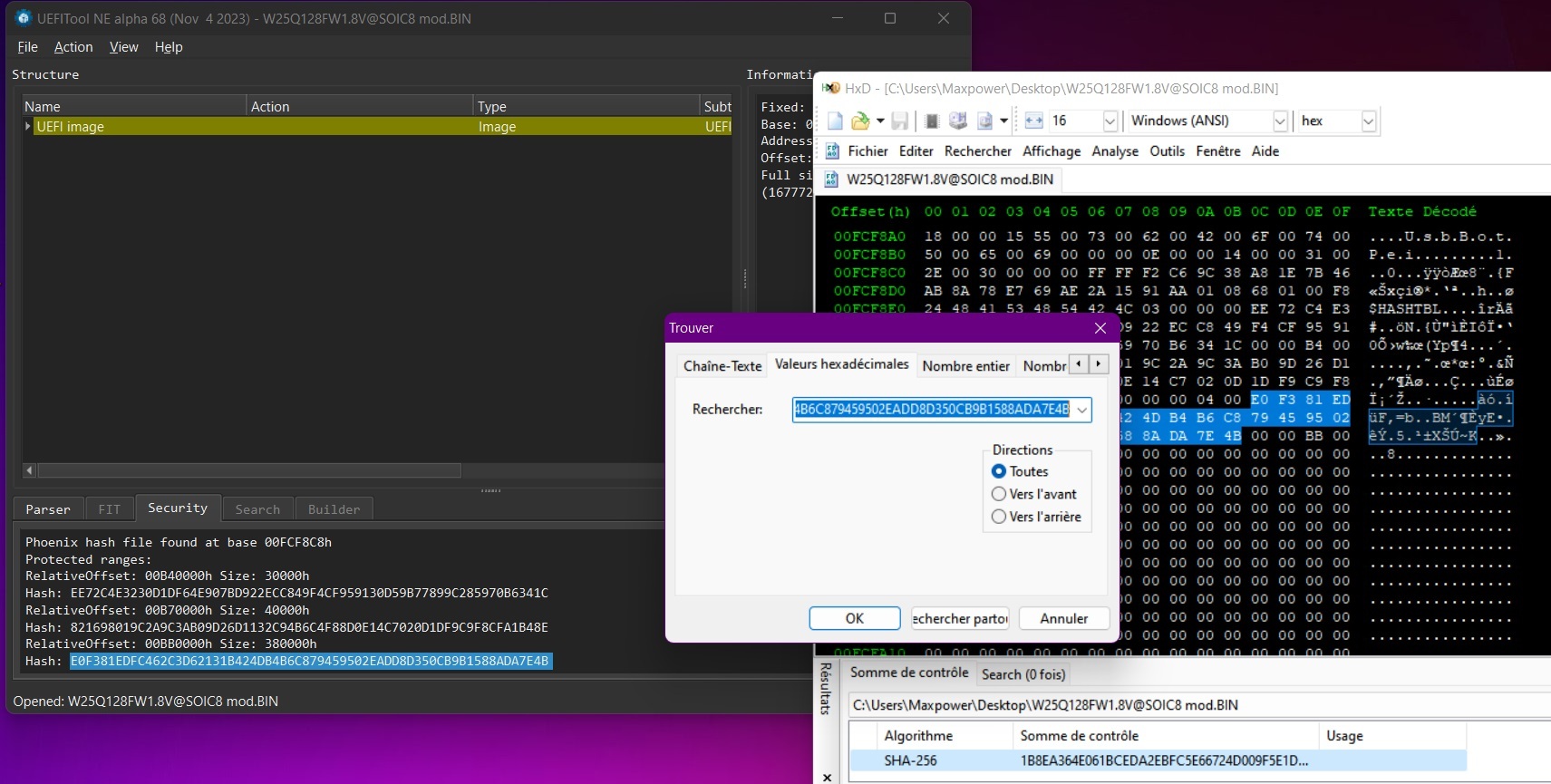

                                    Hi y'all. Would anyone happen to have some advice? After I did the Lenovo autopatcher, no post, black screen. I tried with a different bios as well, same result. Original bios working, but it needs password.
                                    The original bios is in the attachments as well the patched
                                    FA495 NM-C131 rev 1
                                      • 22109
                                      #78
                                      Post the laptop serial number https://www.badcaps.net/forum/troubl...before-posting
