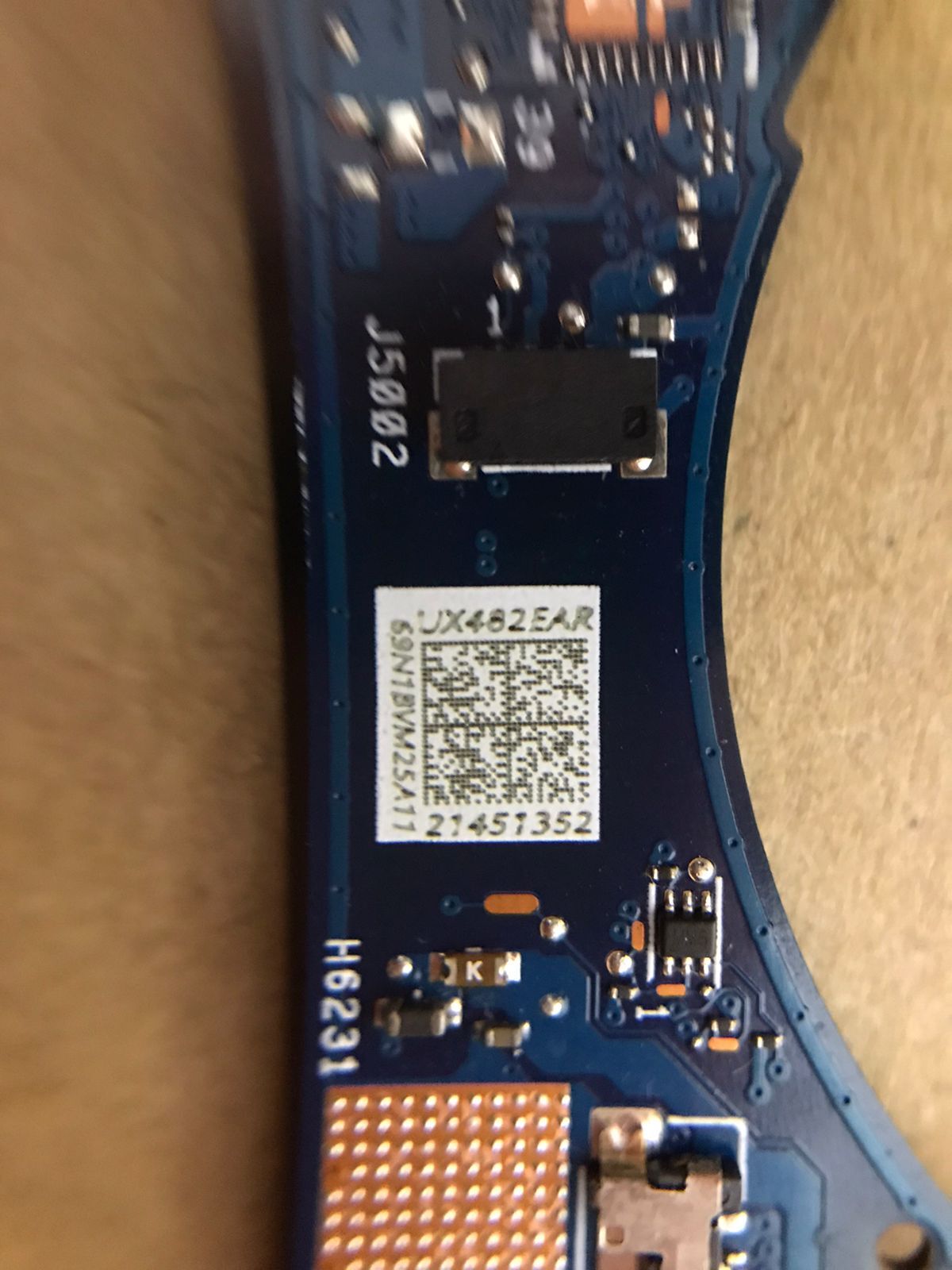

                  #49
                  i need help
                  bios repair for Asus UX482EA
                  no video no fan
                  thanks

                    #50
                    Originally posted by rifmann
                    i need help
                    no video no fan
                    thanks
                    post the S/N, post the original content of the bios chip, the motherboard model, etc.

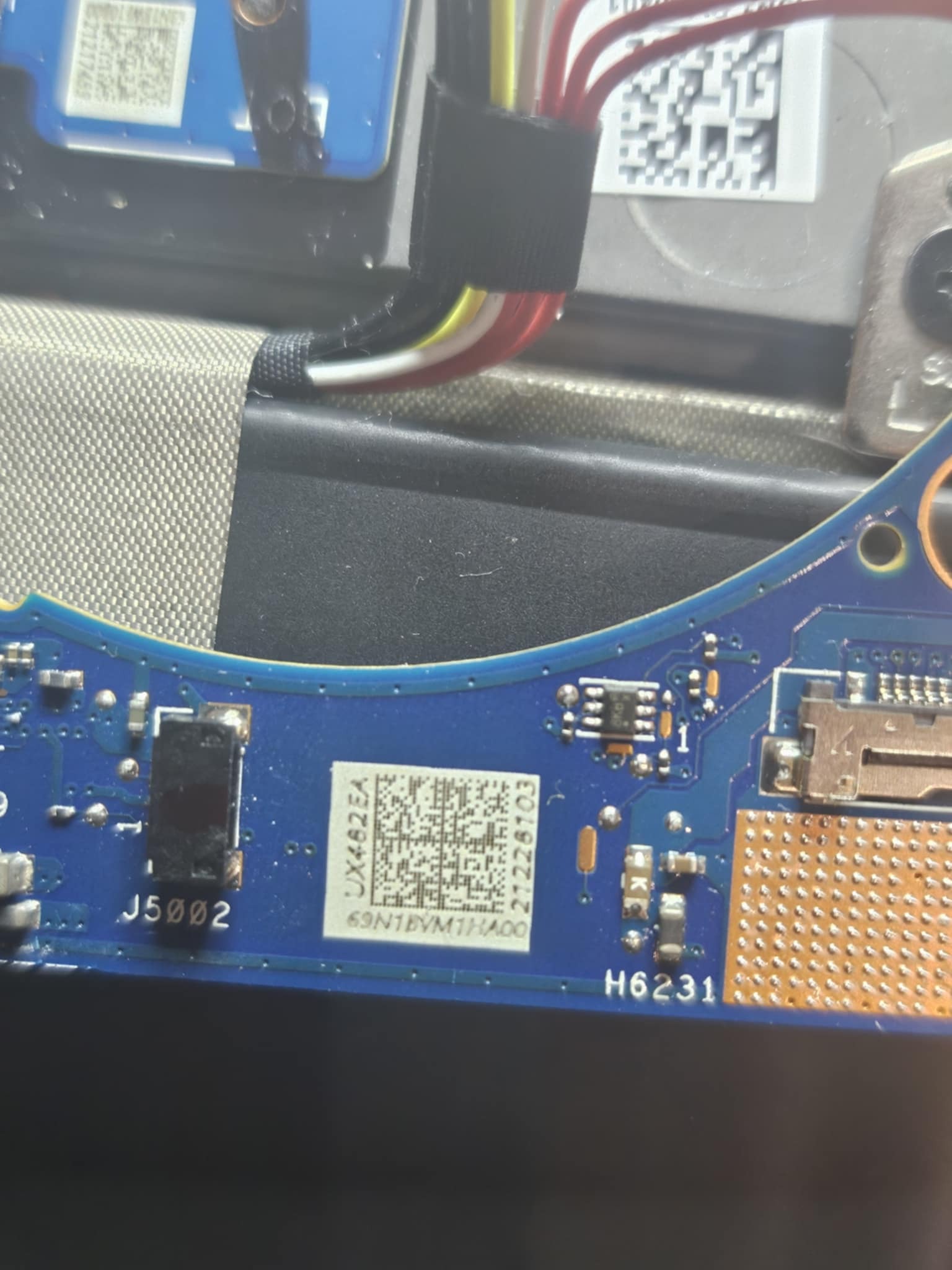

                                #56
                                Hello, sorry to disturb, i have change the chipset/cpu on a ux482 motherboard, but since cpu change, no ssd is detected, can someone help me for repair the bios ? here is the serial number : M7N0CV14R820288 a picture of the qr code on the board and the bios from the board. thanks a lot in advance

                                  #57
                                  try post #54...

                                    #58
                                    is the serial number of the board not important ? I go try anyway thanks

                                      #59
                                      BIOS backup is bad, read BIOS chip again if you haven't flashed # 54, random flipped bits, maybe you used a clip to read BIOS? If using clip check for SPI clock setting in your programmer software and change it to a lower value like 4MHz or less
                                      Otherwise find dnd replace all instances of your serial number with hex editor on # 54

                                        #60
                                        thanks for your help, i have download the bios on # 54 and change sn with hex editor, but the computer loop power on and off, just the power led, no screen
