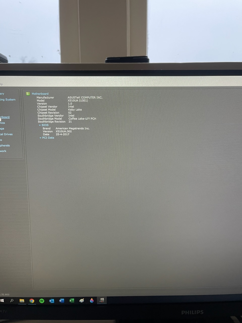

    I know there is somebody who can tell me what is happening with my laptop. For start, it is an asus vivobook s510ua with an asustek x510ua motherboard with an intel i5 7200u cpu and 16gb ram.. i have a screenshot from speccy before strange things started.. as you can see the laptop type and bios version x510ua.302.I don’t manually update the bios because i don’t like to having a bricked bios, i know what troubles that gives..

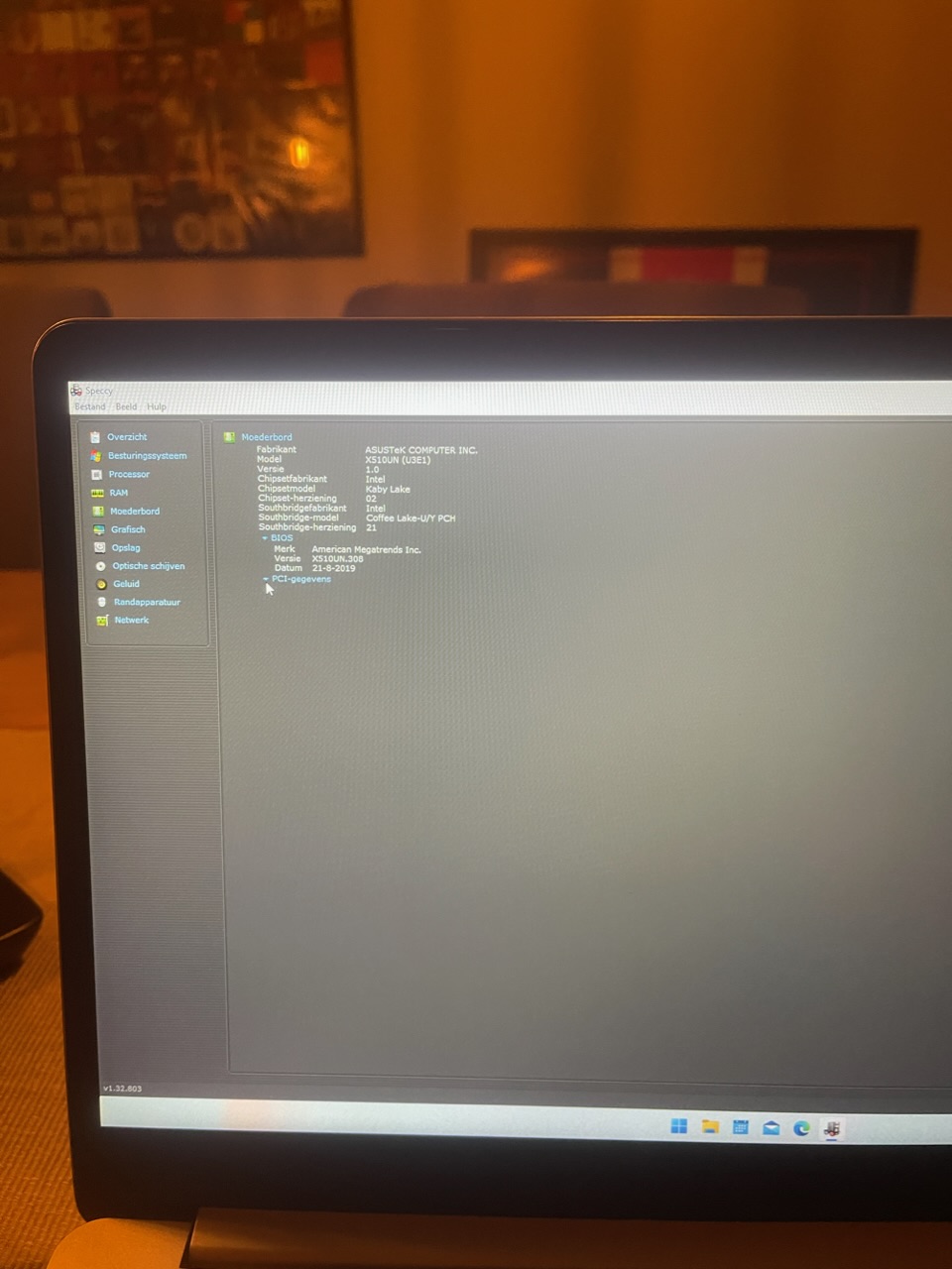

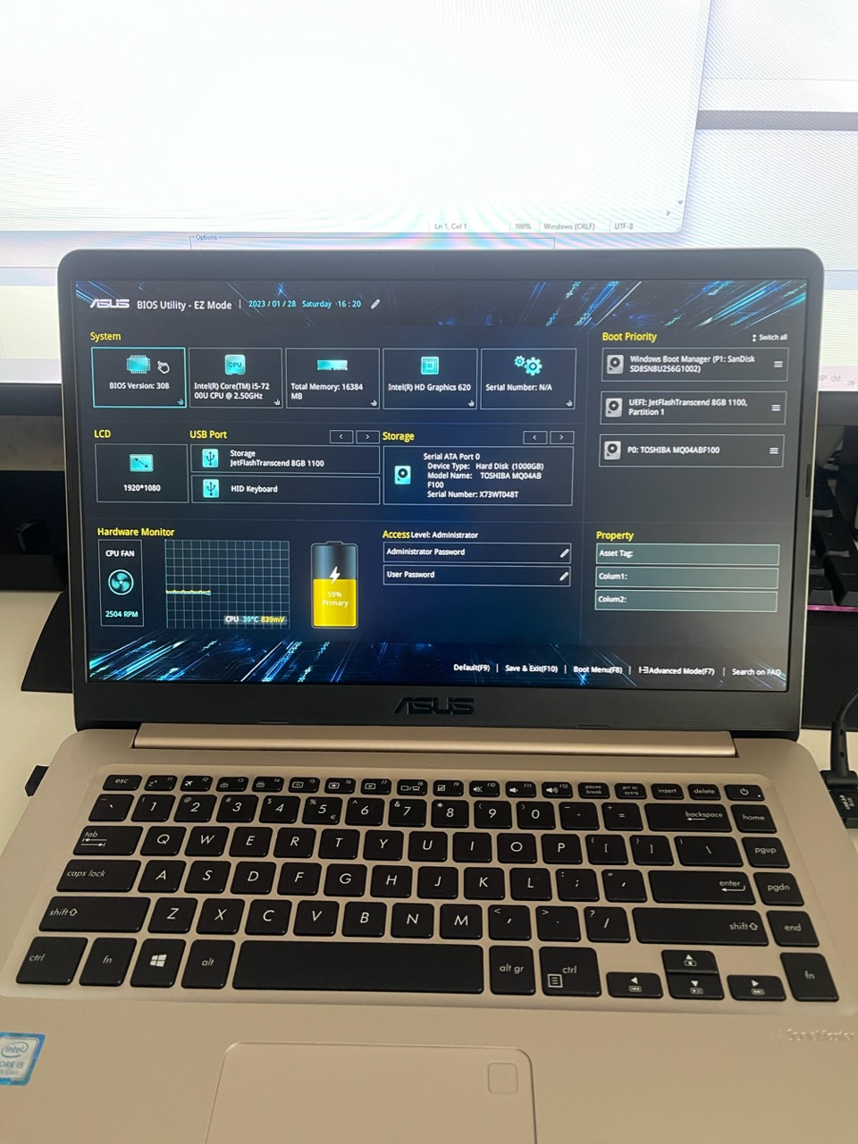

    Af that point i was happy, so i check everything, cpu temps etc, and looked good.. so i started a new win 11 install, all good.. but i noticed something.. in my bios , and also in speccy it says right now i have an x510un model, with the asus x510un.308 bios.. but that is a different type of this laptop.. not much , only different cpu i think. But still not the laptop i have, and also my mac adress and serial nr are empy in my bios.. I haven’t touched that part of the flashed bios file before rewriting it back to the chip..
    Do you guys think this is going to be a problem? Or just leave it like that and don’t do anything? Onlything not working now is my backlight keyboard, tried downloading new drivers, but i can live with that..
