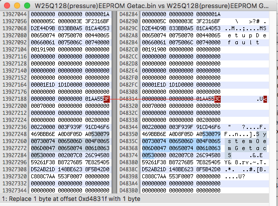

    I did used that function but it didnt work for the second one. I had to find the right entry thru UEFI Tool to mark right chain as inactive. Not everything is as obvious as you might think. In every bios the place you have to replace is different. Here is the computer nr 3. as you see one chain is now inactive.
    sure ... Is veeery hard to copy hex and use Find function in HxD to find what flag you have to modify ... long hours, indeed ...

      Originally posted by RicoPL
      After long hours I manage to remove the password.
      You need to change only one value depend on the bios.
      The real question is not where is 3C but why 3C
      you have to keep comparing to understand the comparison
      It is not so easy
      https://c9x.me/x86/html/file_module_x86_id_35.html
        It is maybe easy for you but it is not the case for a newbie like me. I was mislead by HEX value: Firmware performance. I was thinking it has to be changed after that and it didnt work so I have to use hours to find out solution. When you know what to look for then it is easy.

          Re: Getac S410 gen1 bios password removal
          It is not so easy
          That is correct. I appreciate the help. Thank You.

              Originally posted by bykanovm
              Help me remove the Getag S410 password. I wanted to figure it out and unlock it myself, but all the above files for comparison were deleted.
              Serial number RHA03S2858
              try. Compare original against modified and you'll figure out.
                  It seems I did this, but the password remained.
                  Thanks, I'll try it now​
                  Yes, I've already done this. The password remains. I compared your file with yours. They are identical.
                  I flashed your file. The password remains the same.
                  I have been looking into this issue for a long time. But I still can't understand why this method fails to remove the password.​
                  really? identical? what did you use to compare "your file with yours"? try again ...
