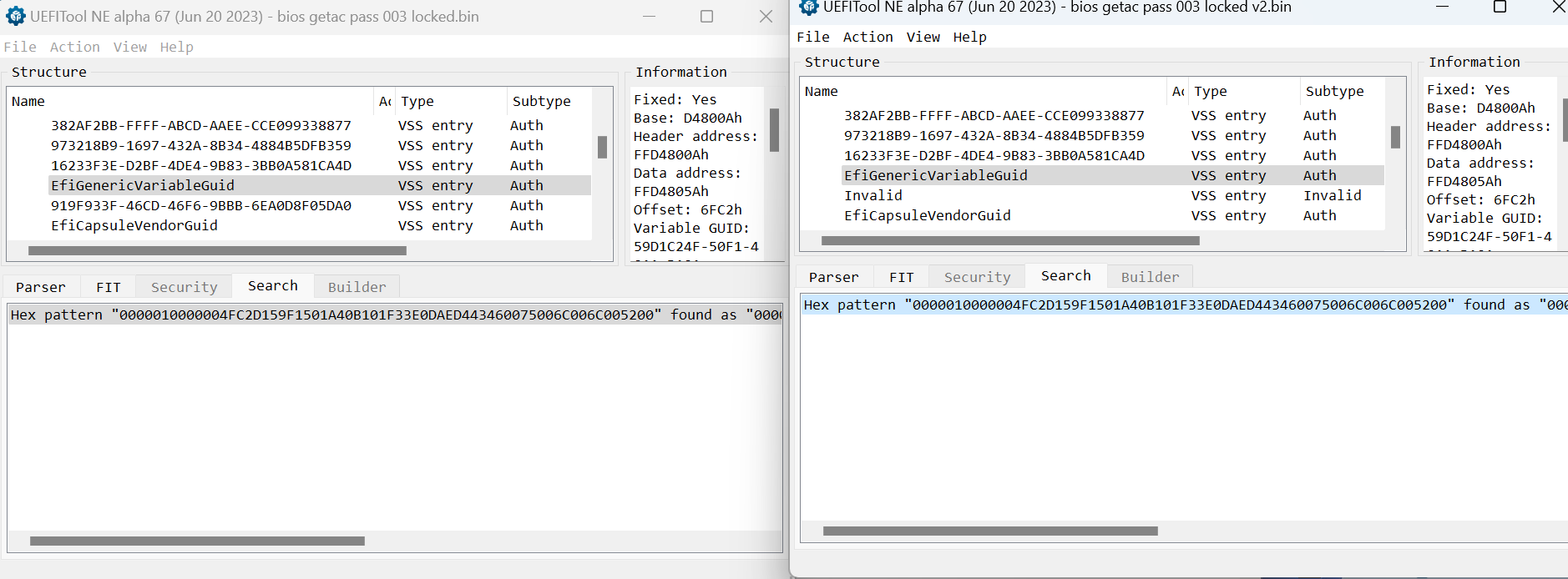

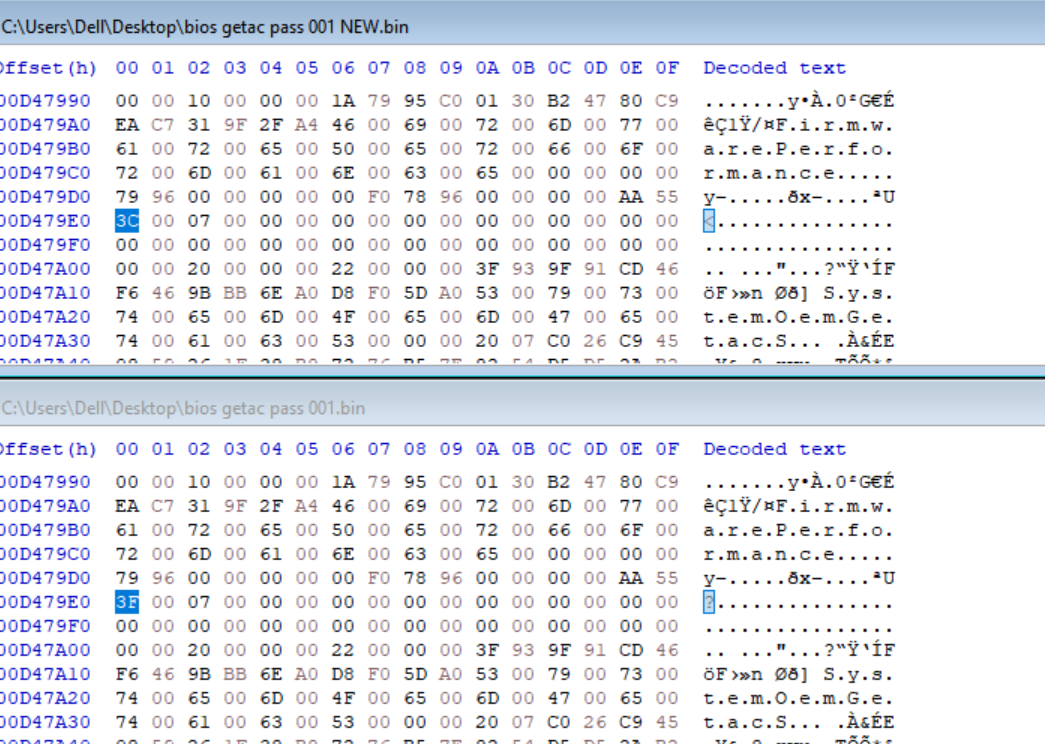

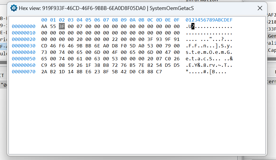

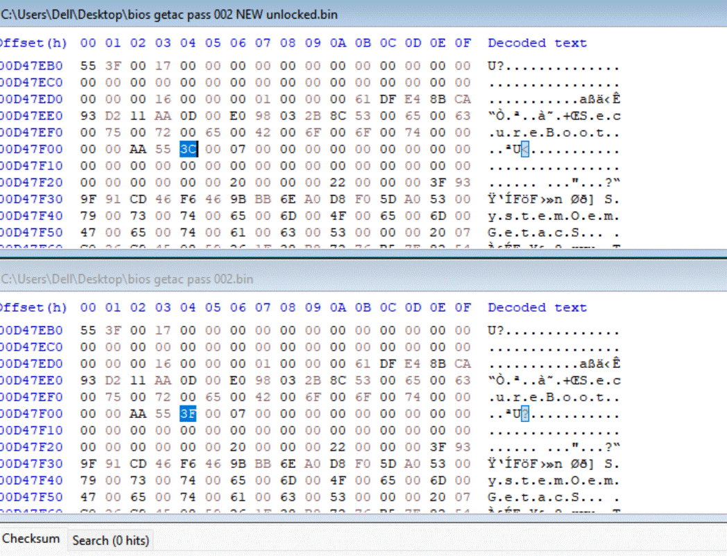

                                After long hours I manage to remove the password.
                                See photos attached.
                                You need to change only one value depend on the bios.
                                2 photos and 2 different bioses showed where to change the value.

                                  yep, you reinvented the wheel invented by Vesko356 Say "thank you" to him.

                                      and yet you didn't discover "compare" function to hex editor until "after long hours"... that says something about you, you are the type wanting drawings to explain pictures instead thinkin' a little bit ... and thinking is for free!

                                        I did used that function but it didnt work for the second one. I had to find the right entry thru UEFI Tool to mark right chain as inactive. Not everything is as obvious as you might think. In every bios the place you have to replace is different. Here is the computer nr 3. as you see one chain is now inactive.
