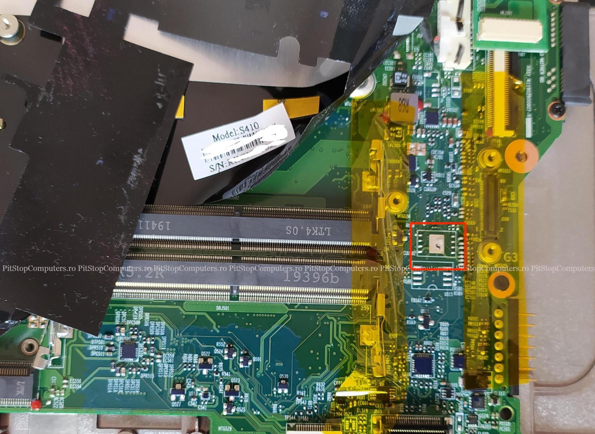

                • volinakis
                  • Jan 2021
                  • 2734
                  • N/A
                  Re: GETAC S410 G4 Bios password
                  Originally posted by bulletin
                  Is there a second chip???? A Winbond too??
                  this is from a S410 G3, check on near the RAM slots

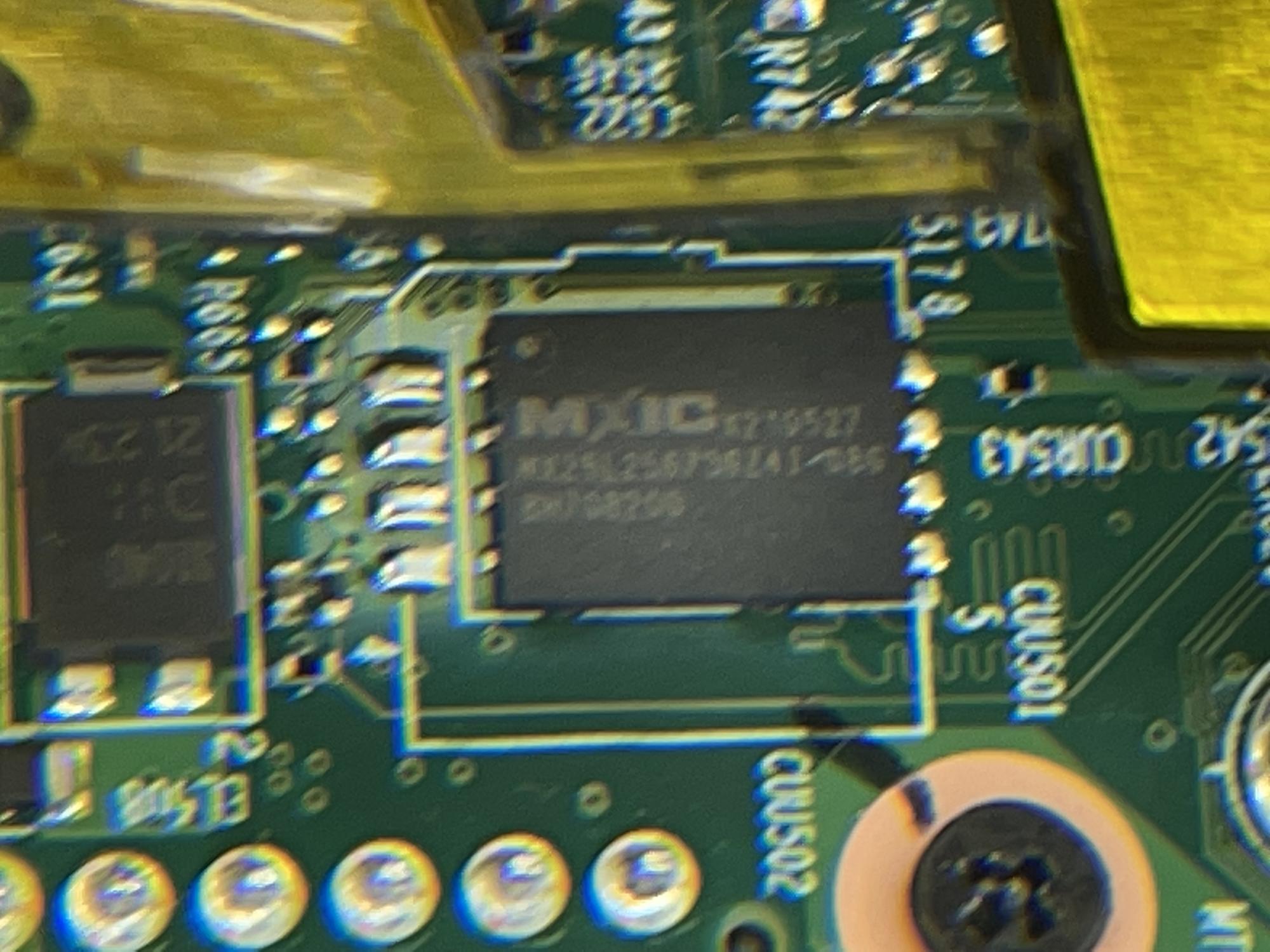

                  • bulletin
                    • Jan 2023
                    • 16
                    is it that one?
                    • hardware1
                      • Sep 2021
                      • 2931
                      • N/A
                      is it that one?
                      Yes, it's a 32MB chip.
