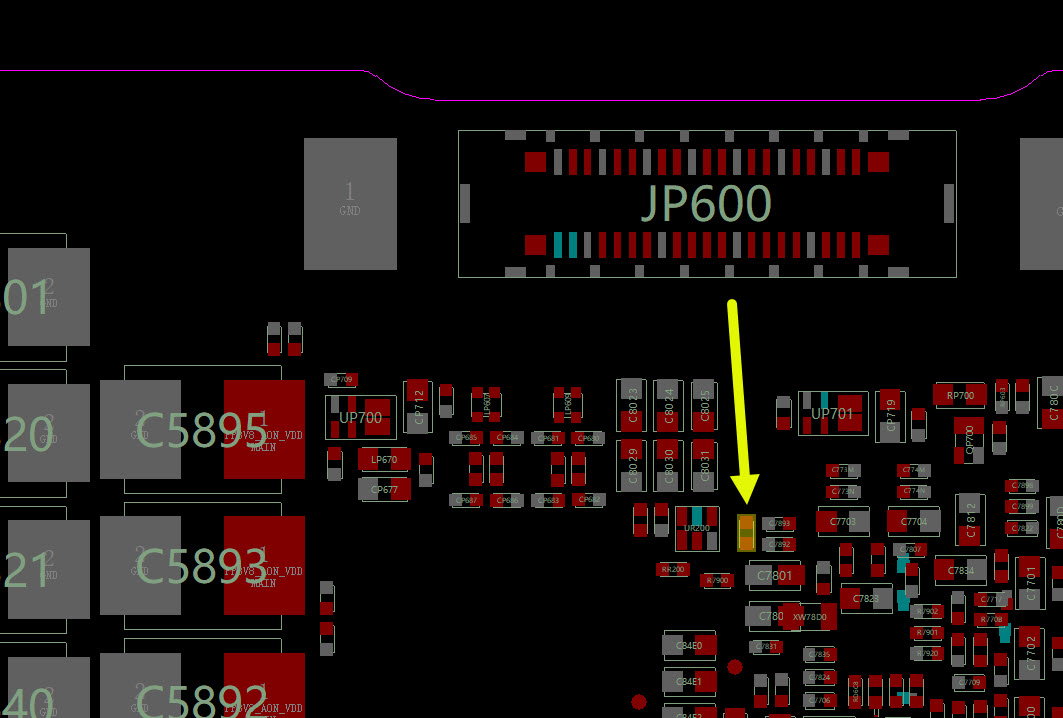

    Re: Macbook A2337 820-02016 Backlight Issue
    Hall sensor issue maybe? Check for corrosion and continuity around that area, and make sure the hall sensor is working as it should by bringing a magnet close to the sensor

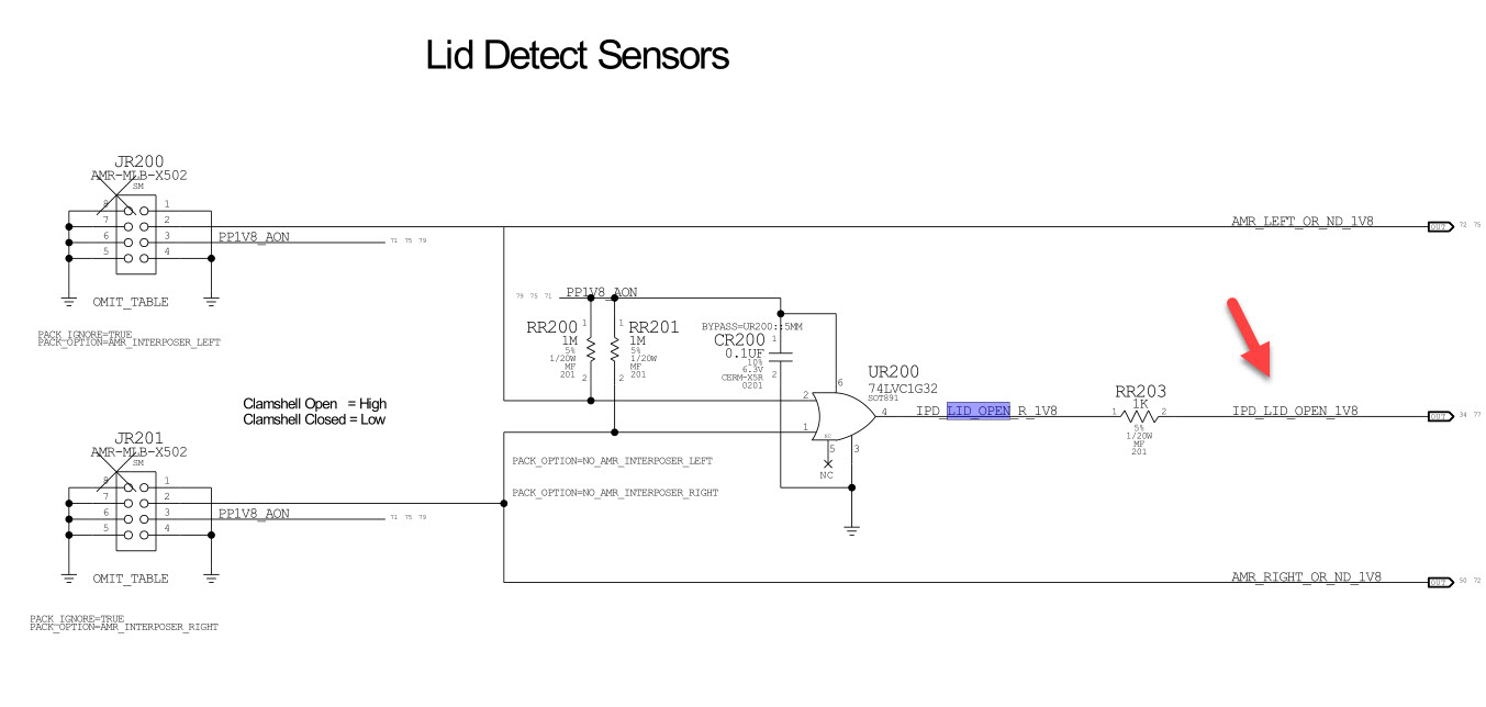

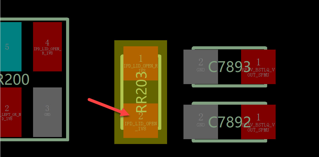

            Locate RR203 and review the voltage of this signal, RR203 (pin # 2) IPD_LID_OPEN_1V8.
            What is the voltage with the LID OPEN ? with LID CLOSED ?
            I believe that the LID sensors are commonly in the trackpad.
            On the display, with extreme care, measure the voltages for the power rails used for the LCD & camera.
            Post each measurement.

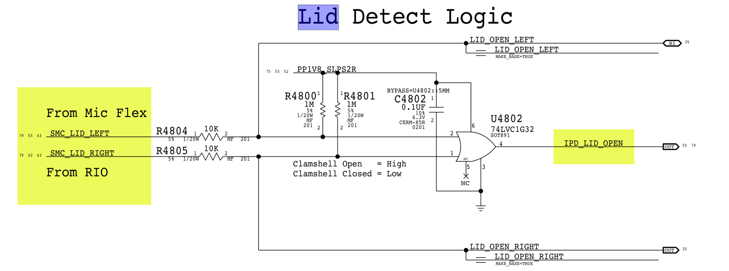

                  Re: Macbook A1932 Intermittent Backlight Issue 820-01521
                  See attached.
                  Check your trackpad. Remove it for testing. See if that allows for your display to function.
                  Check the voltage of IPD_LID_OPEN.
                          Originally posted by mon2
                          See attached.
                          After removing the trackpad it run well for 1 day and then again started giving problem. This is what happens everytime when we do something, remove a flex etc. it runs well for 1 day.
                          Voltage of IPD_LID_OPEN checked a C6712 Point 1 is 1.8v.
                          Please help further. Should we put in a replacement trackpad and check?

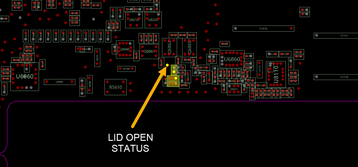

                                  • mon2
                                    • Dec 2019
                                    • 14664
                                    Check if this same signal is available on the logic board side that is visible so you can measure it.
                                      IPL_LID_OPEN isn't available on the visible side when everything is connected.

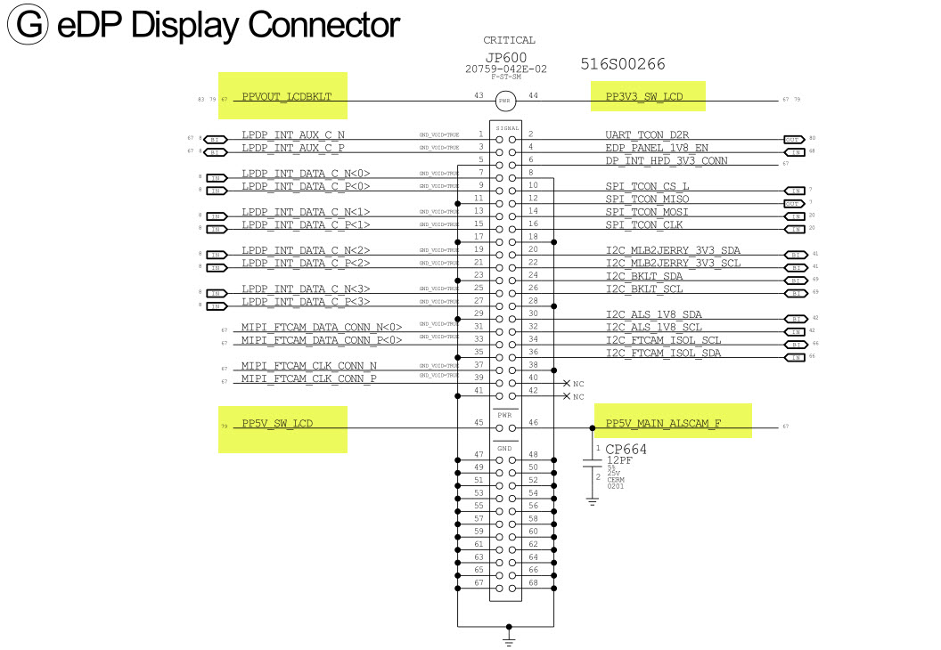

                                      • mon2
                                        • Dec 2019
                                        • 14664
                                        Are you able to probe the pads @ J6700 connector ?
                                        The J6700 connector also contains the signals of interest.
