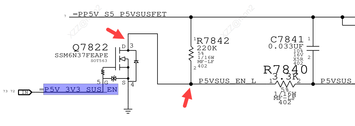

                            The mosfet @ Q7820 is SIA427DJ and is a P-channel type. So the gate voltage must be lower than the voltage that is being passed between the source / drain pins to enable.
                            What is the voltage to ground of P5V_3V3_SUS_EN? Measure @ Q7822 (gate pin).
                            • pcbmaniac
                              • May 2014
                              • 81
                              • Greece
                              At Q7822 the gate pin P5V_3V3_SUS_EN​ is 3.3V
                              • mon2
                                • Dec 2019
                                • 14509
                                Good. Then this mosfet should be enabled and forcing the resistor @ R7840 to be LOW. That is, when this mosfet enables, the one leg of R7840 will be shorted to ground. Since the pull-up resistor (R7842) is of a much higher resistance @ 220k ohms vs. 3k3 (R7840), the high resistance resistor will lose this battle and allow for this logic low to travel onto the gate of Q7840. However, this is not the case.
                                So, there may be a damaged trace from the mosfet @ Q7822 (drain pin 3) to the resistor leg @ R7840 OR Q7822 OR R7840 is defective.
                                With no power to the board, meter in resistance or diode mode -> touch one meter probe to drain pin mosfet Q7822; other probe pin to R7840. In diode mode, you should hear a tone beep. In resistance mode, the resistance measurement should be ~0 ohms. Confirm this important detail. If yes, measure the resistance of R7840. This resistance must be ~3k3 ohms. If not close to this value, the resistor could be defective.
                                Finally, if the above values are ok, flux and replace Q7822 which is most likely defective it you do not observe a low or 0 volts on the gate of Q7840.
                                Click image for larger version  Name:	mosfet.png Views:	0 Size:	67.0 KB ID:	3533741

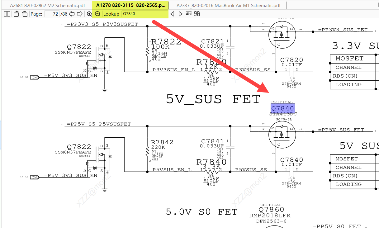

                                  Since i use schematic PDF 820-3115, the part numbers and some values are different but the principal is the same. For now i must go to sleep. We can continue tomorrow at noon. Thank you for your help.
                                  • mon2
                                    • Dec 2019
                                    • 14509
                                    Yes, do review but my schematic is supposed to be also 820-3115. Post this section of the schematic tomorrow to continue. There is a fault in this region based on the shared measurements.
                                    Update - I see my error - there are 2 mosfets inside of Q7822. Each gate of these mosfets is linked to the same drive signal. Trace your board for the NORTH half of the schematic shared below. There is a fault in this region.
                                    Q7820 is not enabled because the mosfet (1/2) that is linked to R7820 is not low. This implies that Q7822 is defective OR there is a trace break to R7820. Once Q7822 enables, the gate of Q7820 must be low. Since the gate of Q7820 is at 3v3, the resistor @R7820 is ok.
                                    Also review the resistance across Q7820 to rule this part as being defective.
                                    Measure the resistance of:
                                    source / drain
                                    source / gate
                                    gate / drain
                                    Each should be hundreds of k ohms or higher. If not, then this mosfet could be leaky.
                                    Click image for larger version  Name:	A1278.png Views:	0 Size:	180.3 KB ID:	3533754

                                      I did measures and find that PM_SUS_EN is missing. Since i dont have a replacement chip U7940, i put the missing resistor 0 ohms R7917 and now i do have both PP5V_SUS = 5V and PP3V3_SUS =3.3V. Then i noticed that signal S5_PWRGD is 0V. What to do next?
