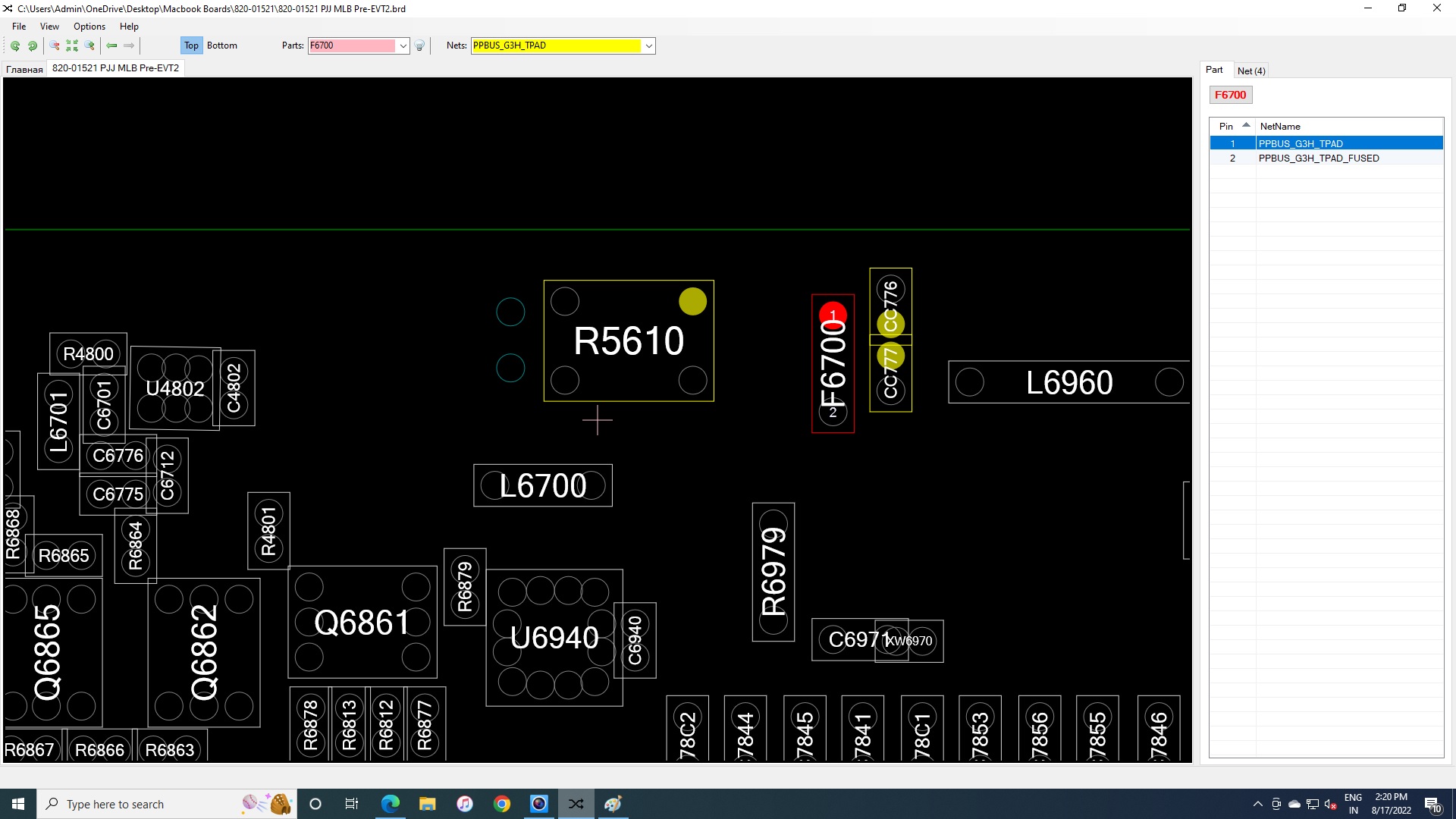

    FINAL UPDATE.
    Replaced the Fuse F6700 yesterday and the trackpad started giving very light haptic feedback. Today morning it is giving proper haptic feedback but the backlight issue is back again.
    Removed the Fuse F6700.
    Voltage at Pin 1 is 12.6V and Resistance to Ground at Pin 1 is 470.
    After Removing the Fuse, the Backlight Issue is fine but the Haptic is Gone Again.

      Re: Macbook A1932 Intermittent Backlight Issue 820-01521
      FINALLY
      We ahead and replaced the R5610 and L6700 both connected to the Fuse F6700. See Attached
      Now there is no Intermittent Backlight issue or Trackpad Haptic Issue. Will keep it under observation for 1 more day and let you know.
      Would like to thank BADCAPS FORUM and Mon2 for prompt responses and guidance.

        #43
        Originally posted by mon2
        Are you able to probe the pads @ J6700 connector ?
        The J6700 connector also contains the signals of interest.
        We ran a jumper wire from C6712 and the screen is giving issue.
        When there is No Image, the Voltage still remains 1.8V.
        Removing F6700 solves the Backlight issue but the Trackpad Haptic Starts giving problem.
        Current Status of the Board -
        Replaced F6700,L6700 and R5610.
        I am in a total fix. Please help.

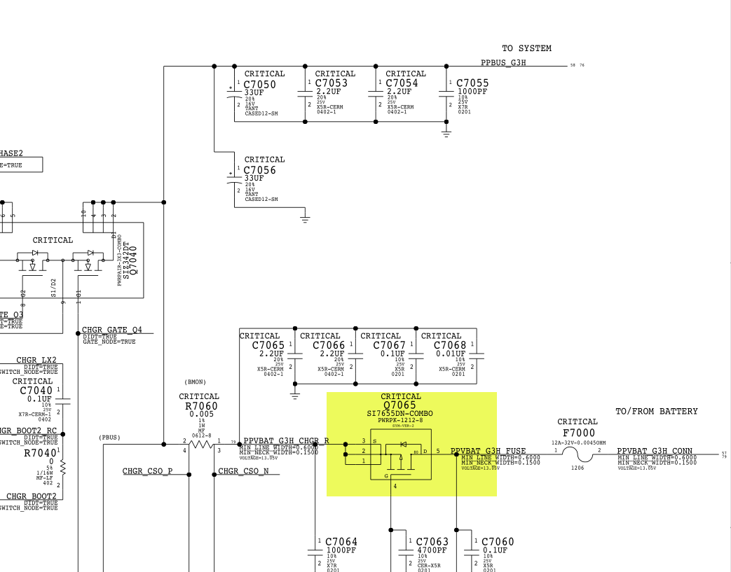

                        #51
                        That is not normal. You likely have a leaky mosfet.
                        Remove all power. Meter in resistance mode.
                        Check the resistance of the battery mosfet @ Q7065:
                        source (1-2-3) & drain (5-6-7-8)
                        source (1-2-3) & gate (4)
                        gate (4) & drain (5-6-7-8)
                        Post the resistance values & the scale used on your meter for these measurements.
                        As a quick test - remove Q7065 off the logic board -> then see if the logic board will power up normally without this mosfet using only the external power adapter.

                                  • mon2
                                    • Dec 2019
                                    • 14794
                                    #57
                                    Check the removed mosfet with a resistance check:
                                    Just to confirm there is no fault with this mosfet.
                                    Then, place back this removed mosfet.
                                    Does this battery charge if left on ?
                                    As per @Piernov's comments, test with a known good battery.
