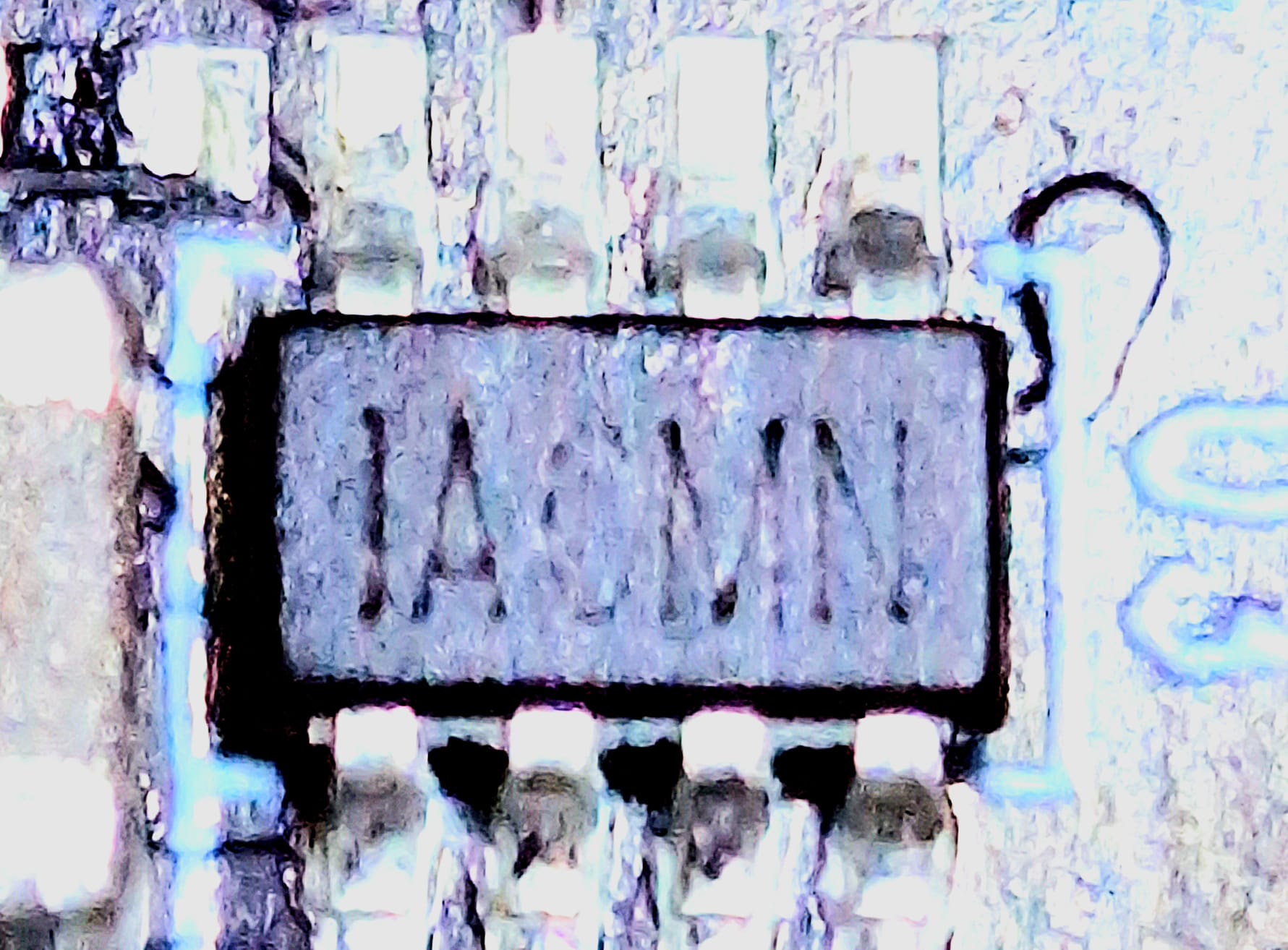

            Re: IC Marking Codes and Datasheets #2
            I've found a SOT23-6 with marking |AZEM that looks like MPS made, but it's not in your list. Any idea?
            It's in the secondary side of a Chicony USB-C laptop charger (A18-045N1A).
              • 21444
              #66
              It could be MP6908 / MP6908GJ-Z .Here`s a datasheet https://cdn.badcaps-static.com/pdfs/...ec0f4ff6e6.pdf

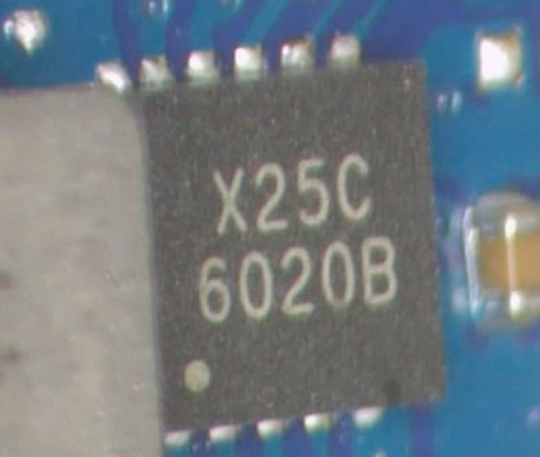

                #67
                Hello
                Could you help me with this one?
                X25C
                6020B
                I think it should be a RAM IC.
                Mod Edit: Link to Boardview -> https://www.badcaps.net/forum/showthread.php?p=1260575
                • orientalsniper
                  • Apr 2013
                  • 461
                  #68
                  Originally posted by javieromex
                  Hello
                  X25C
                  6020B
                  G6020MC1D G6020AMC1D G6020BMC1D 6020 6020A 6020B
                  https://www.aliexpress.us/item/3256805638222886.html

                        #71
                        Originally posted by mon2
                        MPS # MP1471AGJ-Z
                        Wrong, because picture shows a SOT23-8, and this one is a SOT23-6. Also, top marking in picture is ACM and this one is AGM.
                        Then, it's a MPS MP3414DJ.

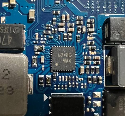

                                      #78
                                      Richtek G2=
                                      RT3652EBGQW
