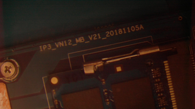

                Re: IC Marking Codes and Datasheets #2
                Hello friends, I can't identify this component that seems to be from MPS.
                DDJ 213 without screen printing on a motherboard model: IP3_VN12_MB_V21_20181105A
                  Post more details of other markings from your logic board.
                  What brand ? Model ? You will have other silk screens on the board. Perhaps a schematic is floating for your unit.
                  • py2eb
                    • Mar 2022
                    • 14
                    • Brasil
                    #29
                    Notebook manufacturer: Feed Me
                    Model: Laptop-S17
                    Board: IP3_VN12_MB_V21_20181105A
                          Monolithicpower MP2015AGG https://www.monolithicpower.com/en/d...n/sku/MP2015A/
                          • py2eb
                            • Mar 2022
                            • 14
                            • Brasil
                            #33
                            Thank you very much

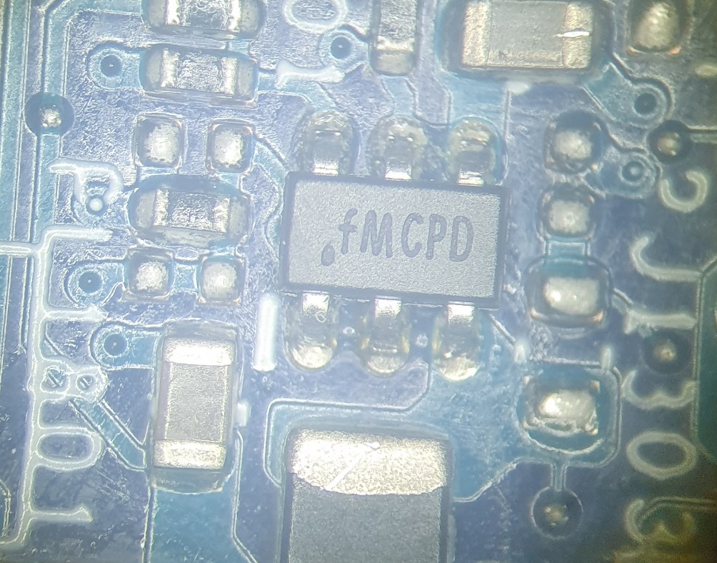

                              #34
                              Hello, help me to identify component.
                              Marking: fMCPD
                              Motherboard: LA-K201P
                              Thank you in advance.

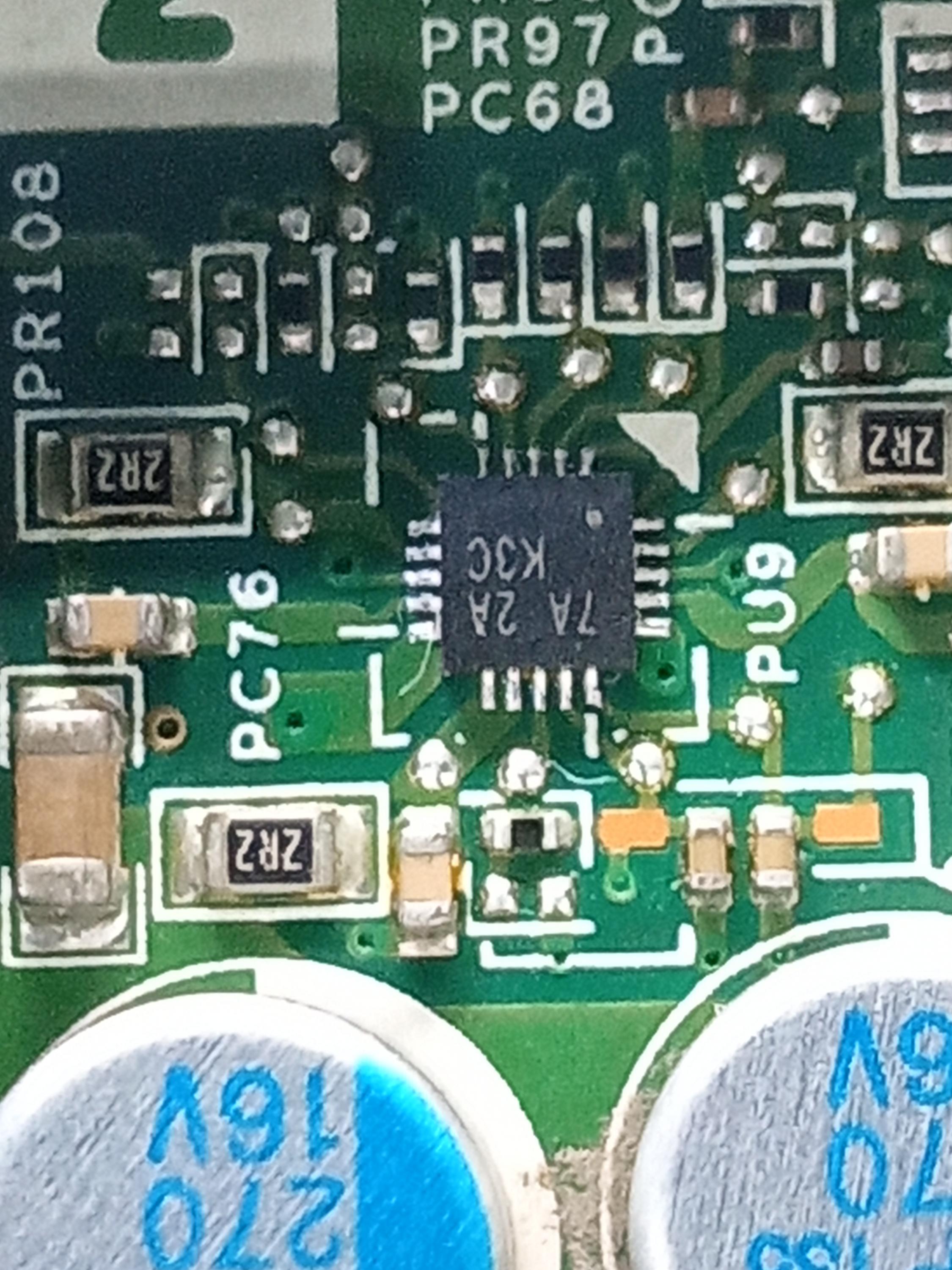

                                          #40
                                          Can anyone help me find the real name of this component?
                                          DELL MIH81R TIGRIS MT MB 12124-2 (OptiPlex 3020 )
                                          7A 2A
                                          K3C
                                          https://www.badcaps.net/forum/attach...1&d=1664725985
