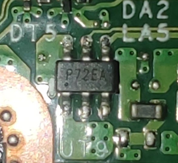

      Hi guys, could someone help me identify this P72EA chip?
      It comes from an Acer Aspire Vero
      motherboard = HH4A4 LA-M213P
      The boardview name is UT9 and i think is a buck converter but im not sure
        Maybe that will help you a bit https://www.badcaps.net/forum/docume...v1-0-boardview

          Originally posted by AlexWhat
          I already have the boardview but there is no serial number or any additional info on the ic, thanks for sharing nonetheless
            Based on the LA-M211P board schematic, this UT9 is a SY6861B1ABC_SOT23 or G518B1TP1U_TSOT23-6 (Load Switch).
              Thank you

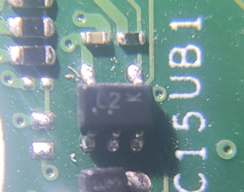

                    Help finding this ic L2 k
                      Passible that this is it NL17SZ08DFT2G

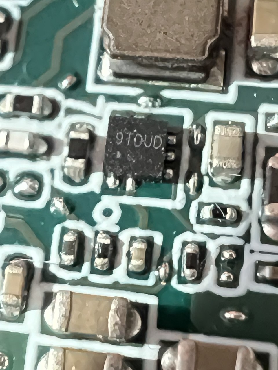

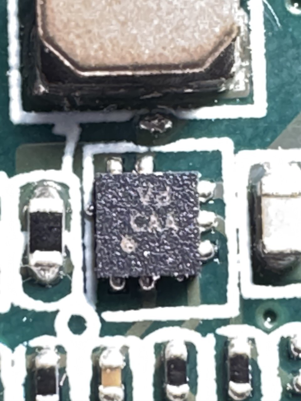

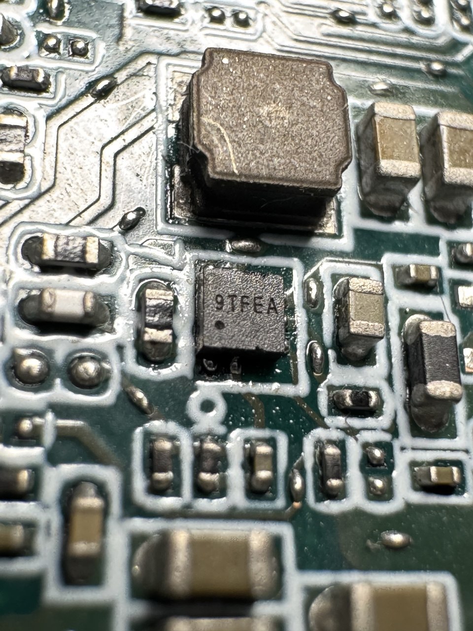

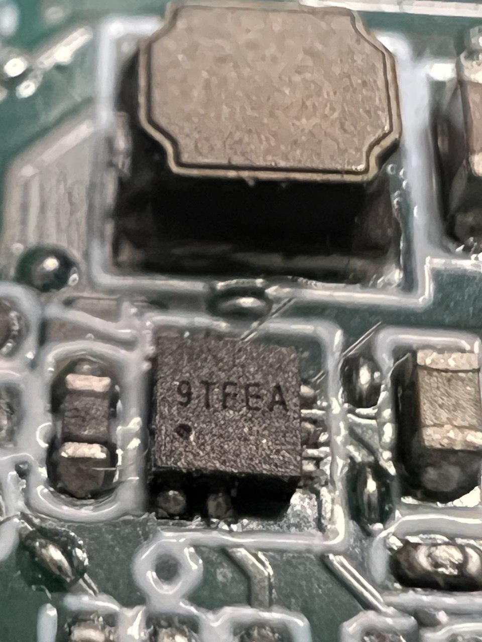

                        #211
                        Help identify) All of these are theoretically the same, LDO 1.8v on Intel NUC 10-11. I assumed it was SY8843QWC, but it doesn't work
