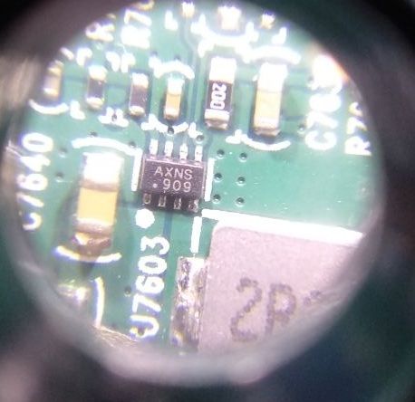

                  #188
                  Hello, please help me identify the component.
                  Marked: AXNS
                  manufacturer: perhaps alpha & omega semiconductor
                  Monitor MSI MPG 321UP, interface board: 715ge652-moc-000-0h5f

                      #190
                      Marked: AXNS
                      MP2393
                      https://www.monolithicpower.com/en/d...ku/MP2393GTL-Z
                      • sergei66666
                        • Mar 2022
                        • 22
                        • Russia
                        #191
                        Thank you, you are my savior)

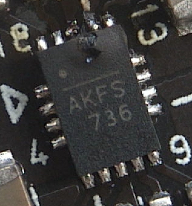

                          #192
                          AKF* = MP5092GD-Z
                          FairRepair on YouTube

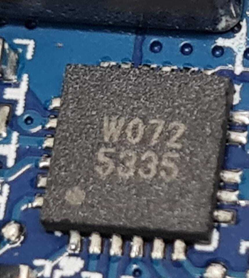

                            #193
                            Hi ya folks,
                            I have a NEC laptop with a burning chip which is supplying power to CPU.
                            Thankfully CPU is not burned.
                            I just gotta replace this chip.
                            Unfortunately i don't know the name of the chip.
                            Markings are
                            1st line W072
                            2nd line 5335
                            I know the maker is GMT Global Mixed-Mode Technology.
                            But i cant find out the chip name.
                            Any help is appreciated.
Name:	WhatsApp Image 2025-09-09 at 12.59.10.jpg
                            • mon2
                              • Dec 2019
                              • 14996
                              #194
                              GMT5335
                              G5335
                              https://gmt.com.tw/product/datasheet/EDS-5335.pdf
                              I just found this on AliExpress: US $3.52 | (5piece)100% New G5335QT1U G5335 5335 QFN-23 Chipset
                              https://a.aliexpress.com/_oEv9sex
                              • Loki_Fido
                                • Mar 2025
                                • 138
                                • Japan
                                #195
