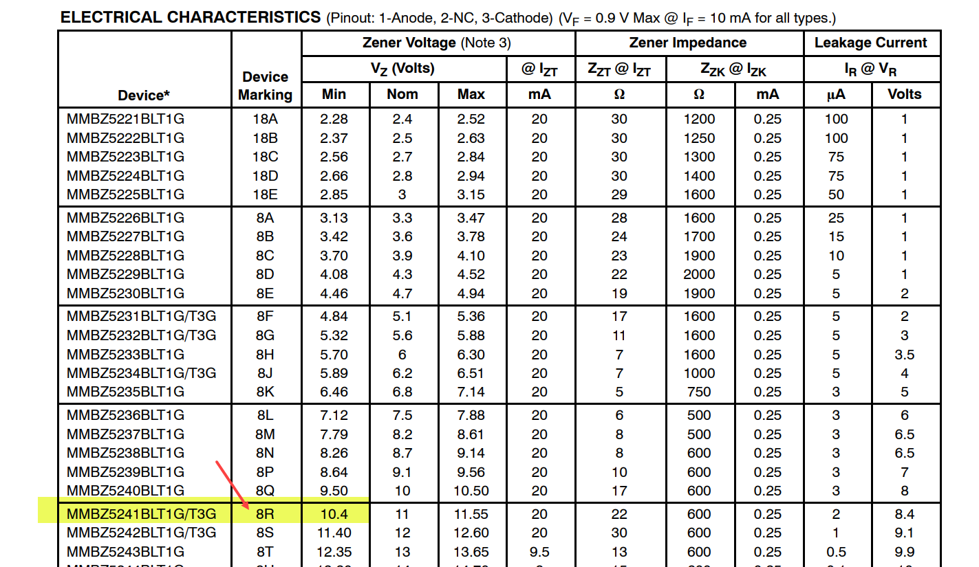

    Hey Everyone Anyone Can Marking This IC?
    8R> IN JBL PartyBox 300

      Originally posted by abouterfan
      Hey Everyone, Sorry Anyone Can Help me to find this ic chip? on jbl partybox 300
      sorry its on JBL PRX525 Board

        To me, this appears to be from ONSEMI.
        ONSEMI part # MSB1218A--RT1G
        MSB1218A_RT1 - PNP Silicon General Purpose Amplifier Transistor (onsemi.com)
          I beg to differ!
          That D2... reference suggests it's a diode. Also, that body proportions suggests a SOT-23, not a SOT-323. Also, leg 2 seems connected to nothing. It could be bridged to leg 3, but I don't think so. I don't even read BR, but 8R. So, my bet is MMBZ5241B, a 11V zener from Fairchild/ON semi. (1) Anode, (2) not connected, (3) Cathode.

            Thanks. To the OP - pour alcohol onto the top surface to clarify if the first marking is an '8' or a 'B'. Appears to be a 'B' to me. If 'B' then my guess stands. If '8' then agree with the correction - both are from ONSEMI.
            Also confirm if the lower right leg is connected to anything else. If floating then 100% it is a zener diode.
            MMBZ5221BLT1 - Zener Voltage Regulators (onsemi.com)

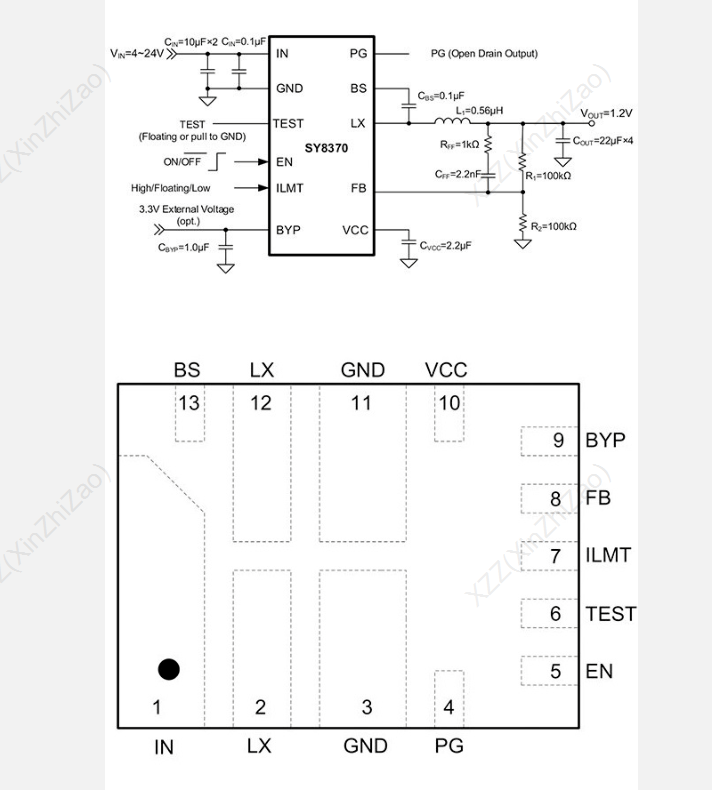

                                    Hello, looking for pinout of SY8371B Marking DFAXXX, DFA, DFADMB. Thanks!

                                      SY8371BTMC-产品中心-矽力杰 (silergy.com)
                                      I found only SY8370 but it may be close. Which board uses the SY8371B?
                                      Click image for larger version  Name:	SY8370.png Views:	0 Size:	171.7 KB ID:	3340440

                                        Thanks, mon2, its present on Asus B1400CEPEY.

                                          See the first link - the webpage has the details you are requesting. For now, unable to download the full datasheet from their website but the landing page has the pinout.
