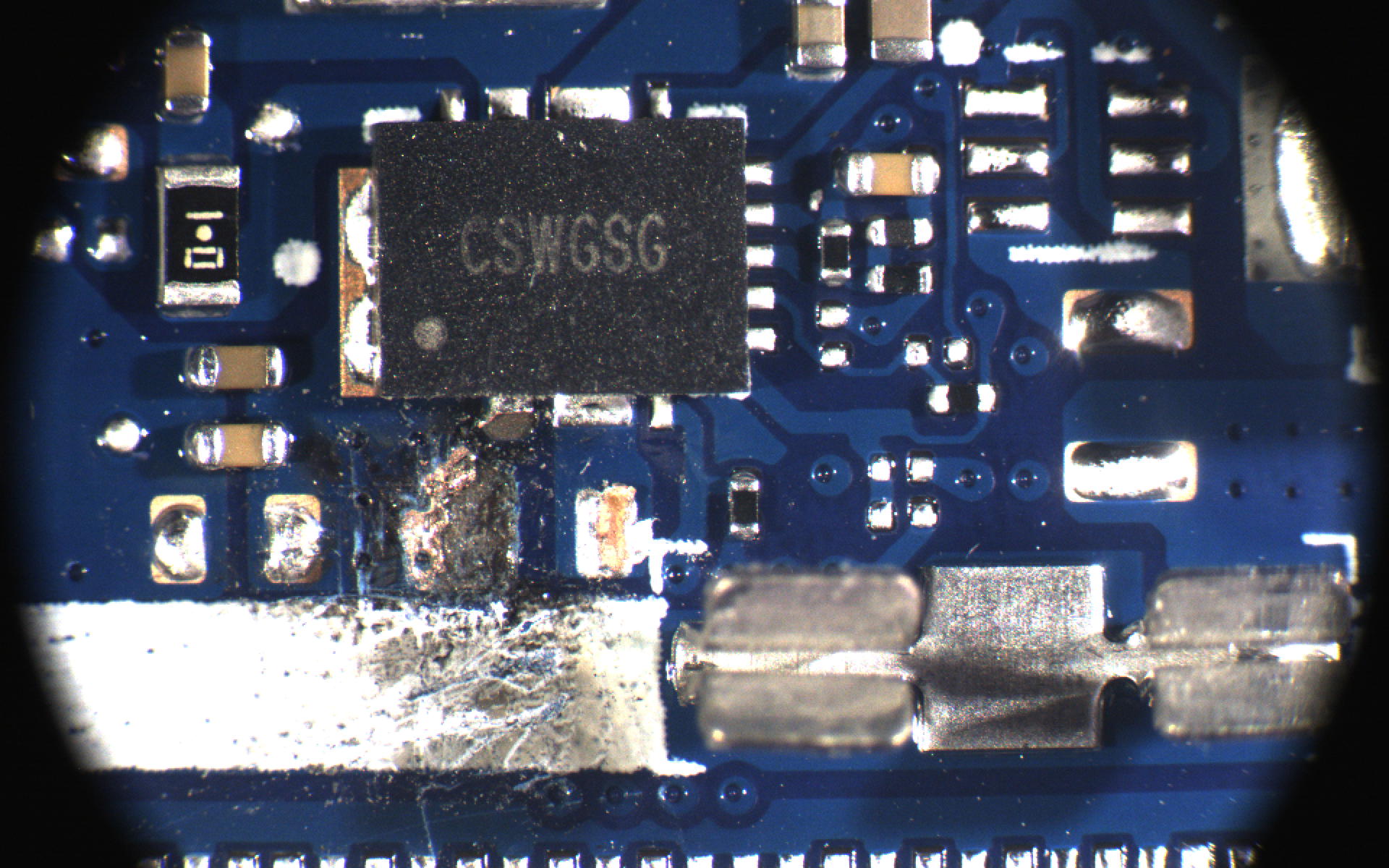

    HP Pro Book 460 G11 Board DA0X8VMB8G1 REV:G Slow Clap for HP Bad ram shield to component spacing.
    Had someone drop off a laptop in which they were upgrading the ram but forgot to unplug the battery.
    Looks like the ram RFI shield shorted a rail going to or coming from a Silergy IC which blasted a component off the board. I'm going to assume it was a cap but really have no way to know for sure since this board schematic doesn't appear to be in the wild yet.
    I'm trying to identify the IC model now but it doesn't appear to match any of the Silergy codes from https://www.badcaps.net/forum/troubl...and-datasheets
    I'll report back if I find it, if anybody has any idea if it's a cap and the value range that info would be greatly appreciated!
    Thanks.

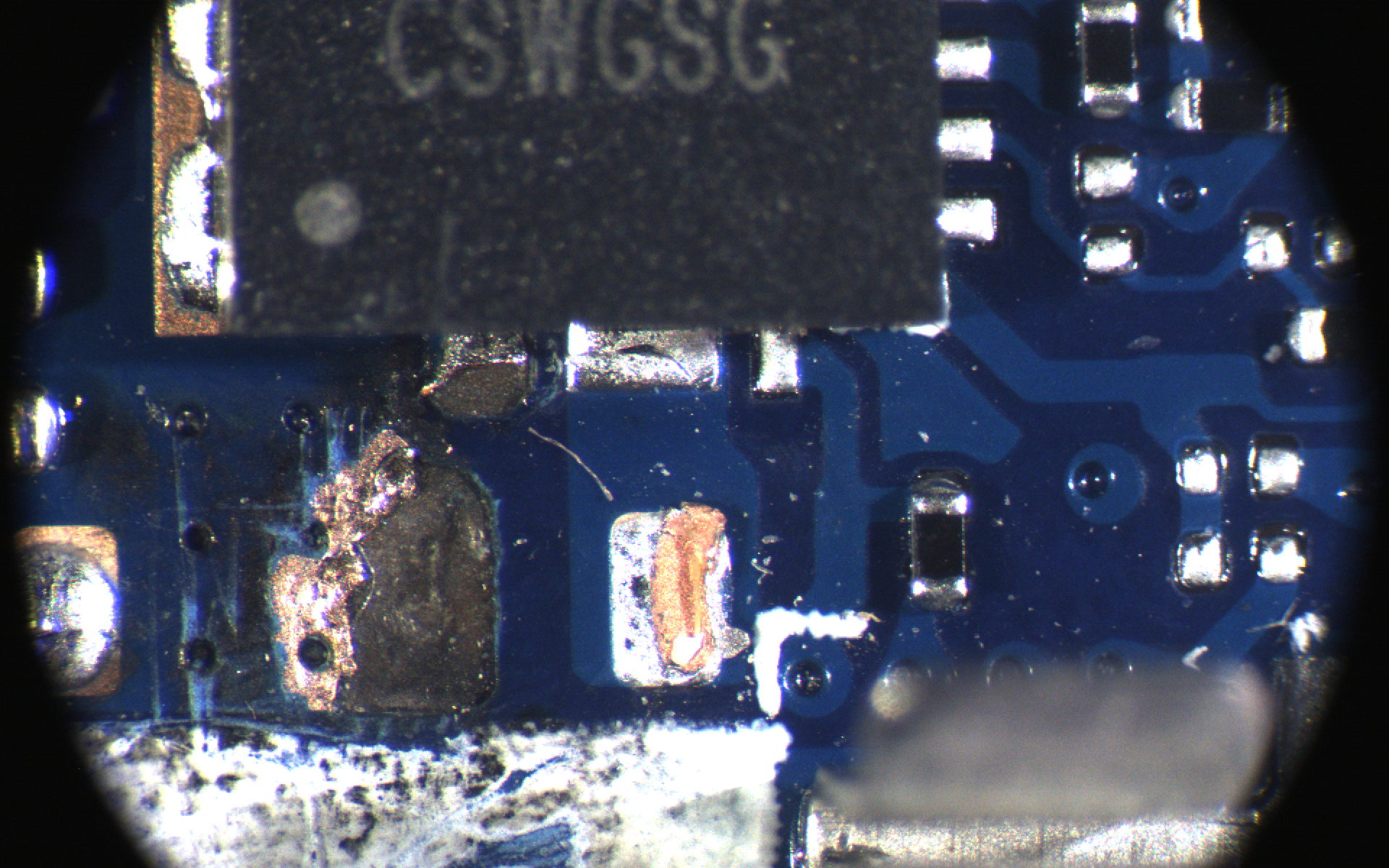

    Close up of the cleaned area

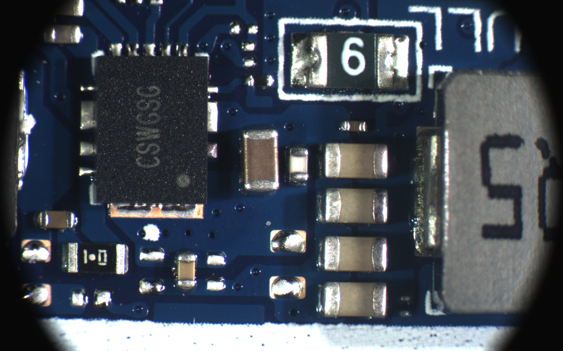

      I tried extracting and measuring the capacitor on a sister chip and saw something weird like 10miliF before I lost it launching it across the room. Trying to figure out exactly what this chips role is so I can look at recommended circuit layouts.

        https://www.silergy.com/productsview/SY20372QLQ
        This so far is the closest I've found to the same pin layout on Silergy's web site
        • abajor
          • 178
          Anybody know where I can source this part?
