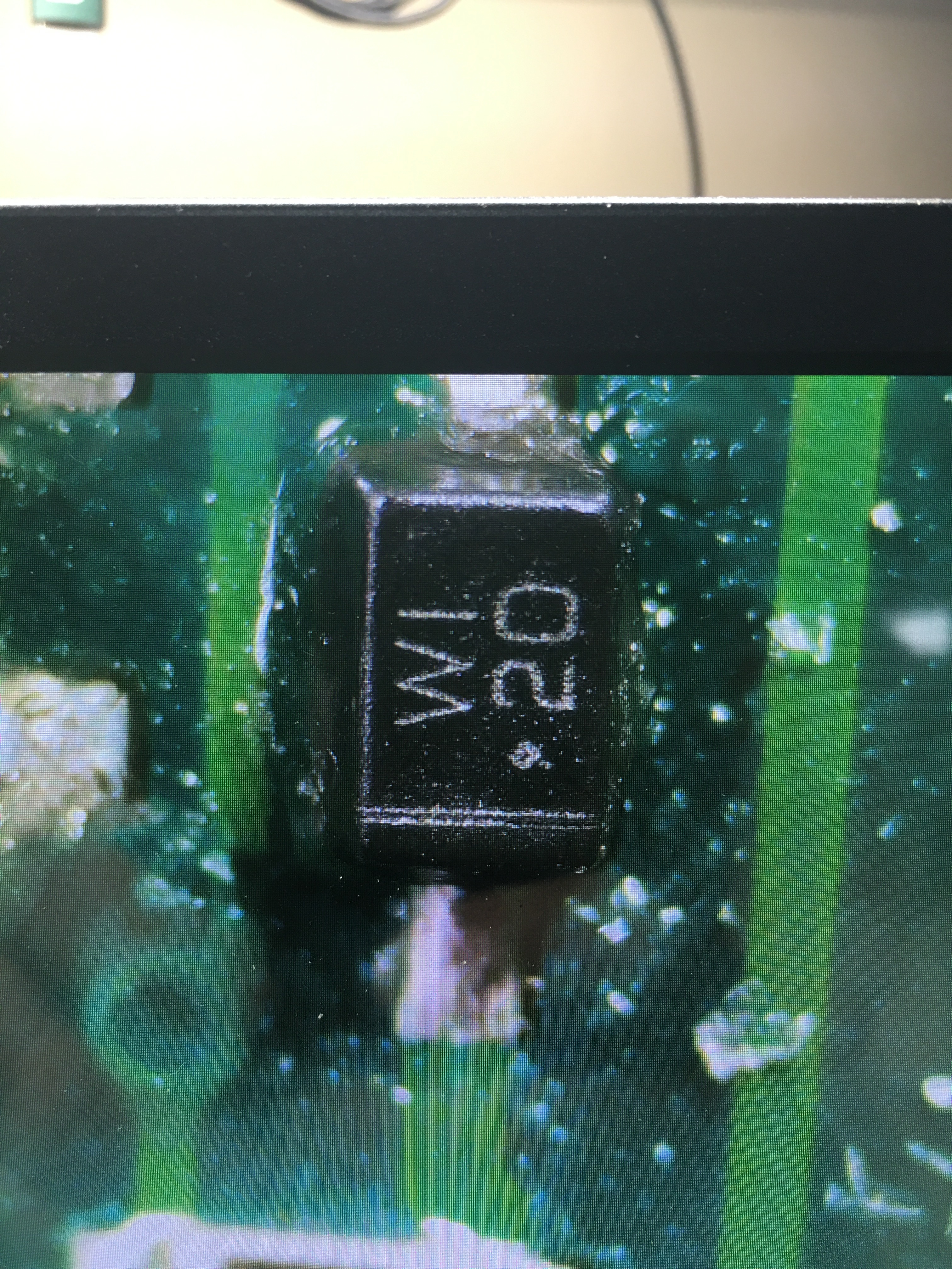

    Hello folks, I seem to have a lot of trouble when it comes to distinguishing markings on SMD components especially when it comes to the question of whether it is a 1 or an I. for example, I see components marked NI. It looks just like that. However, I cannot tell if that "I" might be a number one instead. Is there a rule of thumb that manufacturers use when using these characters? Attached is an example. This is just one example out of many I come across but it's a good illustration of my point. I appreciate any input.

        It is diode with marking WI, so google it and you will see a similar one described like zener diode 13V - BZT52C13. Then check this label to confirm in datasheet.
        Yes, they do mess whenever it can

          Ok in the example of “WI”, you are correct it is a zener but it is not 13v. I know that is what all the SMD databases say but in this case it is a 3.6v zener. I know this because I removed a few other good ones from the board and tested them.

            So here is a question if you do not have another complete working device that has a good part device that you are trying to figure out what it is how do you know that you have picked the right one so that the complete non device is working correctly with device part that you used especially when you do not know exactly what the device is in the first place yes I know that you can assume something but that is like a crapshoot at best
              Yes you are correct. It is a crapshoot. Best way is to have a working device that you can compare. Markings are often times duplicated by different manufacturers for different parts
