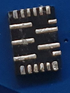

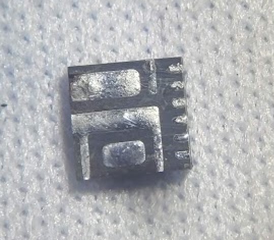

            #45
            Re: IC Marking Codes and Datasheets #2

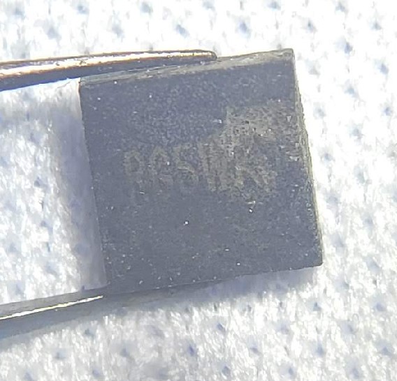

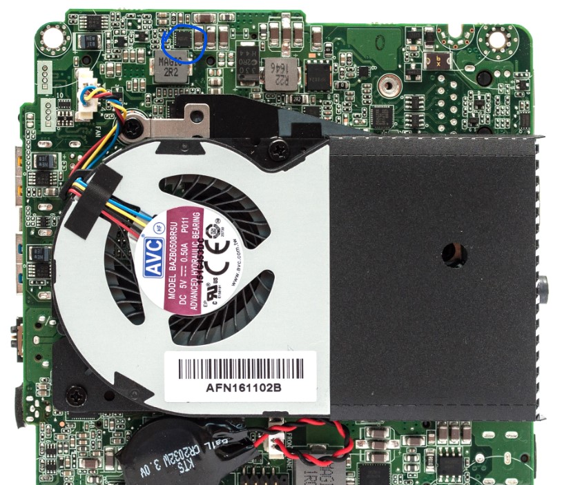

            I need help identifying this IC, it's from an Intel NUC NUC6CAYB, attached are 2 photos of the IC and 1 photo of a normal motherboard found on the Internet.
            I think the marking reads RG5WK or R65WK and the other photo reads RG5VC or R65VC I think
            • orientalsniper
              • Apr 2013
              • 461
              #46
              So I think I found it, but I'm not sure: https://www.ebay.com/itm/334488627756
              Is it SYX198CQNC ? What does this IC do? The NUC is flashing RAM problem.
              • mon2
                • Dec 2019
                • 14996
                #47
                Appears to be a dual mosfet from Silergy. Replace it from a donor board or from AliExpress.
                US $4.59 15%OFF | 10pcs SYX198BQNC SYX198B SYX198 (RF4BJ RF3CG RF2BN RF...) QFN-6
                https://a.aliexpress.com/_mNTwNHw
                Do share the full markings with the vendor before purchasing.

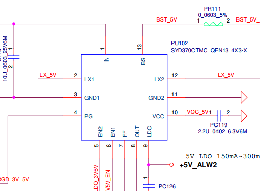

                  #48

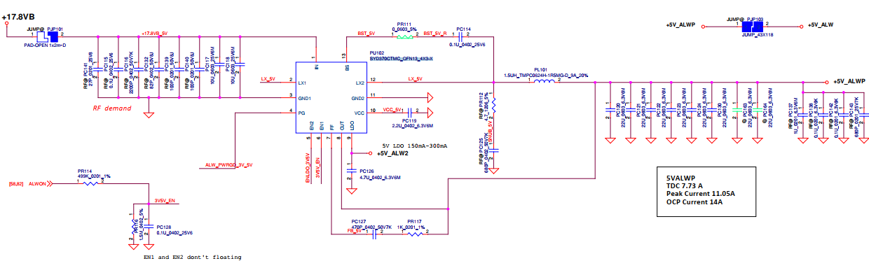

                  Can anyone help me. I have a switching voltage regulator on a DELL Latitude 5430 for 5v power. I can't identify the IC code
                  • mon2
                    • Dec 2019
                    • 14996
                    #49
                    What is logic board # of this Dell? LA-**** markings. This part is likely from Silergy.
                    • TuanTongbadcaps
                      • Mar 2023
                      • 64
                      • VietNam
                      #50
                      I apologize for the slow response. DELL 5430 board number is LA-L591P
                      • Bonzas
                        • 474
                        • Indonesia
                        #51
                        DNExxx = SYD370CTMC
                        Pinout equivalent with this ic on here
                        https://www.badcaps.net/forum/showpo...81&postcount=3
                        • TuanTongbadcaps
                          • Mar 2023
                          • 64
                          • VietNam
                          #52
                          Originally posted by martha februarini
                          DNExxx = SYD370CTMC
                          Thank you very much. This is exactly what I was looking for.

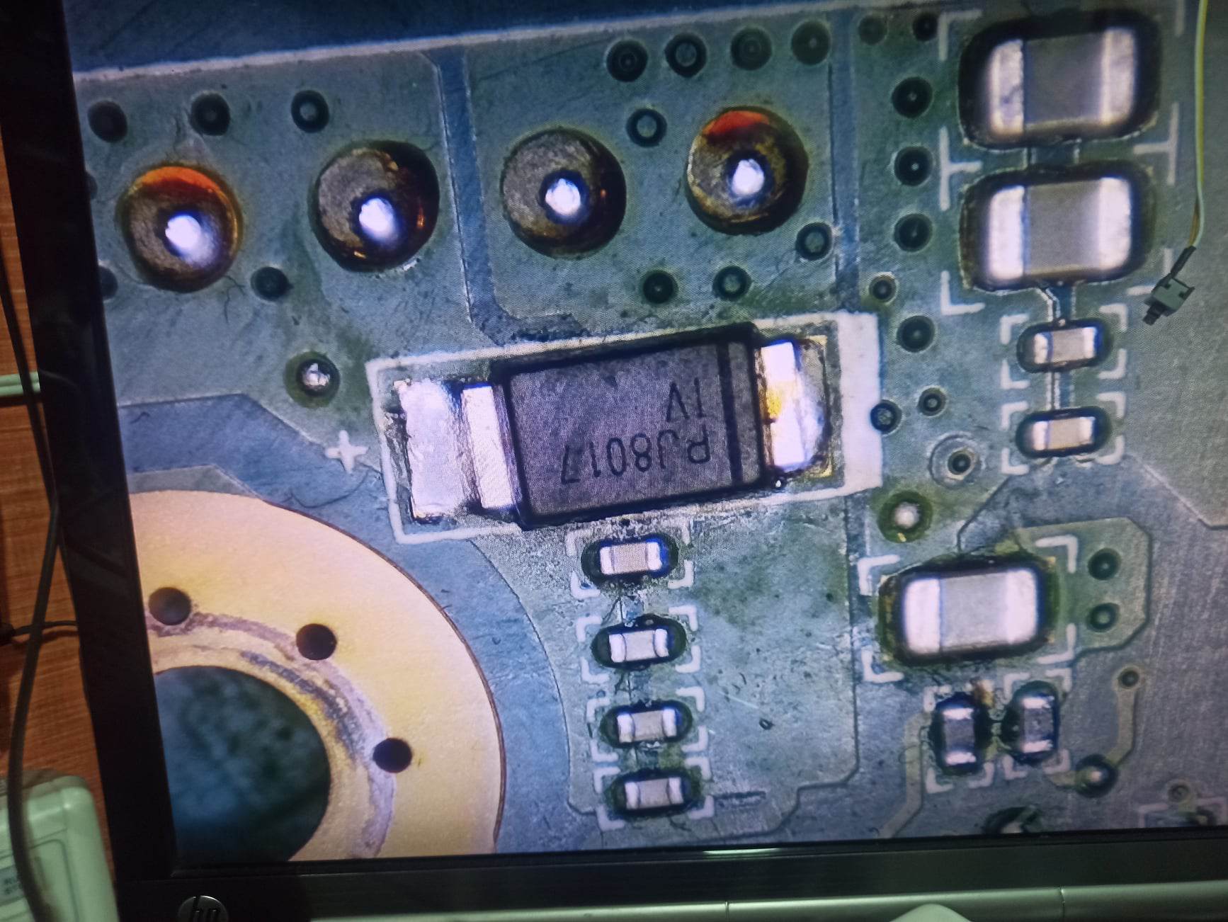

                                  #56
                                  A diode marked as PJ8017, but I can't find it on Aliexpress.
                                  I need to find the correct part number.
                                  • orientalsniper
                                    • Apr 2013
                                    • 461
                                    #57
                                    I think I found it, using a similar schematic, it seems to be P4SMAFJ20A since they have IV as their marking.
                                    It seems to be a Transient Voltage Suppressor (TVS) diode, can I replace it with a Schottky Diode?
                                    • mon2
                                      • Dec 2019
                                      • 14996
                                      #58
                                      Can you share more details on which board contains this diode ? PJ may be Panjit (Taiwan).
                                      • orientalsniper
                                        • Apr 2013
                                        • 461
                                        #59
                                        It's the G7BF, there's no schematic for it, I think it's similar to DAG7BFMB8D0.

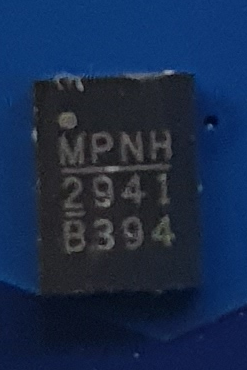

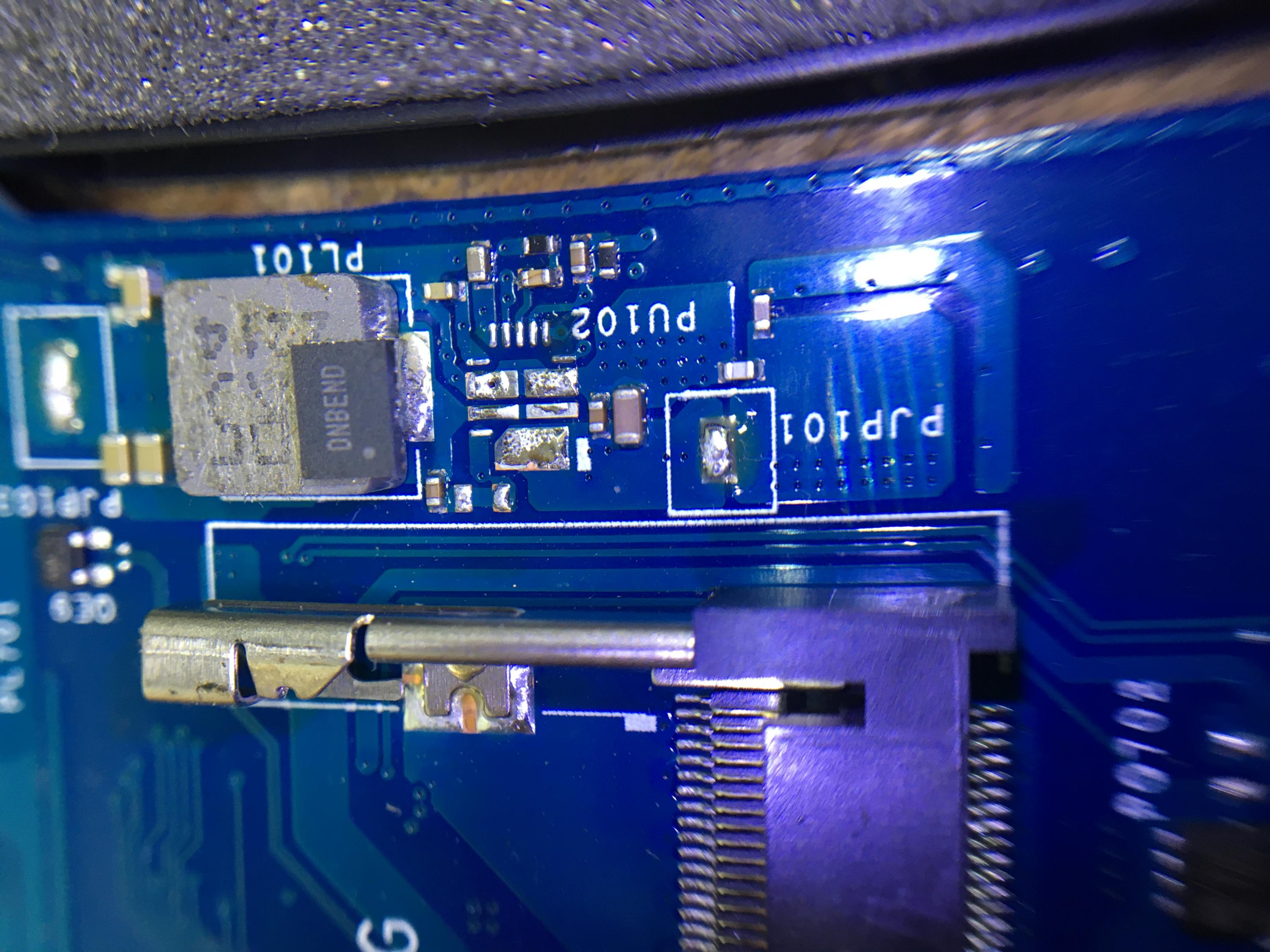

                                          #60
                                          someone help me figur out this one please
                                          it is in CPU power circute, probably dual mosfet
                                          Acer Chromebook intel Gold CPU
                                          Model Name: CB515-1W
                                          MB: DA0ZBTMBAD0
