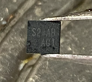

        Dear friends, I am working on Lenovo Yoga 7 14IRL8, no schematic available. Upon trouble shooting I found this chip shorted. There is a code marking S2=AB on this chip, but could not find this marking (View Photo). I thnk this chip is soldered on the 3.3V or 5v rail. Can someone help me finding the real number of the chip. Thanks in advance.

          When the marking has an = its probably a richtek part https://www.badcaps.net/forum/troubl...19#post1482819 Google search - richtek S2=
          How many pins does it have,it might be a RT6310CGQUF https://www.richtek.com/assets/produ.../DS6310-04.pdf

            "SMDFlea", it's 23pin & I think this is the same chip,, the link you have send me. Thank you so much.
