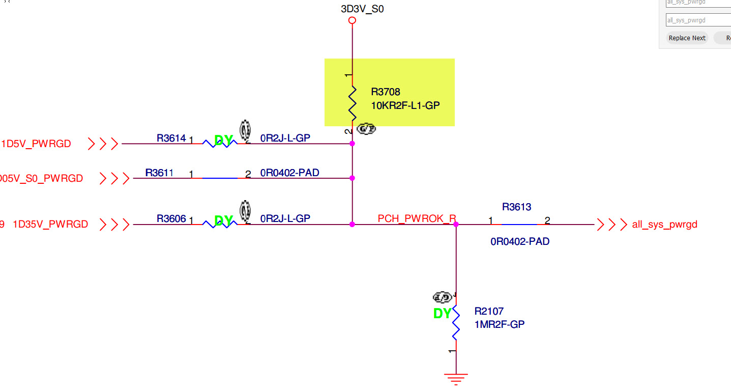

          one funny thing is: if i want to measure all_sys_pwrgd the device is shutting down (regardless of the smd component)... whatsoever

            Based on the logic board name, this is officially the 'Poseidon Adventure' ? Sorry, could not hold back on that one. It is not everyday such a pun can be thrown out there.
            Perhaps the capacitive load of your meter lead causing this signal line to tank?
            Confirm, when you are fully rested, the pull-up resistor @ R3708. Remove all power and confirm that it is ~10k.
            Then with power, confirm that pin #1 (R3708) = ~3v3.
            The diode readings look ok - was expecting to see a different diode value for the non-functional I2C bus pin.

              hey, so the resistor measures 8.7k in line and 10k out of circuit. 3.3 v on pin#1 present.
