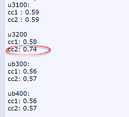

                  #68
                  Re: MacBook Pro 15" 2017 A1707 Touchbar No power
                  Originally posted by mon2
                  A1707 is about power delivery.
                  Power delivery (PD) lines are the CCx lines on the USB Type C connectors.
                  Check the diode readings for the:
                  CCx lines
                  D+ / D- lines
                  (Meter in diode mode. Red meter (yes, RED) to ground. Black to point to test).
                  Most of the boardview files offer DIODE reading values of a known good board. Compare your values against the reference values.
                  hi, sorry I somehow missed this @mon2 .
                  here they are :
                  u3100:
                  cc1 : 0.59
                  cc2 : 0.59
                  u3200
                  cc1: 0.58
                  cc2: 0.74
                  ub300:
                  cc1: 0.56
                  cc2: 0.57
                  ub400:
                  cc1: 0.56
                  cc2: 0.57
                  @powerblackout I have 3.3V on UB2890.
                  Have an oscilloscope to borrow but never used so would need more instructions.
                  About missing R41*, those are fine, the do not match the schematics as i saw in the video from Paul Daniels.
                  CB214 I pit back it should be fine.
                  Do te diod readings say anything?
                  Feel free to post that ROM file anyway, can be useful because hard to find.
                  Can you explain what do to with the oscilloscope?
                  The ROM chip had some liquid spill so it might actually be that in my case.
                  Thank you again for the help and support.
                  For convenience, please find the schematics attached that I am using.
                  I ordered some chips, they were cheap, I hope they are the rights ones.
                  I'll try to take this all the way, since I have kind of given up on being able to fix it, so it would be absolutely awesome if we can pull it off anyway
                  • mon2
                    • Dec 2019
                    • 13992
                    #69
                    u3200
                    cc1: 0.58
                    cc2: 0.74
                    U3200 readings are off. Have you replaced this controller? It should be replaced with the same part #.
                    • openminded
                      • Apr 2017
                      • 73
                      • home
                      #70
                      Thank you, what should the readings be? can“t find it in openboardview.
                      I replaced it with a new one ( replaced it before but it looked bad )and now it reads 0.53 at both cc points.
                      Also, it boots with the plug both sides in now - but again to 5.2 V and no rebooting.
                      More interestingly, UB300 and UB400 side do not go on on any plug orientation now. They used to work both, where one only on one side of USB-c orientation.
                      The USB power meter I use inline does not go on now on either UB300 or UB400, the diode measurments are the same.
                      Ideas are welcome, I spend a $100 on CD3215s now, not even sure if supplier chips were good. This is getting very difficult...
                      I'm kind of done switching CD3215 chips on this board, I get the feeling something may be wrong with it that destroys them, or is that not possible ( or should not)?
                      Thanks for all the help, hope there is a solution.

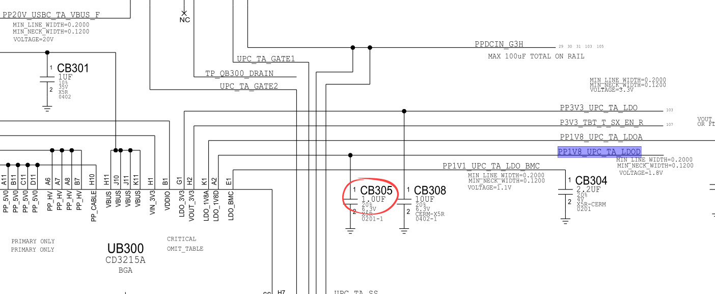

                                Configure your meter in resistance mode.
                                For UB300, measure & post the resistance to ground of the pp1v8_upc_ta_ldoa rail.
                                • openminded
                                  • Apr 2017
                                  • 73
                                  • home
                                  #76
                                  I think that both UB300 & UB400 have issues.
                                  Hi, thank you for the quick reply!
                                  I measure about 0.9 Ohm in the beginning and then it slowly drops to 0 in about 20 seconds.
                                  Measuring the ground pin of that cap shows 0 first and then goes up a bit.
                                  bad cap ? Measuring in bleep mode gives bleep, so looks like a short on it.
                                  • mon2
                                    • Dec 2019
                                    • 13992
                                    #77
                                    Yes, could be a bad cap. What is the history of this CD3215 ? Was it replaced?
                                    If yes, could also be soldering of the replacement part.
                                    There is only 1 cap on this rail - see attached. Remove it and check the resistance to ground again for the same rail.
                                    If there is still a short then the fault is in the soldering.
                                    Proceed to apply flux on the top of this IC and hover over the CD3215 in circles till you cover the top surface with enough heat to melt the balls.
                                    Use tweezers to gently nudge the IC - 'make it dance'. Then the IC will naturally bounce back into position - do this 2-3 times and the chip should settle onto the proper pads. Remove the heat. Allow it to cool and check the resistance of this rail again.
                                    If the rail does return to normal (it should) then place the innocent cap back on, unless the cap is guilty.

                                      I was a bit confused, but I think you mean CB306 because it is the LDOA rail?
                                      CB305 resistance was very high.
                                      I moved CB300 - it was replaced before - after that CB306 reading is better : 0.484 with diode mode on ldoa rail .
                                      New diode readings:
                                      ub300:
                                      pp1v8_upc_ta_ldod : 0.443
                                      pp3v3_upc_ta_ldo : 0.466
                                      pp1v1_upc_ta_ldo_bmc : 0.471
                                      pp1v8_upc_ta_ldoa : 0.487
                                      ub400 after same treatment:
                                      pp1v8_upc_tb_ldod : 0 - the cap cb405 is off
                                      pp3v3_upc_tb_ldo : 0.567
                                      pp1v1_upc_tb_ldo_bmc : 0.473
                                      pp1v8_upc_tb_ldoa : 0L
                                      Does this mean the UB400 is bad or anything else?
                                      Not connected properly when measuring 0L ?
                                      I will try to replace it again, or move again, this one needs a lot of heat to move and CB305 came off along the way .
                                      Thanks for the help, seems UB300 is ok now?
