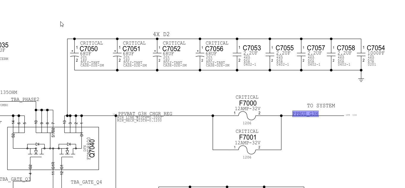

              What is the 820-xxxx board number on your A1707 logic board ?
              1) Does your power adapter go to 20V to power your logic board ? Do you have a USB C meter ?
              2) See attached. Measure the voltage of PPBUS_G3H at the referenced fuses.

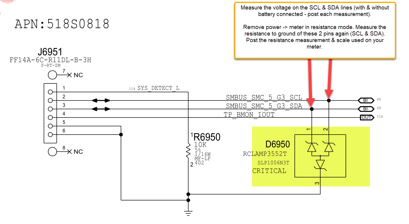

                  The battery BMU communication is over the I2C / SMBUS interface. Locate the battery connector and in the schematic will be a dual ESD diode component.
                  Often it is D6950 but do confirm the reference in the schematic. I do not have the schematic in front of me at this time.
                  Once you find this part, measure the voltage on the SCL pin to ground. Meter in 5 volts dc or higher.
                  Repeat to measure the SDA voltage to ground. Post each measurement.
                  Next, remove all power. Meter in resistance mode.
                  Check the resistance to ground of these same pins.
                  We are checking to see if this dual esd diode is defective which will halt the proper operation of these common communication lines.

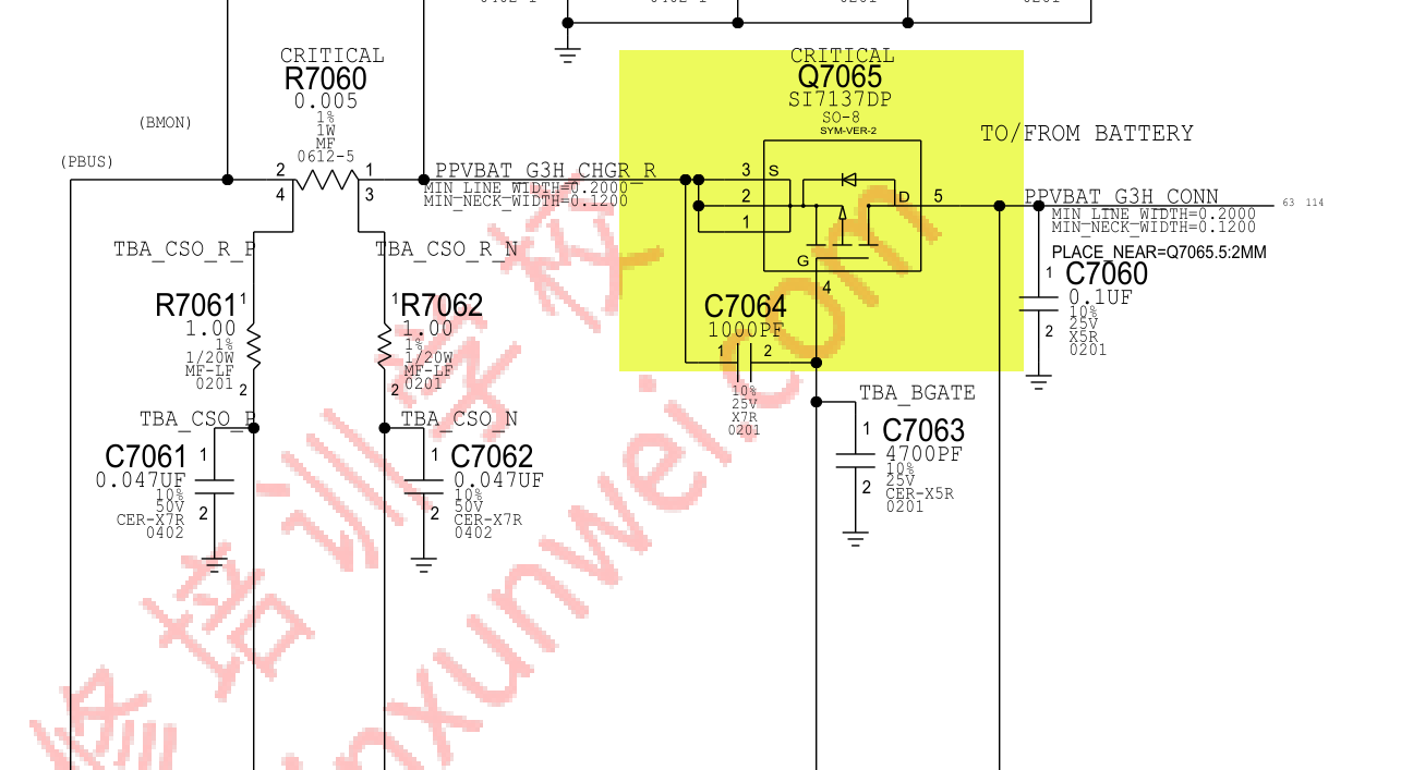

                    #89
                    Re: MacBook Pro 15" 2017 A1707 Touchbar No power
                    See attached.
                    1) Is the battery a known good battery ?
                    2) what is the present voltage on the battery ?
                    3) Measure this voltage @ PPVBAT_G3H_CONN and post the voltage value. This is the voltage that is being used to interface with the logic board via the battery mosfet @ Q7065.
                    4) Leave the power adapter OFF. Using only the battery, what voltage do you see @ Q7065, pin # 1-2-3 (SOURCE; PPVBAT_G3H_CHGR_R) ?
                    5) With care, take the measurements of the following pins:
                    TBA_CSO_N
                    TBA_CSO_P
                    This is the current feedback loop used by U7000. The ISL9239 IC takes as input the voltage on each of the above legs and monitors the voltage drop across the current sense resistor @ R7060.
                    Based on the voltage drop, U7000 is able to determine if there is too much of a load on the logic board and will shut down the use of the battery mosfet and/or charging.
                    So it is important that the resistor values remain as per the original PCB assembly schematic. Respectively, the feedback voltage must reach the ISL9239 otherwise it assumes that the voltage drop is caused by a dangerous and excessive load and is beyond the expected current draw -> shut it down mode.
                    6) Will be a good idea to check if the battery mosfet (Q7065) is ok with a resistance check.
                    Remove all power / remove the battery. Meter in resistance mode.
                    Measure the resistance of Q7065 as follows:
                    Source (1-2-3) & drain (5-6-7-8)
                    Source (1-2-3) & gate (4)
                    Gate (4) & drain (5-6-7-8)
                    Post each measurement and the meter scale used. If your meter shows '1' or 'OL' then the meter scale is too low -> switch to a higher scale till the meter is able to measure the resistance values. Too low of a reading means this mosfet is leaking / defective and must be replaced.

                      Thank you for getting back with your reply. I have located the D6950
                      PIN 1 - SMBUS_SMC_5_G3_SDA = 3.398 - 3.401 ,
                      PIN 2 - SMBUS_SMC_5_G3_SCL = 3.398 - 3.401
                      The reading isn't stable for both pins, started reading from 3.0 M ohms and declined till it stopped at 130.2K

                        Voltage and resistance are fine. So the ESD device is not impacting the communication lines.

                        2) After the board powers off -> check the voltages of PPBUS_G3H.

                          2) 2.195 V on the battery. connect the com to - and the Red probe to + on the battery board
                          3) PPVBAT_G3H_CONN is 12.66 V
                          4) @ Q7065, pin # 1-2-3 (SOURCE; PPVBAT_G3H_CHGR_R) = 12.66v
                          5) TBA_CSO_N = 12.66v
                          TBA_CSO_P = 12.66v
                          6) Q7065 , shows 10 M ohms rose up to 50 MB ohms then 0L for all 8 pins. all measure in diode mode and the mosfet seems fine.
