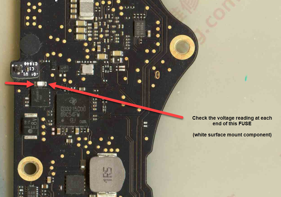

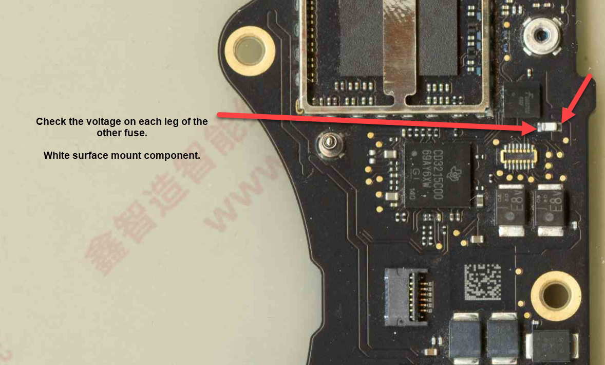

      There are 2 surface mount fuses on the A1707 (assuming you have the 820-00928 logic board - have the same one in the shop now).
      F3000
      and
      F3001
      Please see attached and check the voltage on each leg of this 2 legged part.
      Do this very carefully as you will need to plug in your external adapter onto the USB connections.
      Do you see any voltage on this fuse? Post your results.

        #43
        Re: MacBook Pro 15" 2017 A1707 Touchbar No power
        hi, I have the 820-00281-A.
        Yeah seems a lot of those go bunkers .
        The boardview and schematics I use are attached.
        I was actually using the other side of the board, so FB200, that's where in the beginning I had 20V and now only 5.1 (because of one of the USB chips I understand).
        I connected the power connector on the F3000/F3001 side, readings:
        - F3000 - 0V
        - F3001 - 5V
        When I connect power on the FB201 side I get 5V on that and nothing on the other side.
        Does that mean an issue with the 5V rail ?

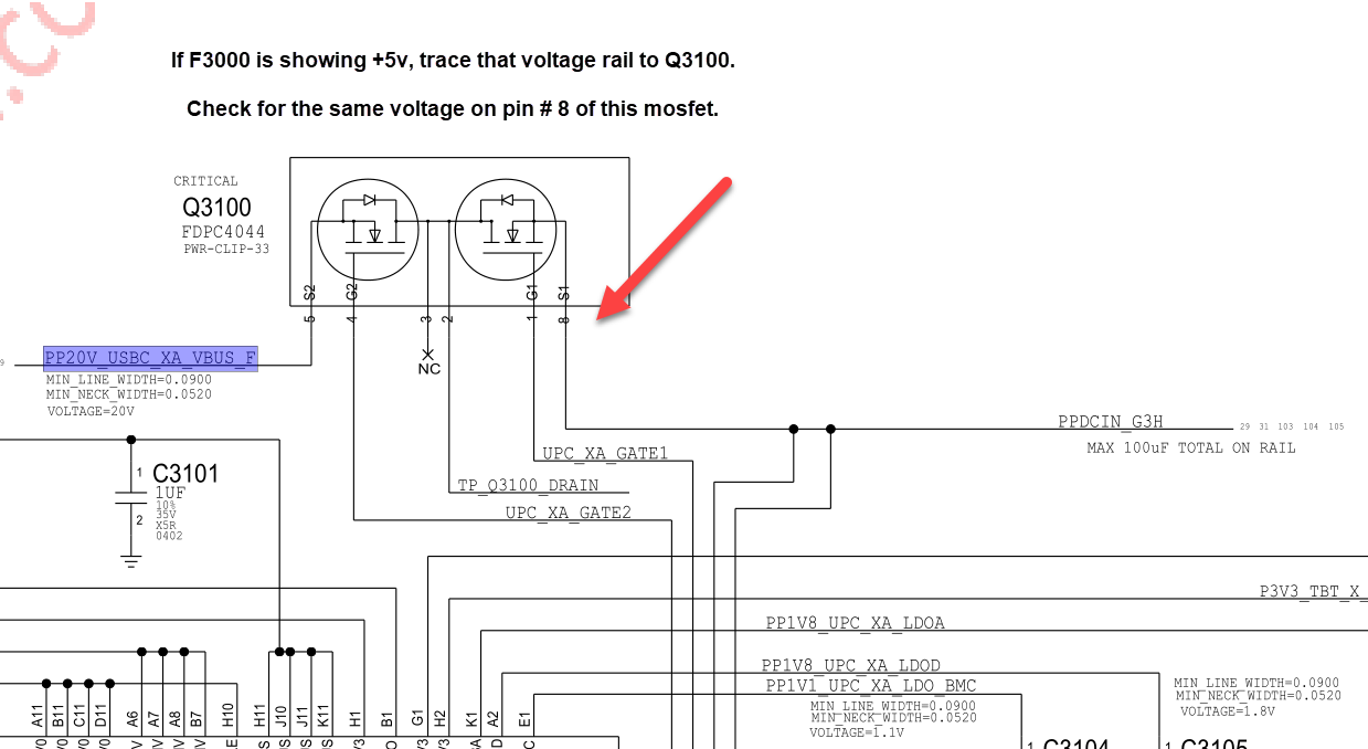

            #45
            Confirm that F3000 is receiving the +5volts.
            Then confirm that Q3100 is turning on and producing this voltage onto the PPDCIN_G3H @ +5 volts.
            Here is an excellent webpage that discusses about the CD3215 controllers and how they operate.
            The SMC (power controller management chip) pings each CD3215 and negotiates the escalation of the power delivery to 20V once all is well.
            https://www.logi.wiki/index.php/CD3215_Bootup_Sequence

              #46
              hi, thanks. current problem is F3000 does not get 5V. could feed it with a power supply to test? will research further tonight and update, thanks.
