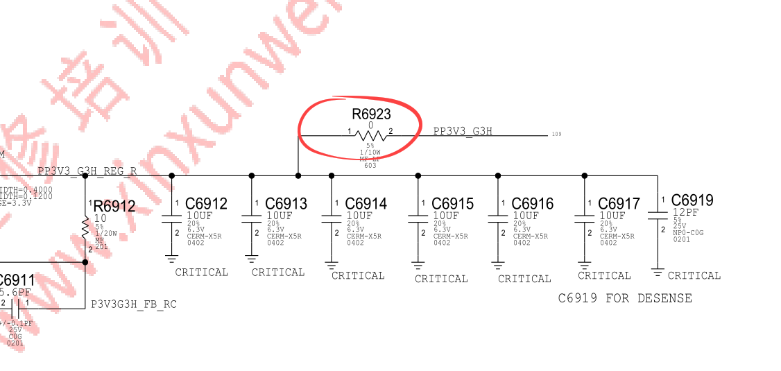

    MacBook Pro 15" 2017 A1707 Touchbar No power
    Great forum! Love you guys for helping me learn here. Pulled up Schematics.
    USB C Tester plugged in. Starts at 5V then the USB C tester shuts off and restarts. No test further. I plugged the USB C Tester into a working logic board (has a bad SSD Corruption) to verify the USB C Tester is working, and it works fine so the logic board we are testing is looping at 5V. Turns on the USB C Tester after 3 seconds it turns it off and on again. Loops. Tested voltage for G3H and it seems the enable switch at U6903 is present. Tried both USB C ports, same result
    Any points I should test to determine what I am missing? So far I have learned a lot but small things like this come up and I could use the knowledge for further future repairs and enjoyment!

    Re: MacBook Pro 15" 2017 A1707 Touchbar No power
    Tested for G3H. And its present. Then the voltage drops to 0 then starts over at 3.4Volts then drops again. This is obviously the cause of it shutting down. It still is not getting to 20V on the tester. Just stays at 5.20Volts then shuts itself down and starts over.
            I would give a try to replace 4 of the CD32 as long as you get steady 3v3 then start from there. But if you have a fluctuating voltage it could be the ISL9240
                            What is the 820-xxxx code for your A1707 logic board?
                            Is it 820-00281-A?
                            • mon2
                              • Dec 2019
                              • 14634
                              Remove the 0 ohm resistor @ R6923 and power up again.
                              What is the voltage out out on pin 1 of R6923 (without this series resistor)?
                              Do you see a steady 3v3 on this rail or still power cycles for this rail?
                                        Removed the O OHM resistor. It is not power cycling anymore and I now have a 3.3v steady on PIN 1.
