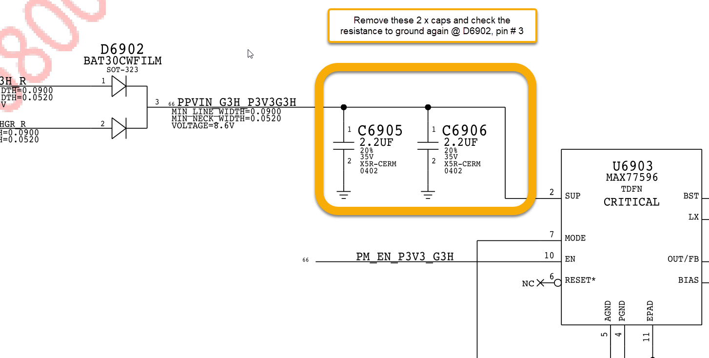

    I have a Macbook Pro 2017 Touchbar (A1706) that suddenly shut down for no reason.
    So I took it apart and started measuring.
    The PP3V3_G3H seems problematic. I traced the line to component U6903 and on Pin 10, I measured 1.9V instead of 3.3V.
    Unfortunately, my skills stop there and I don't understand where this type of failure can come from.
    I saw on videos of repairers that the failure could come from the U7000 component which would be at the origin of the 3.3V but they have absolutely no voltage. I have a 1.9v...
    What do you think ?
    Thank you !

                    Re: Macbook A1706 EMC3071 (2017 Touchbar)
                    Remove all power. Meter in resistance mode.
                    Measure the resistance to ground of D6902, pin #3.
                    What is the resistance?
                    • kurtspirit
                      • Feb 2019
                      • 112
                      • France
                      on Pin#3 148oHm
                      • mon2
                        • Dec 2019
                        • 14720
                        D6902 appears to be defective.
                        Remove D6902, then check again the resistance to ground of D6902, pin #3 pad on the logic board.
                        The resistance is a bit low but let us see what it is with this dual diode off the logic board.
                        You have ~5v going into the dual diode but ~1 volt leaving. There should only be ~0v6 voltage drop here.
                        This large voltage drop may be due to low resistance on pin #3 which will imply the regulator is the fault.
                        Do you have spares of the dual diode or can source this part? It is a common part available from AliExpress, Mouser or Digikey or RS electronics.
                        With AliExpress, you can order the full replacement parts to rebuild this circuit area for cheap.
                        Can post some ideas later. Back to my beauty sleep...

                                      • mon2
                                        • Dec 2019
                                        • 14720
                                        yes, the dual diode for sure is required to be replaced. Order spares along with the regulator.
                                        See attached. Remove both of these capacitors off the logic board.
                                        No power to the board -> check the resistance again on D6902, pin # 3 after these caps have been removed.
                                        We are trying to determine which part is causing this line to be loaded down so much. These caps are not polarized so they can be placed back in either direction after this quick test.
