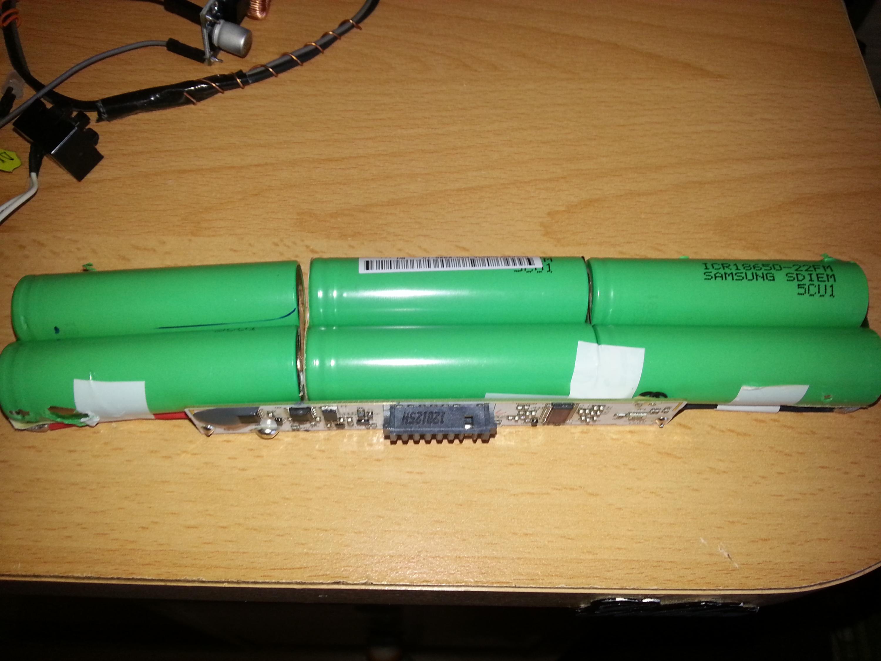

    Good day folks. I recently managed to score a Samsung NP300E5C laptop which was sold as defective, so I took the gamble and turns out all that was wrong with it was a broken power jack, so it was a snap to get it going again. 8Gb of RAM and a modest i5 CPU on it - worth saving.
    Unfortunately the battery is totally dead, not that you'd expect otherwise for a laptop this old, so I wanted to mess around with it and see if I can replace some of its cells to at least allow me to move it from one room to the other without having to shut it down every time I have to pull the adapter.

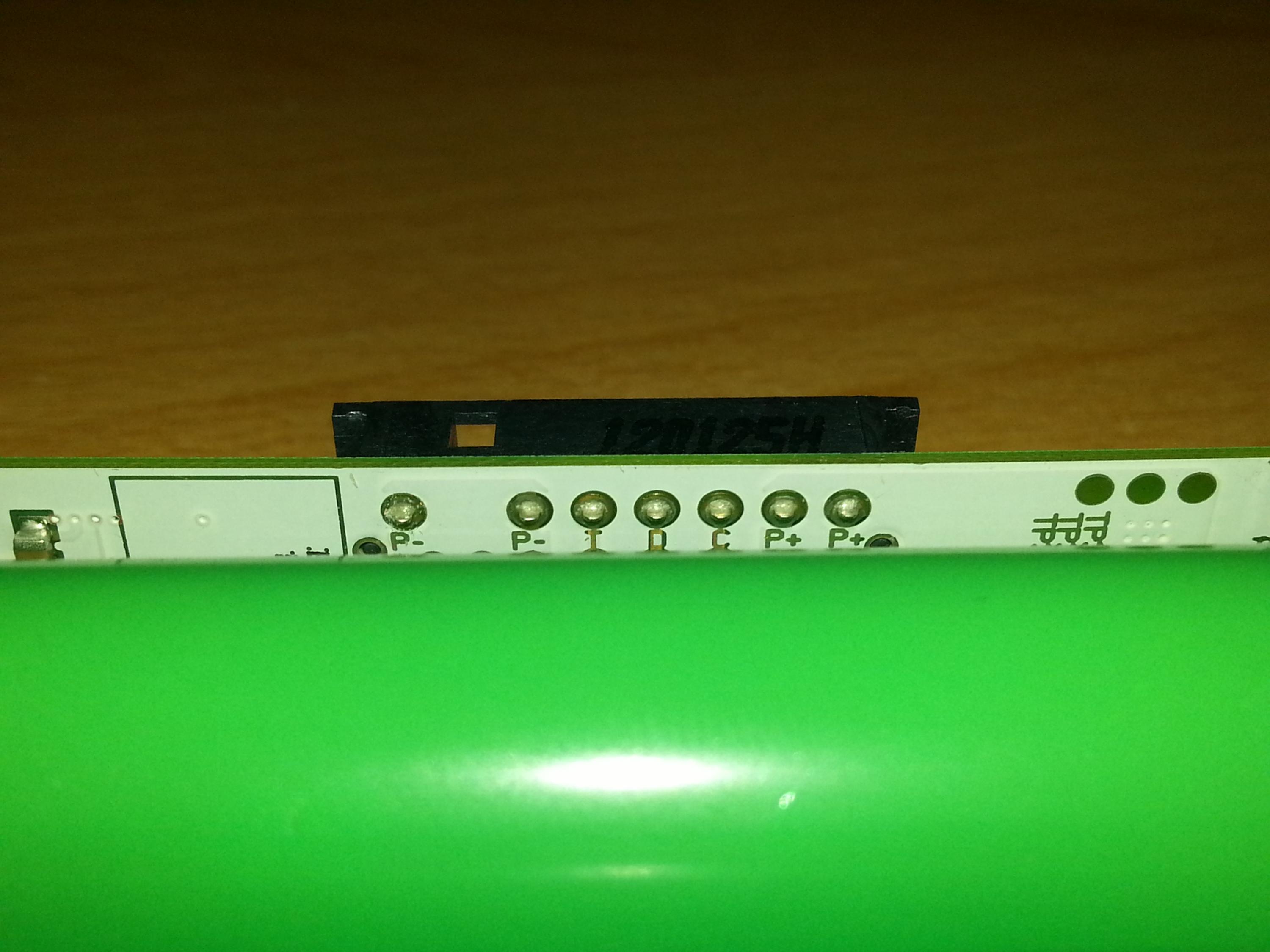

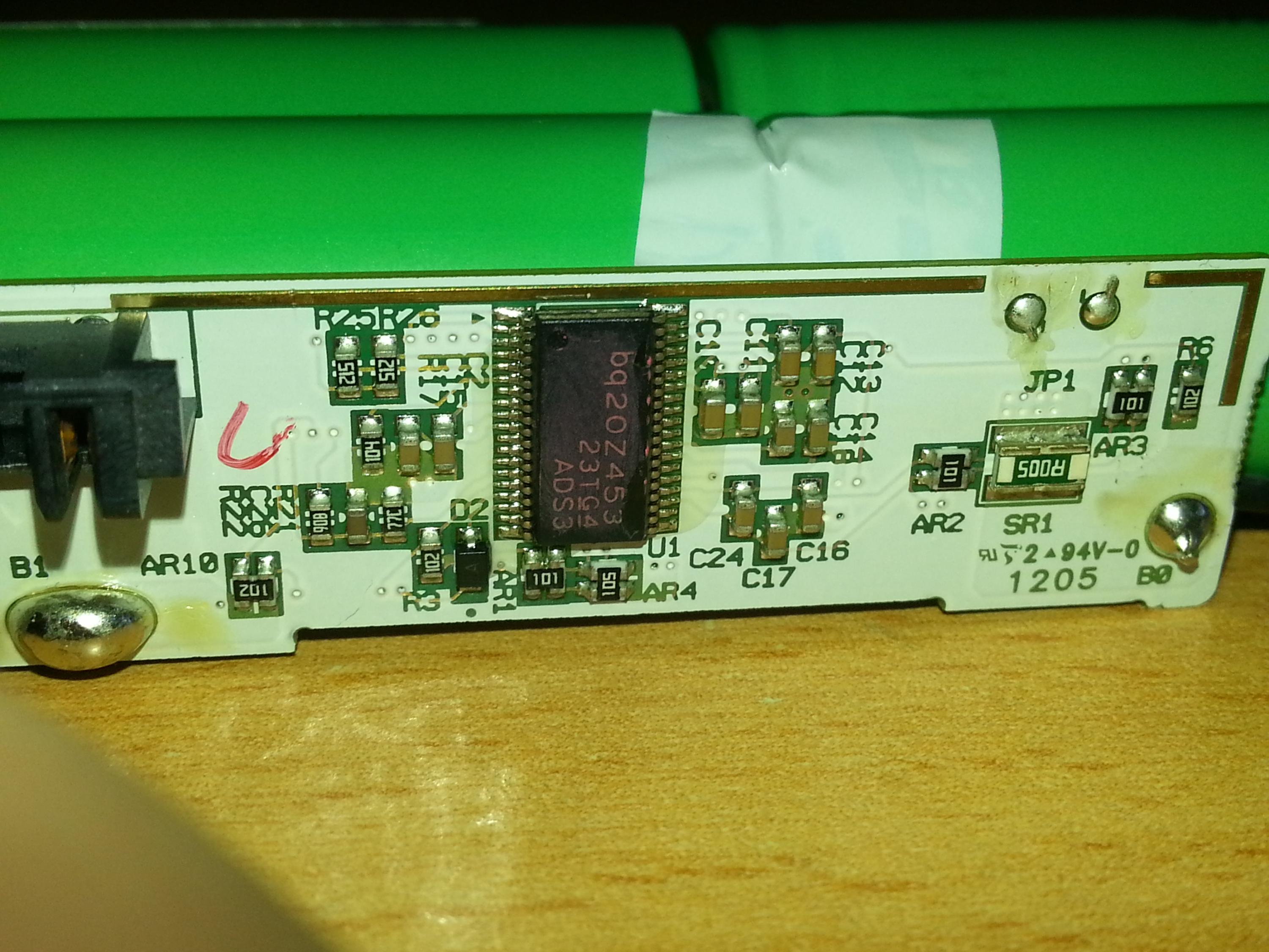

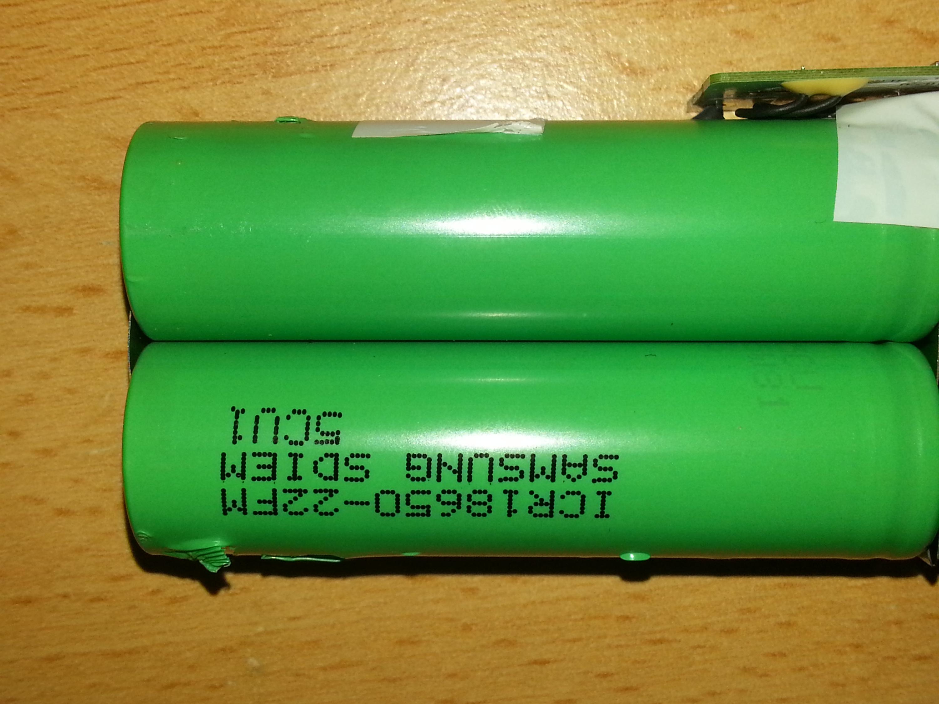

    I popped the battery open and found the 6 cells. Three sets in series. I applied 11v to the ends of the pack, limited to 1a from my power supply and charged them up for several hours. Measured the 3 sets of cells afterwards and sure enough they all read the same 3.7v, so the pack itself was fine...what gives ? Turns out the laptop refuses to run on battery if the battery itself tells it it's past its due, even though the cells are fine. How can it do that ? I did a bit of research and found that there's a little controller chip on that board there - the BQ20z in my case which I pictured there - which is responsible for this. Apparently it can be reprogrammed to reset the battery to factory conditions, so I did some digging and found this software BE2Works which supposedly does the job. It looked promising enough to give it a try, but then I realised I have no idea how to connect up to the battery...the official site, as well as some videos I found, show some sort of adapter that does this. Without it, the software just says "No adapter found" and doesn't even start so I can at least look at the GUI. The site lists some "official" hardware, the simplest of which seems to be that CP2112, which I managed to find fairly cheap on Ali, but I wonder if it can be done some other way. I already have a CH341 programmer which supports I2C, so I was hoping I could used that instead. Trouble is the software only likes playing with the hardware listed there, so I'm not sure it can be fooled to read from other devices.
    I managed to identify the data and clock pins (SDA/SCL) on the battery connector, since they were thankfully labeled on the backside of the board there, but accessing them is going to be tough. Has anyone successfully done this hack before to make it remotely worth it ? Any ideas ? Cheers guys.

      The commands to reset and re-initialize the EEPROM inside the battery pack are not publicly documented. As far as i know, author of the Be2works did an extensive reverse Engineering to find out the format of the EEPROM data and the proper commands to reset it. So he is not willing to gave his work for free and charges fairly a good amount for the app. His targeted customers are those who refurbish battery packs at a large scale. Buying it wont worth for a single use.

                  I made attempts about 15 years ago, when the batteries cost much more than now.
                  It's very expensive research, need to buy ev2300 or ev2400 hardware, after that there are a very large documentation about the smart battery protocol.
                  Not all battery chip are supported and in my opinion this research have a sense only for study purpose not for business.
                  The very expensive battery pack, sometime, have a dedicated cells not easy to find in the market at reasonable price.
                  A good logic analyzer in congiunction with hardware above can help to understand the protocol.
