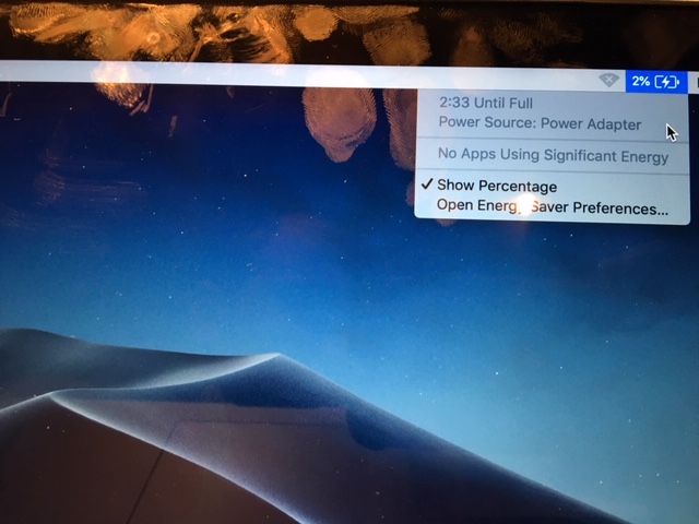

                Re: any help with this please 820-3332-a whistling noise on U7000 when i connect eith
                [QUOTE=dellxps15;884528]voltage with battery only ?
                hi dellxps15
                i don't understand how possible but now is charging and no noise, i am going to leave it like this to test it for some time, thank you very much for the effort and time for trying to help me you and piernov
                many thanks
