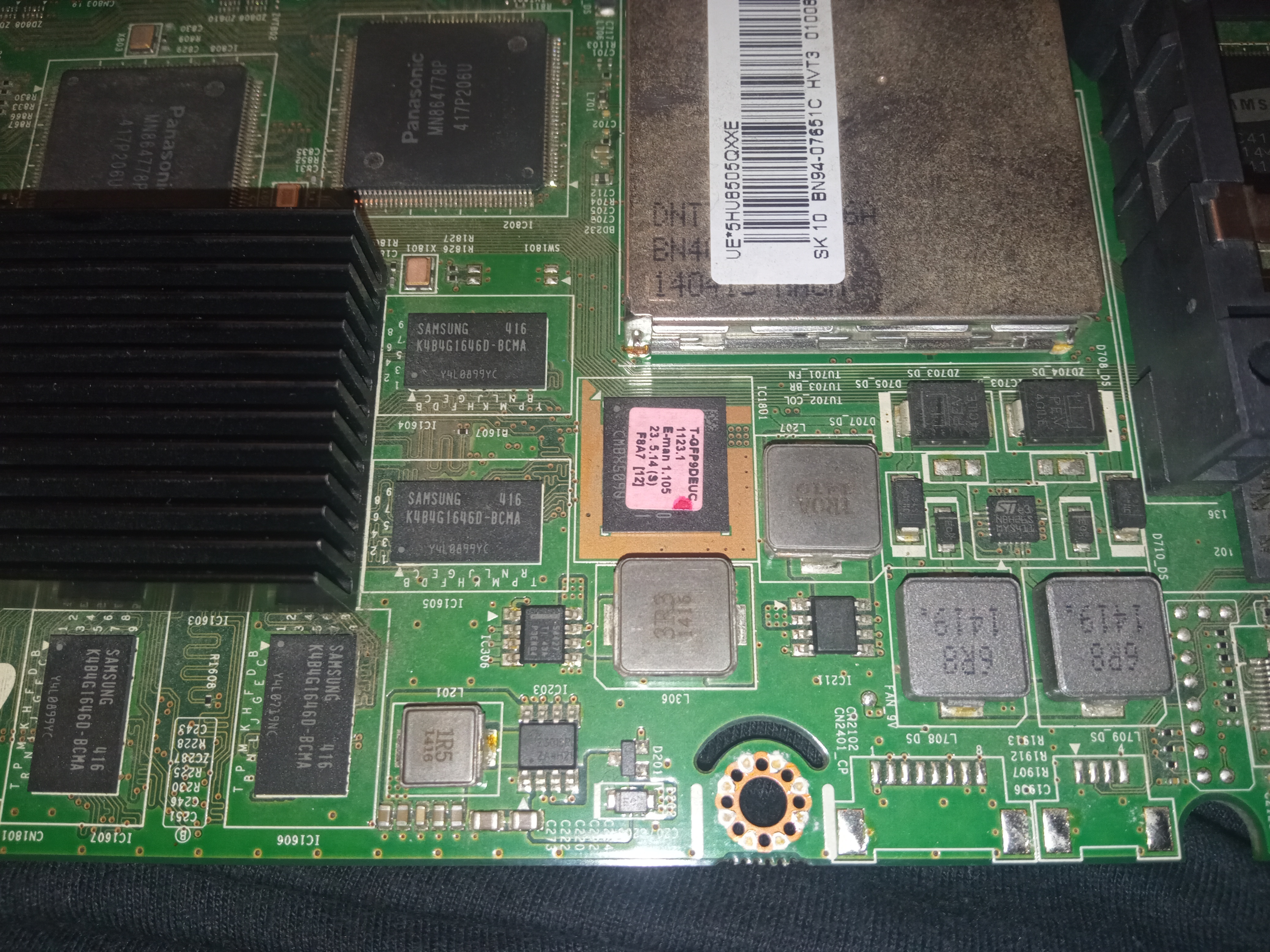

                      My TV is now running again but I have a defective ocb and a defective TV mainboard lying around.
                      I would like to repair this.
                      I have measured Vdrop on all major components and they are the same, so I think it is a software error. I have read out all winbond ICs with my CH341a and compared the files from the defective and healthy board. The files are exactly the same size and have exactly the same content.
                      there is still an emmc Samsung KLM8G1GEAC-C021 on the ocb.
                      I suspect that this emmc is defective (or has defective sectors). Can I somehow read it out without desoldering it?
                      I have an XGecu T48 at my disposal. But I don't see any pins around the emmc where I could possibly connect it.
                      Is it only possible by desoldering the emmc and getting a suitable adapter?
                      or could it even be a defective RAM (Samsung K4B4G16460-BCMA)? can I test the RAM somehow?
                      Is the RAM replaceable or do I have to program/link it somehow?

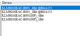

                                ​Thats the supported device list for my programmer. (searched for KLM8G1GEAC)
                                I already ordered a KLM8G1GEAC-C021 (I dont know what the -C021 is for and whether its important or not)
                                I think I'll get around to putting the emmc (the one with -C021) into the programmer at the beginning of next week and see if it basically works.
                                Then I would get back to you and ask again about the content for the emmc.
