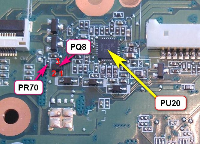

          Re: Hp Probook 455 G3 DAX73AMB6E1 blinking charge light, not turning on
          Yes, you can use the DC jack from the laptop if you disassemble it.
          Flickering problems like that are usually the screen itself or the cable connecting it to the motherboard. If movement leads to flicker, then you can gently press/flex the various parts to search for bad connections or broken wires. It might be necessary to disassemble the top cover (i.e. the part of the case that surrounds the LCD itself) to properly check all areas.
          Yes, that component is PU20. Location is in the pic in this post.

            I'll disassemble and see what I can find. I'll get those measurement on PU20in a day or so.

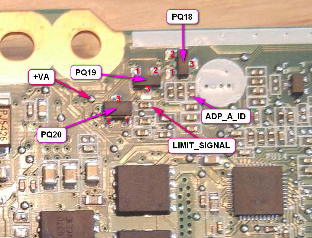

                        I'm good, thank you. Just a busy weekend. Didn't have a chance until now to fully investigate the next steps.
                        Okay, so that is a very curious result. But, of course, sometimes the less likely thing is what happens.
                        So we are left in the same position as before. Either the resistance from pin 6 to the positive connection is too high, or the resistance from pin 6 to ground is too low.
                        First, I'd like to just verify how many ohms the ID resistor is inside the new power supply. With the new power supply and DC jack plugged into each other but not plugged into anything else, what is the resistance between the pins 1 and 6 (red and brown wires)?
                        It should be ~500k for a 45W power supply, 390k for 60W, or 440k for 90W.
                        You've already checked the resistance between CN11 pin 6 and ground and it was fine. Let's try testing it a couple additional ways.
                        First, connect the power supply and DC jack to the motherboard. Do not plug the power supply into the power outlet. Measure the resistance between +VA and LIMIT_SIGNAL as indicated in attached pic #12. This is the same as measuring the red and brown wires, but also will test the connection through CN11. I've marked some other stuff on the pic, but ignore that for now.
                        Second, try measuring between LIMIT_SIGNAL and ground using diode mode in the meter just to see if the readings are any more interesting. Try both polarities of the probes.

                            I was just looking over the board with the camera, and discovered that the component next to CN11 nest to pin one, and white dot on board, has lifted not connected to outside pad towards the edge of the board. I'm assuming that is a diode. I'll get those measurements this evening, thanks BlueMidnight!

                              Ok ,did all measurements over, first the Id resistor on DC jack and power supply is 333.3 K .ohms next, CN11 pin6 to ground is 62.0 K ohms Next, +VA and limit signal, 1.749 K ohms in pic#12 next in diode mode OL with probes switched. same either way. Also looked at board under scope. Component next to CN11 pin 1 white dot just fell off. It was just hanging on. I do blieve its a diode. pads look ok. ITS TINY, can hardly see it.

                                The component near pin 1 of CN11 is PC164, a 0402 size 0.1uF 25V capacitor. It's used for input power filtering. While it should be there, it shouldn't prevent the board from working.
                                The +VA to LIMIT_SIGNAL resistance looks interesting. What is the reading without the DC jack connected? Is it the same in both polarities? What do these measurements look like on the second board?

                                  no DC jack connected +VA to limit signal 187.3 K ohms, reverse 188.4 K ohms. In diode mode OL, reverse same OL Board #2 187.1 K ohms, reverse 188.6 K ohms In diode mode OL, reverse same OL

                                      Okay, doing the math for the multiple paths of significance from +VA to ground and back up to LIMIT_SIGNAL, I get a value of 190k. That seems to check out. And come to think of it, we could explain the 1.749k resistance reading with the power supply connected if it has a discharge resistor on the output of perhaps 1.8k-2k.
                                      But the near zero voltage reading on LIMIT_SIGNAL still doesn't make sense unless there is a short. It would have to be the sort that hides unless it is in the powered condition.
                                      I'd probably double-check for corrosion and such -- including around the area in pic #12. If nothing found, then it's possible to inject up to 5V at LIMIT_SIGNAL (at CN11) with a current-limited supply and see what happens. Alternatively, it's possible to desolder PR158 and PR70 to narrow things down.

                                          I would consider soldering work to be the last resort. And actually, there's one more thing to try. The most neat and orderly explanation I can think of would be if PR70 were shorted. It's not a common failure mode for resistors, but it can happen. It's an even nicer explanation if the board is turning on PQ8. That would create the path to ground we are looking for, and it would disappear when the board is unpowered.
                                          Let's test this hypothesis (See attached pic #13):
                                          - With the board unpowered, test the resistance of PR70. It's supposed to be 13k ohms.
                                          - With power connected to the board, measure the voltage on the pins of PQ8.
                                          • ipatch
