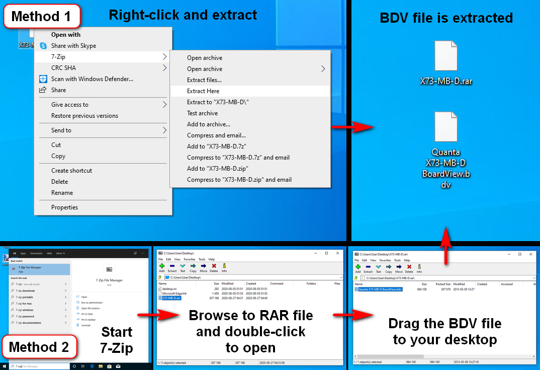

        Re: Hp Probook 455 G3 DAX73AMB6E1 blinking charge light, not turning on
        I've been rather busy (fixing my car among other things). Here's a quick 7-Zip tutorial I threw together though.
          Thank you, I'll give this a try. I'll be here when you have some time. Hope all goes well with those repairs.
            Finally got it to open with boardviewer,bdv . My daughter opened it up, and showed me how. Just looking things over. Is there 2 sides to the board view? Look forward to your return, Hope things are going well with the car repairs.
