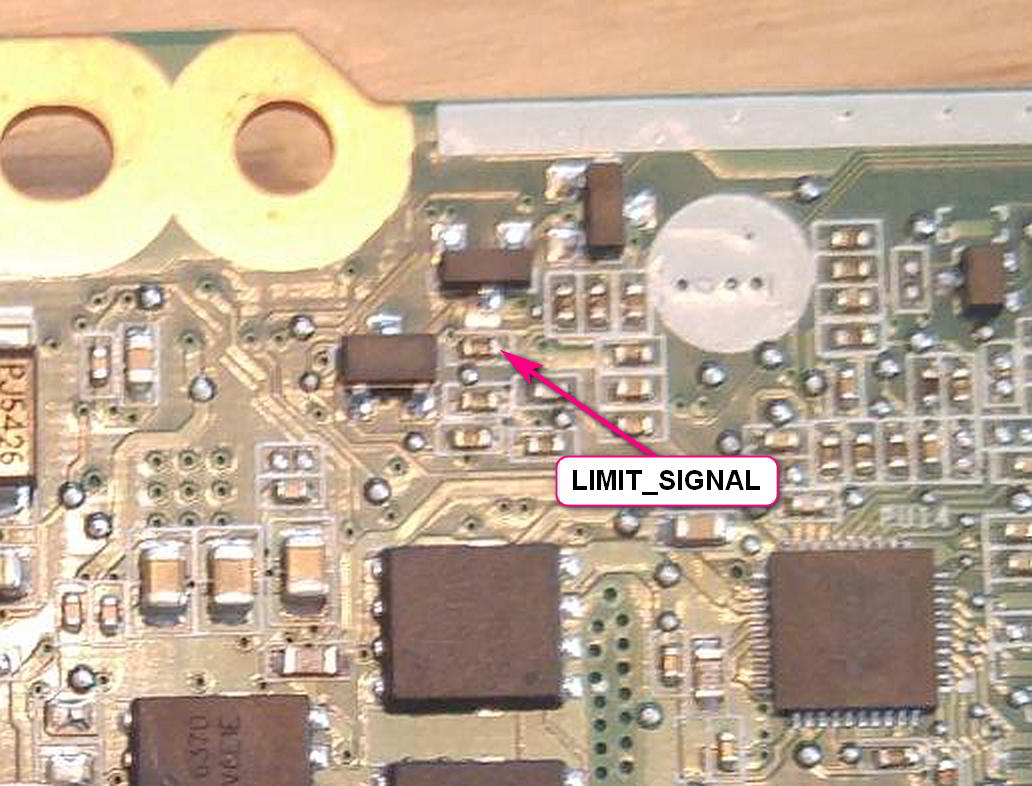

                                  Got some results for testing PL inductors. PL-25, 47.2 ohms, PL-16, 9.37K ohms PL-15, 65.6K ohms PL-12 27.89K ohms PL-11 169.9K ohms PL-18 16.1 ohms PL-17 28.1 ohms PL-21 21.1 ohms PR-103 3.97M ohms PL-6 22.87K ohms PL-1 1.369K ohms Will test other components later as my needle broke off of my meter probes, got to solder it back on.
                                    Re: Hp Probook 455 G3 DAX73AMB6E1 blinking charge light, not turning on
                                    So far nothing looks unusual. As a general rule, regular power rails should be in the kΩ range or higher, while CPU/GPU rails should be down around where your readings are (due to the leakage current from the huge number of transistors inside such devices).

                                        PQ9 results: Source to drain Pin1-0.535V , pin2-0.534V pin3-0.512V with opposite OL on all 3 pins. Gate to source all pins reading OL, no continuity! same with gate to drain, all pins OL, no continuity.
                                        PQ5 results: Source to drain Pin1-0.435V, Pin2-0.438V pin3-0.439V opposite OL on all three pins. Gate to source, and gate to drain all pins OL, no continunity. What would be next step?https://www.badcaps.net/forum/images/smilies/poof.gif

                                          Let's check the AC adapter. I think I mentioned this early in the thread, but I'll say it again. Plug it in and measure between ground on outside of the barrel and positive on the inside of barrel. It's okay to touch the center pin as long as you are also touching the inner surface of the barrel (otherwise you will probably get a reading that is about a volt too low).
                                          As long as the voltage is within reason (~19.5 volts) and stable, continue...
                                          Next, let's check some of the voltages with the power supply plugged in.
                                          Measure the voltage at the following components. You only need to measure one pin from each:
                                          PR103 (main +VIN power rail)
                                          PL12 (3V switching regulator output)
                                          PL15 (5V switching regulator output)
                                          Let's also check the 3V (+3V_ALW) and 5V (+5V_ALW) linear power rails, as well as the AC adapter identification signal (LIMIT_SIGNAL). See attached pics. Note that the arrow is pointing to one specific side of the indicated component.
