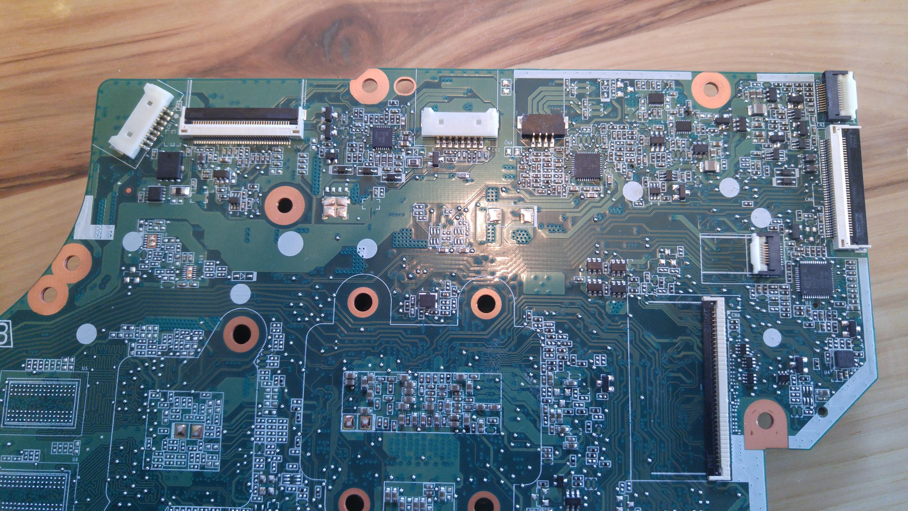

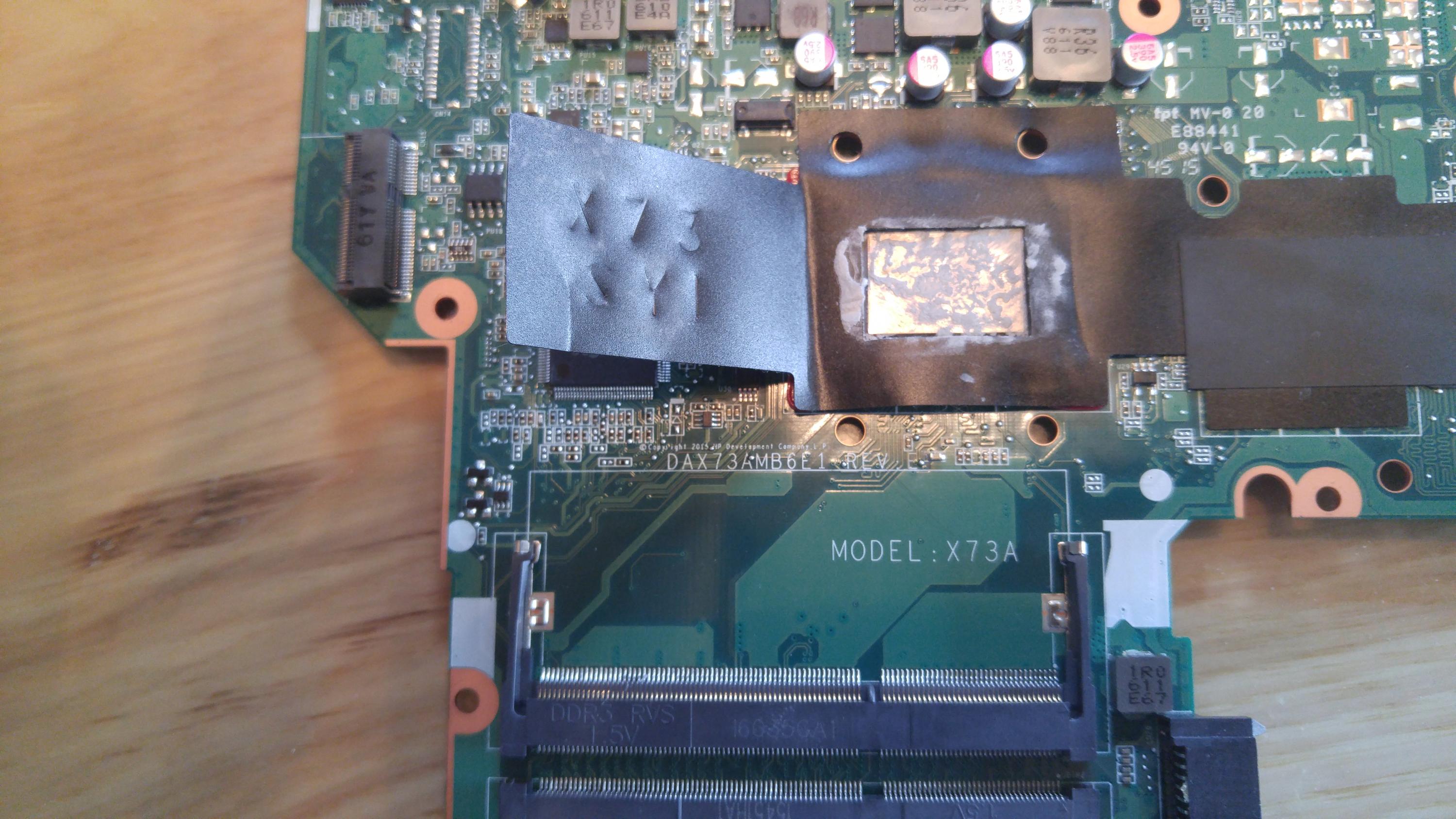

The schematic appears correct. You can confirm it by making sure it says "DAX73AMB6E1" on the board itself. You'll find that written near the memory slots on top of the board, and in the same area on the bottom of the board as well.Comment
Re: Hp Probook 455 G3 DAX73AMB6E1 blinking charge light, not turning on
every thing matches up, those are my schematics for my board, just can't read them. My parts should be in about 5 days or so. will get back to you then. thank you again for all your help.Comment

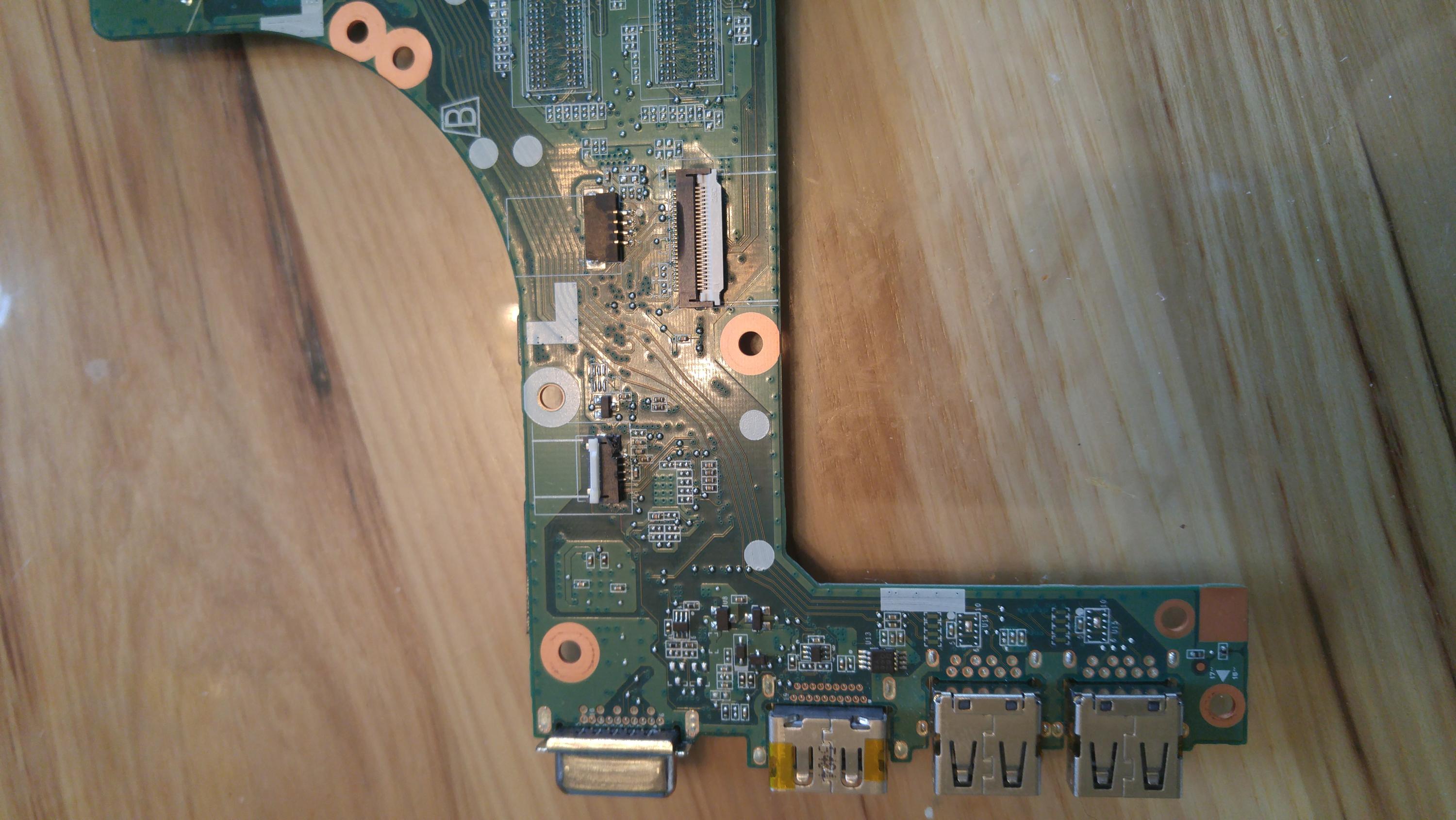

Ok, I'll try and load some clear pics of this board, can't open Rar file. Thanks guys for all the help. Keep in mind a complete noob here.Last edited by rccrasher65; 01-11-2019, 11:23 AM.Comment

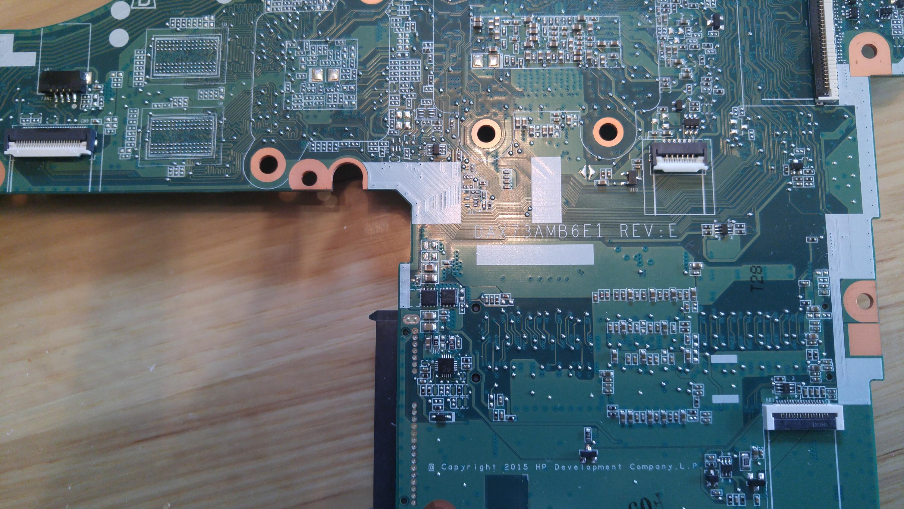

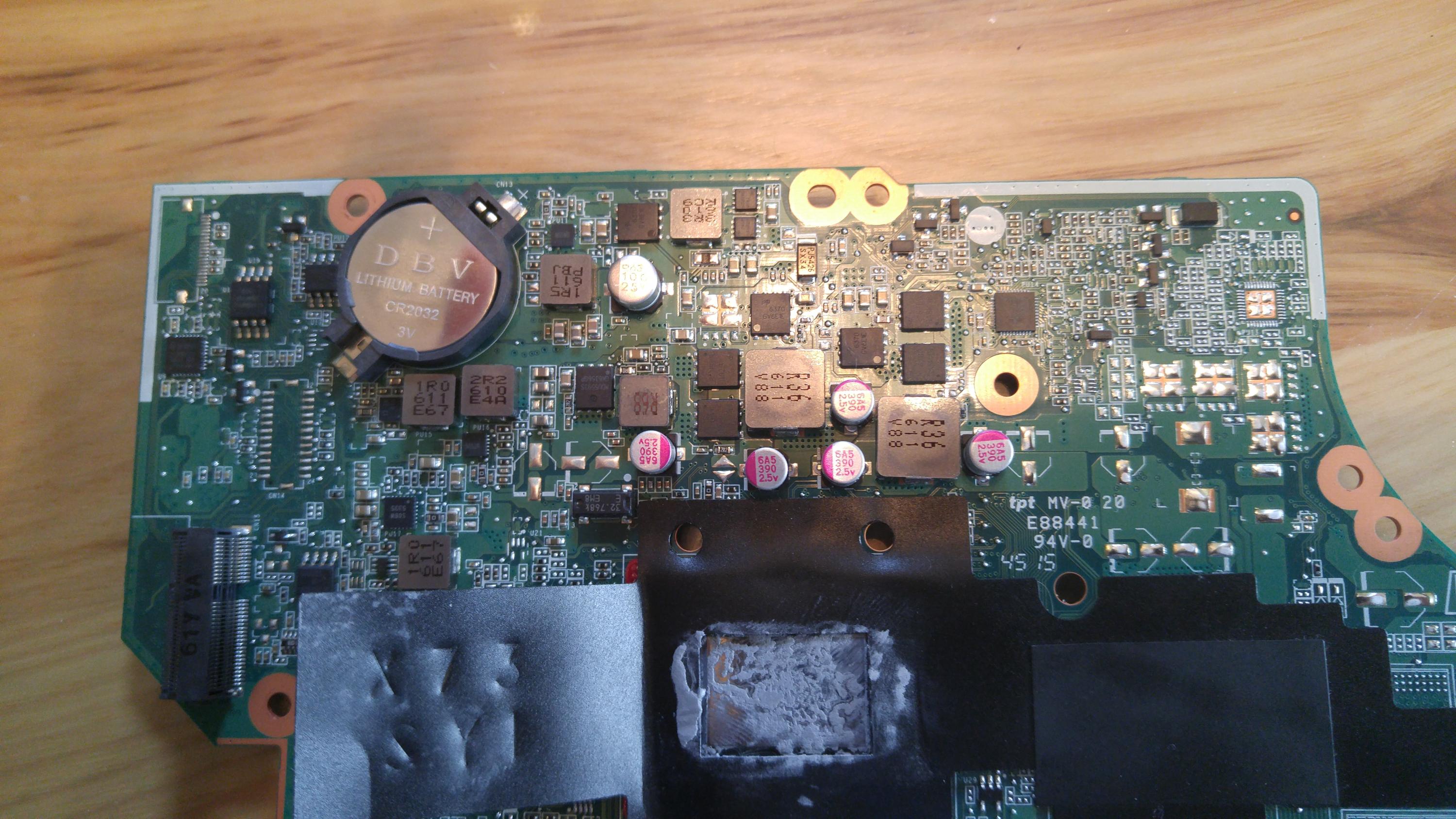

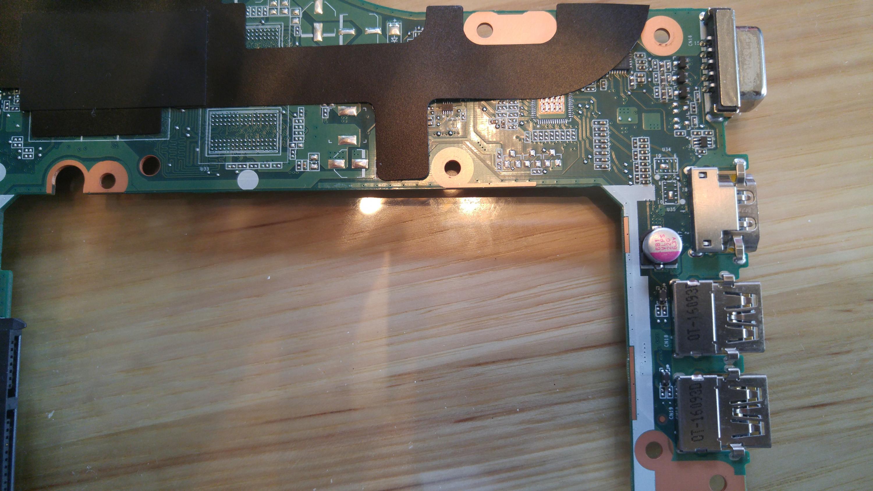

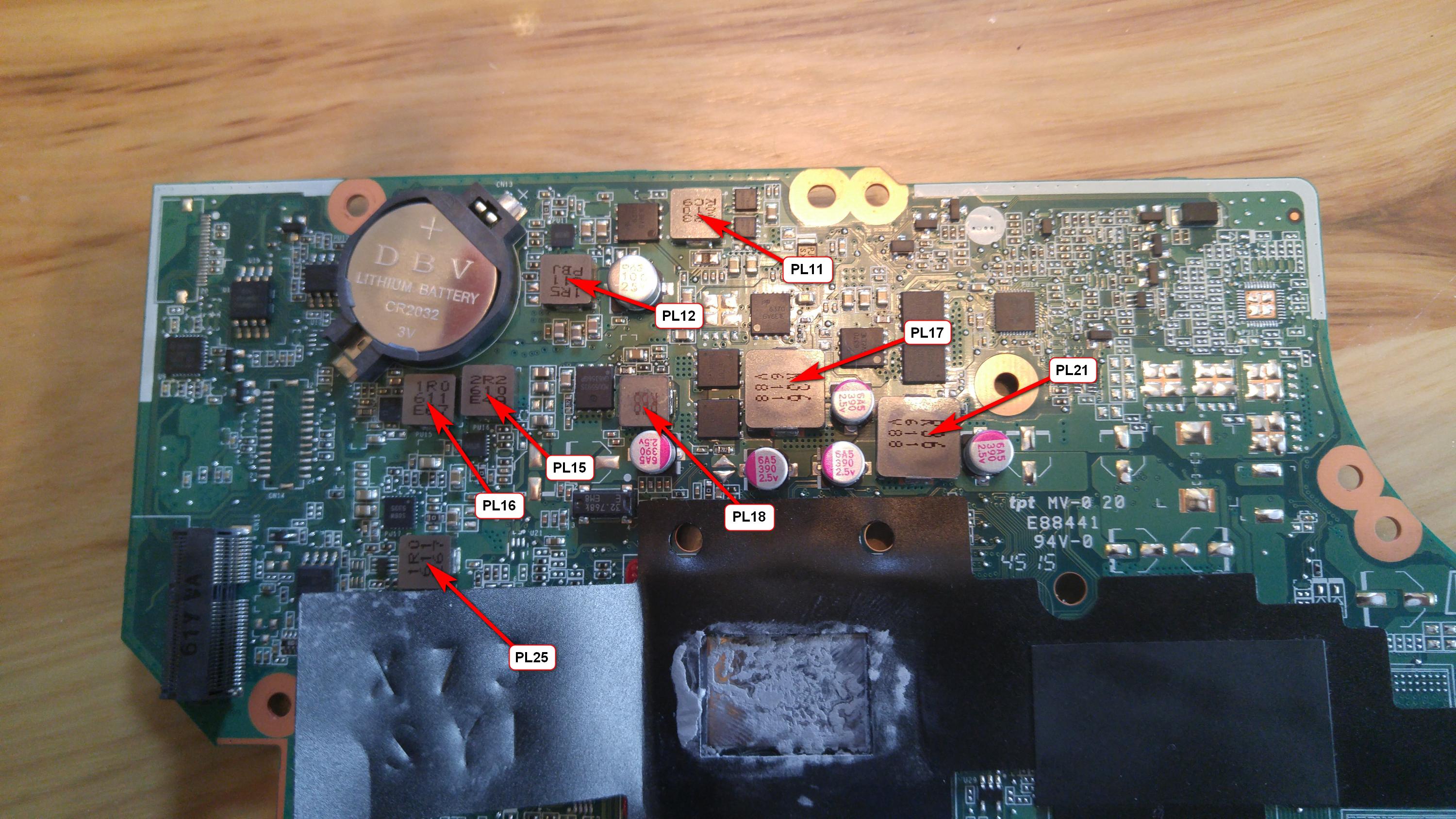

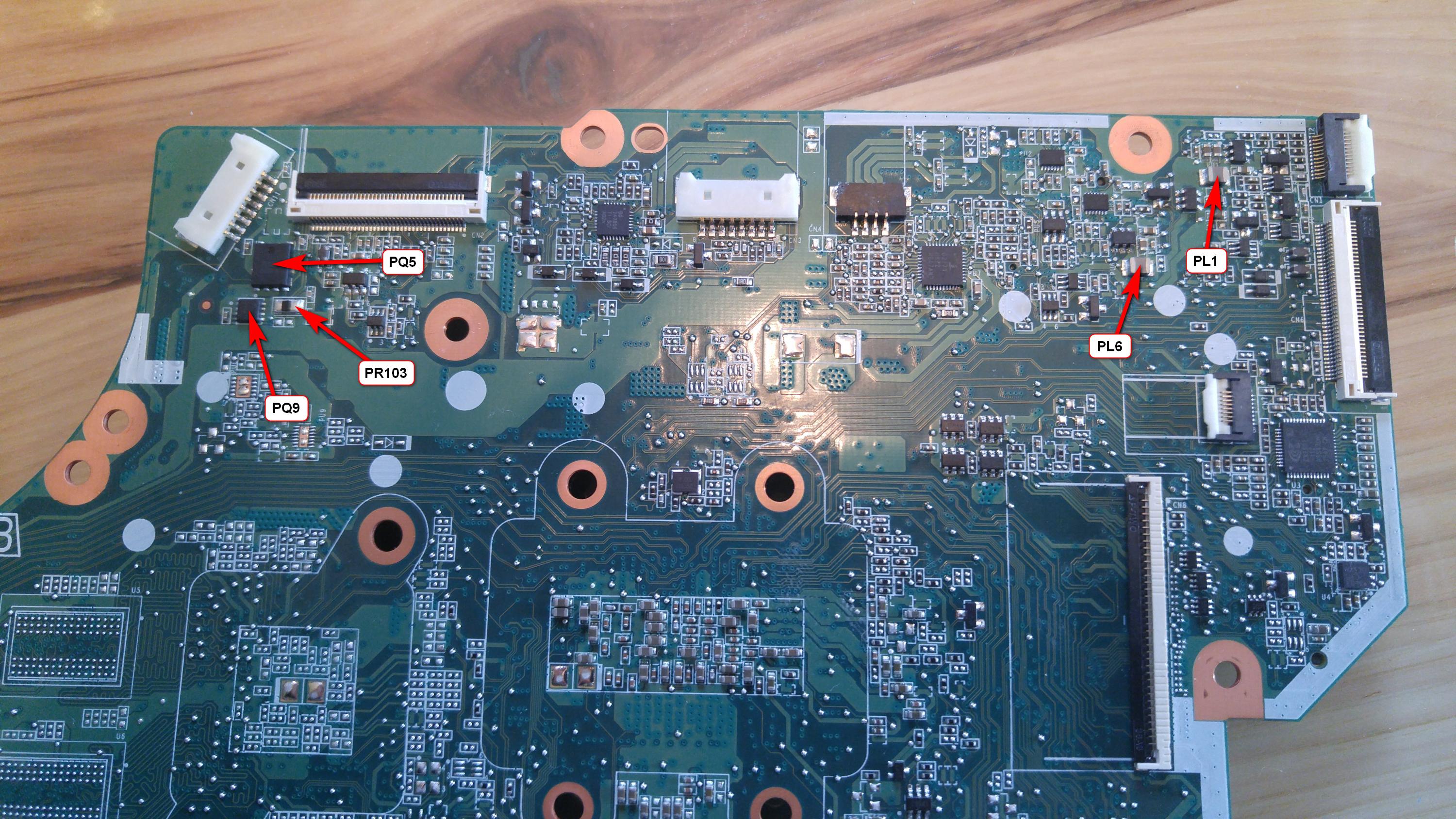

Alright, we may not get any interesting results with these tests, but there are only certain things that can be done easily until you have a way of powering the board.
Note: The part identifiers I will use are pointed out in the attached pictures #1-3. They are the same identifiers as the schematic and boardview.

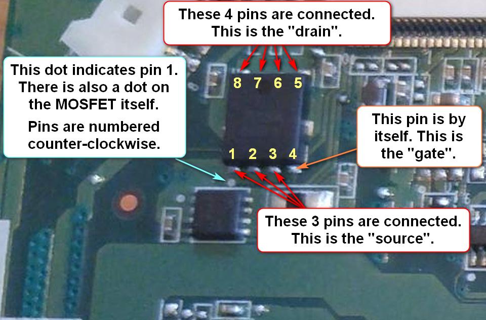

Step 1: Test input MOSFETs PQ5 and PQ9 for shorts (see pic #1).
A FET has 3 connections: source, drain, and gate. Typically, they are 8-pin components. Pins 1-3 are the source. Pin 4 is the gate. And pins 5-8 are the drain. The correct voltage on the gate will allow current to flow through the FET in either direction between source and drain with very low resistance. However, current can flow in one direction (but not the other) even when the FET is switched off. This is due to the "body diode" inside the FET.
They can't be tested with complete reliability while still soldered to the board, but we can give it a go.
Use your multimeter in "diode mode" (Very important. Usually has a diode symbol next to it --|>|-- ). Test between source and drain. Then swap the probes and test again. One way should have a low reading. The other way should have an infinite reading. But again, there might be interference from other connected components on the board.
Next, test between the gate and drain. Then the gate and source. It doesn't matter which probes you use. There should be no continuity at all.
All measurements are in volts. Specifically, the meter is telling you how many volts it took make a reference amount of current to flow. Most regular diodes (the FET body diode included) are approximately 0.3V-0.6V, give or take, depending on type of diode and how much current is flowing.
See attached pic #4 for reference.
Step 2: Test power rails for shorts to ground.
For all the inductors (everything with a "PL" prefix in the name in pics #1-3), measure the resistance between the inductor and ground. Both sides of the inductor should give the same reading. You can use the copper around any nearby screw hole as your ground.
Do the same thing for P103 (see pic #1)
The measurements are in ohms.
For all measurements, make sure to scrape/twist against the metal of the pins very gently just to ensure you are touching bare metal. Thin oxide layers can skew the readings sometimes.
Later, we can do voltage measurements with the board powered up. It's also possible there is an issue with the firmware/BIOS. But we'll cross that bridge when we come to it.Attached Filesif you find these attachements useful please consider making a small donation to the site

I have some results, PL28-308.3 ohms PL25-50.0 ohms PL16-9.63k ohms PL15-0.4 ohms PL12-0.4 ohms PL11-191.2k ohms PL18-17.0 ohms PL17-30.1 ohms PL21-25.0 ohms measurement are the same on both sides of the inductors, give or take a few points. I will get the rest on Mon. can you label fet PQ5 I'm not sure I have pins right. Thank you!Alright, we may not get any interesting results with these tests, but there are only certain things that can be done easily until you have a way of powering the board.

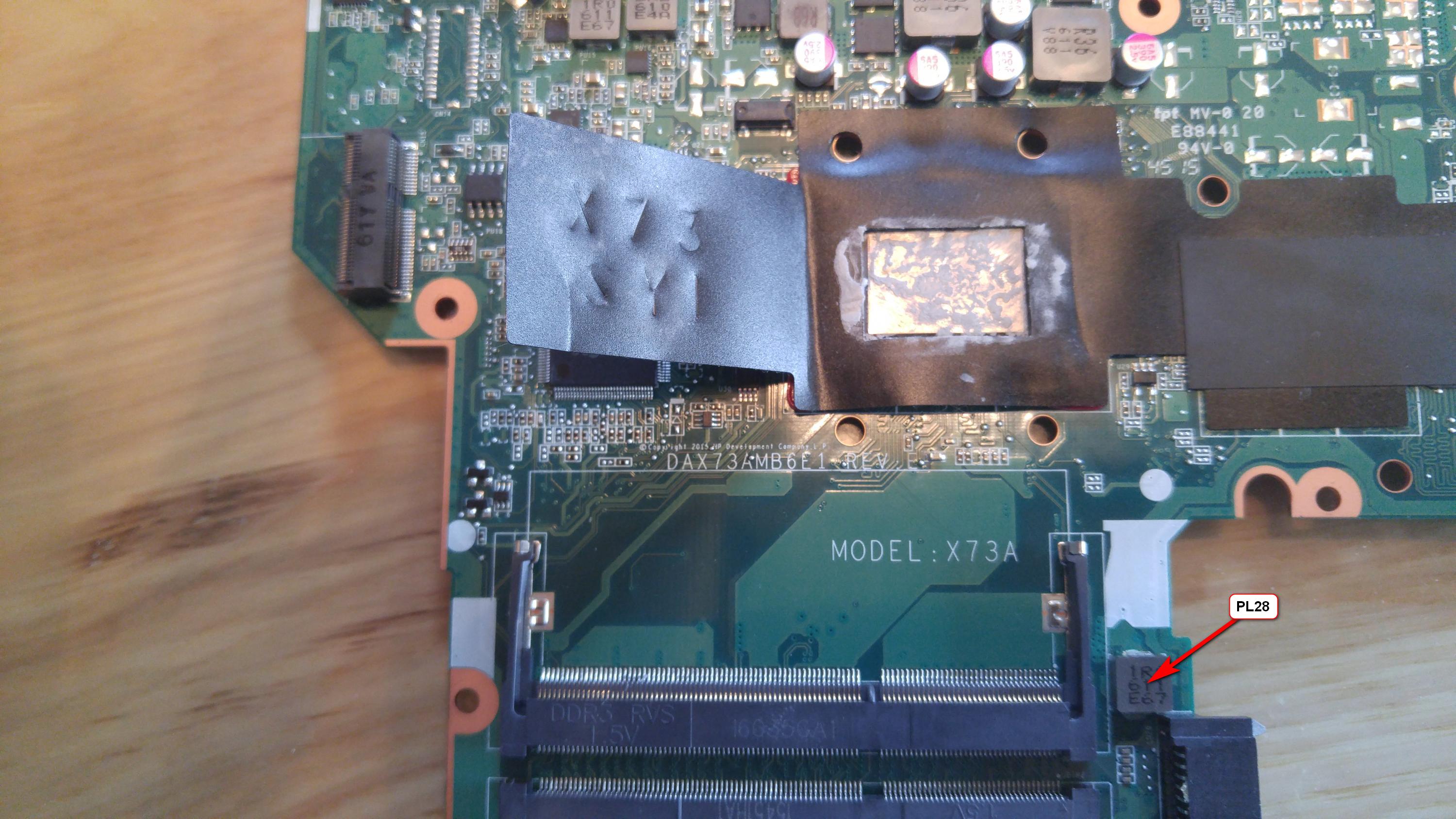

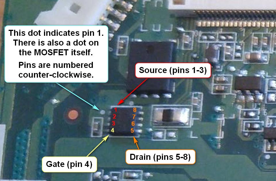

The pins for PQ5 are numbered in pic #4, so I assume you meant PQ9. See attached pic #5.
All you need to do is find the dots that show you where pin 1 in located. Then start counting counter-clockwise. This board has white dots on the board itself. But, even without those, there is a dot near pin 1 on the actual chip. Or, in some cases, they will have a notch or marking on that side of the component.
All those measurements look okay.. except PL12 and PL15. Let's double-check those with a different technique. Place your multimeter in diode mode, then put the red (yes, the red) probe on ground and the black probe on PL12 and PL15. The reading will be in volts.
One other step I should have mentioned is to just scan over the whole board carefully and look for anything suspicious. Sometimes the bad component is just staring you right in the face.
Some things to look for:
- Corrosion or residue on the board or component pins
- Physically broken components
- Components with craters or bulging/brown spots on them
- Cracked/loose solder jointsAttached Filesif you find these attachements useful please consider making a small donation to the site
