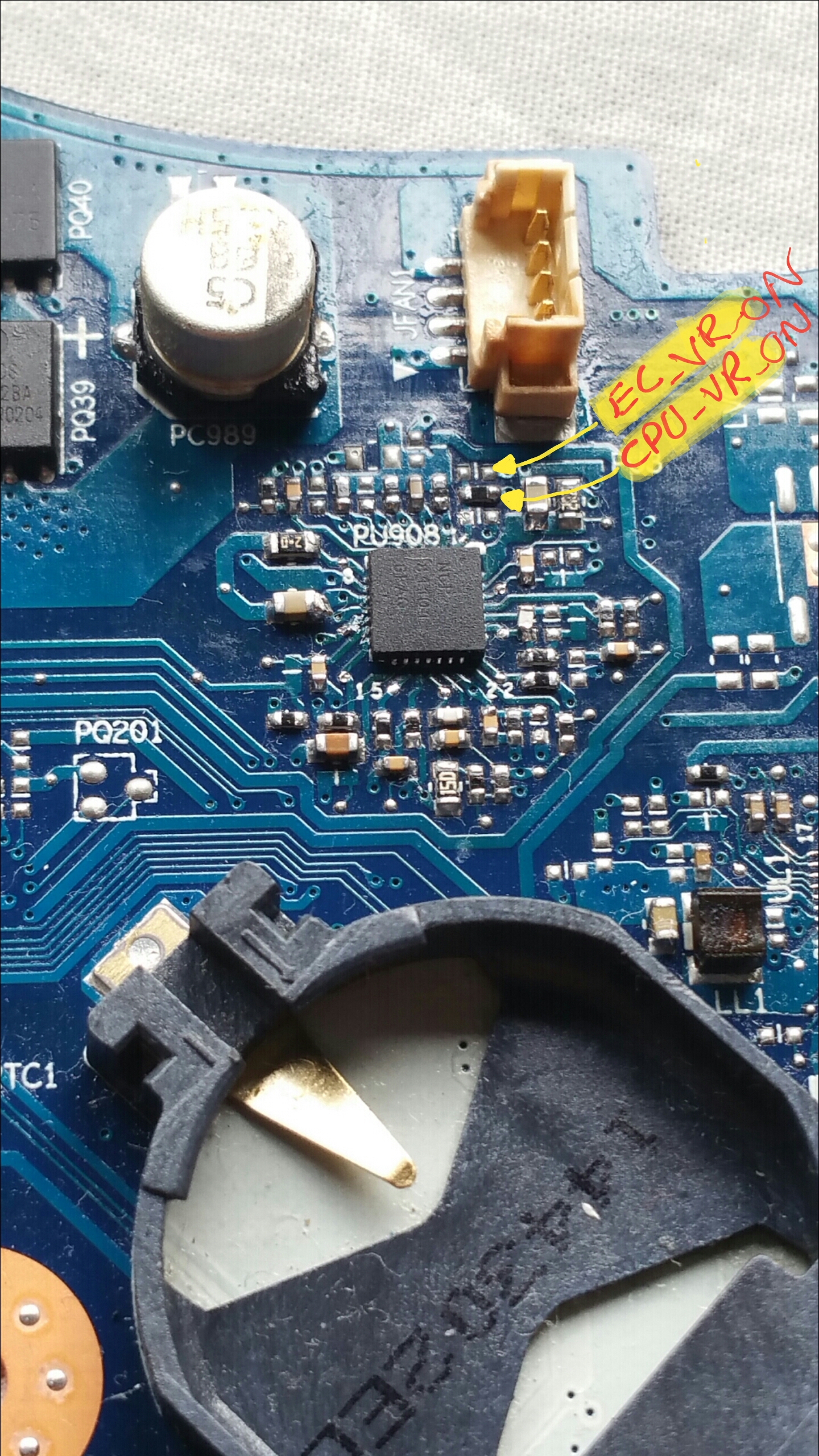

    I need help to trace the cpu_core signal as it is missing while all other voltages are present.
    There is no 0volts at pin1 of the PU908 controller. I have changed the controller but still no luck. I have programmed the bios and the EC but same issue. The 5v source voltage is present in the PU908 controller. But there is no cpu_core signal.
    I would appreciate any advise.

            check which one of EC_VR_ON and CPU_VR_ON is missing?
              Re: Cpu_core signal missing. Lenovo g50. Help?
              The cpu_vr_on is missing. 0v at pin1.
              The EC_VR_ON is not connect to pin 1 as there is no fuse or resistor to connect it to pin 1.
              Please check the attached pic
                Probably, the problem is not related to PU908. Now measure voltage on Pins 97, 99, and 107 of IT8586E.
