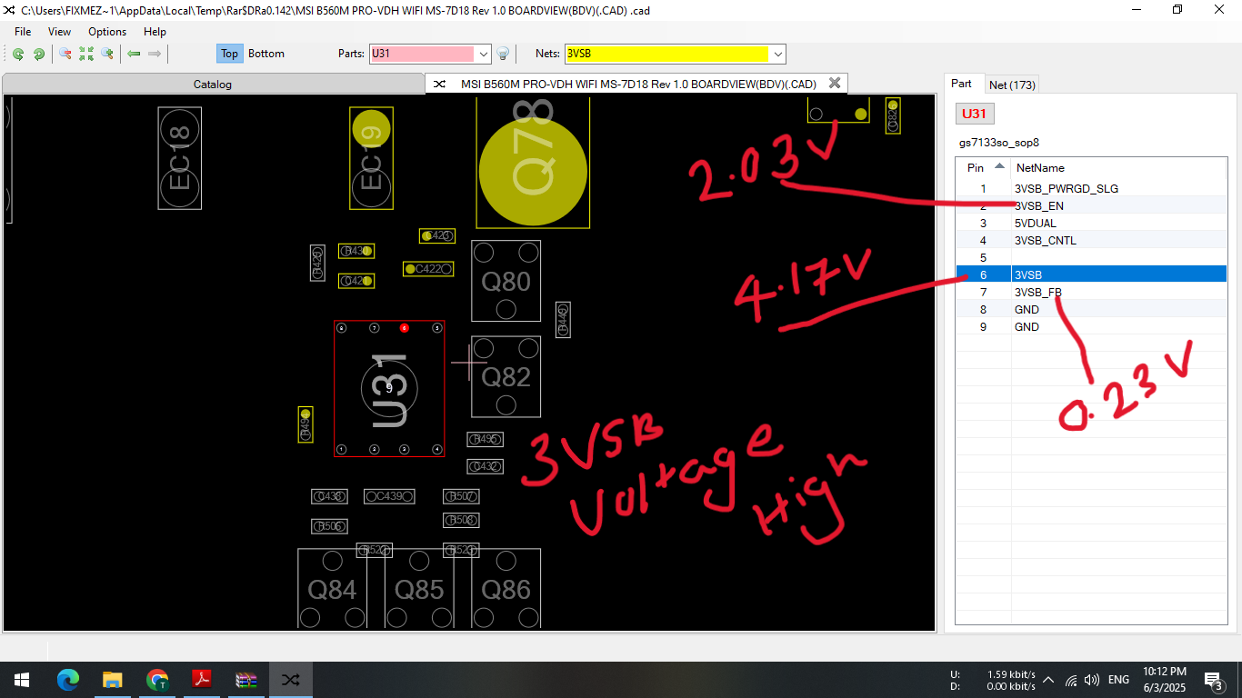

    MSI mpg b560m bazooka motherboard RSMRST# signal missing
    I have MSI mpg b560m bazooka motherboard . this motherboard RSMRST# signal missing . i already reprogram bios but same condition
    My Motherboard this power stages are ok ...but 3vsb voltage have 4.17v (image added)
    VCCRTC ok
    RTCRST# ok
    ATX_5VSB ok
    SIO_3VA ok
    3VDSW ok
    DPWROK ok
    SLP_SUS# ok
    VSB_ENABLE# ok
    5VDUAL ok
    3VSB showing 4.17V
    PCH_1P8_VSB ok
    PCH_VCCIN_AUX ok
    RSMRST# No voltage
    this all voltages are ok but RSMRST# voltage is missing i did try to re program bios and change io but same condition and have another problem . this motherboard 3vsb voltage little bit high . showing 4.17V. i did change regulator ic but same condition anyone have a solution ?

    finally i found the problem ... the problem is my 3vsb regulator ic feedback resister divider .... replace divider resistor correct value . my 3v standby voltage are 3.3V Ok ....RSMRST is produce
