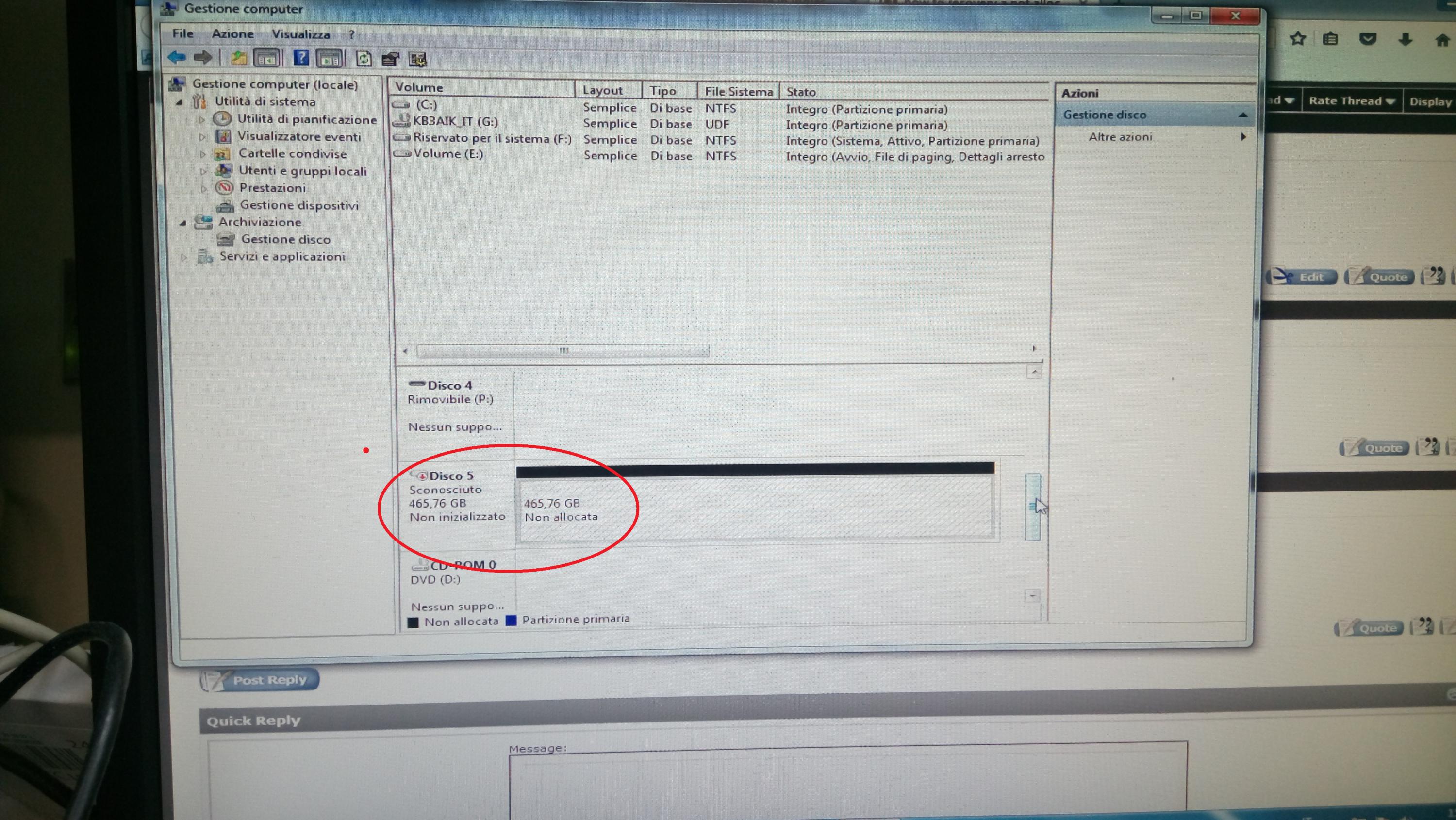

how to recovery a not allocated hdd
    without loss any data?
    This hdd suddenly result not allocated when i use disk manager.
    Tks to all in advance
    Re: how to recovery a not allocated hdd
    first try a scandisk with /F parameter. sometimes it restored hdd functionality.
    if that didnt help, u can try partition recovery.
      Does it show correctly in BIOS settings?
          Could be HPA.
              Originally posted by Pragmatiko View Post
              pls see
              Looks like the partition was wiped!
                Can you show us the contents of sector 0? That's where the partition table lives.
                You can use a freeware disc editor such as DMDE:
                http://dmde.com/
                Can you show us DMDE's partitions window? If all that you have done is to "initialise" the drive, then the fix should involve only a few clicks in DMDE. I can help you with this if need be.
                    IMHO I would not start by throwing all kinds of data recovery software at the problem. Instead I would patiently examine the damage with a disc editor (in read-only mode) before deciding on a course of action. IME in the storage forums, users often accept Disk Managent's offer to initialise a drive, not realising that this procedure is data destructive. The solution in such cases is to rewrite the partition table with a partition recovery tool. DMDE can do this in a couple of mouse-clicks.
