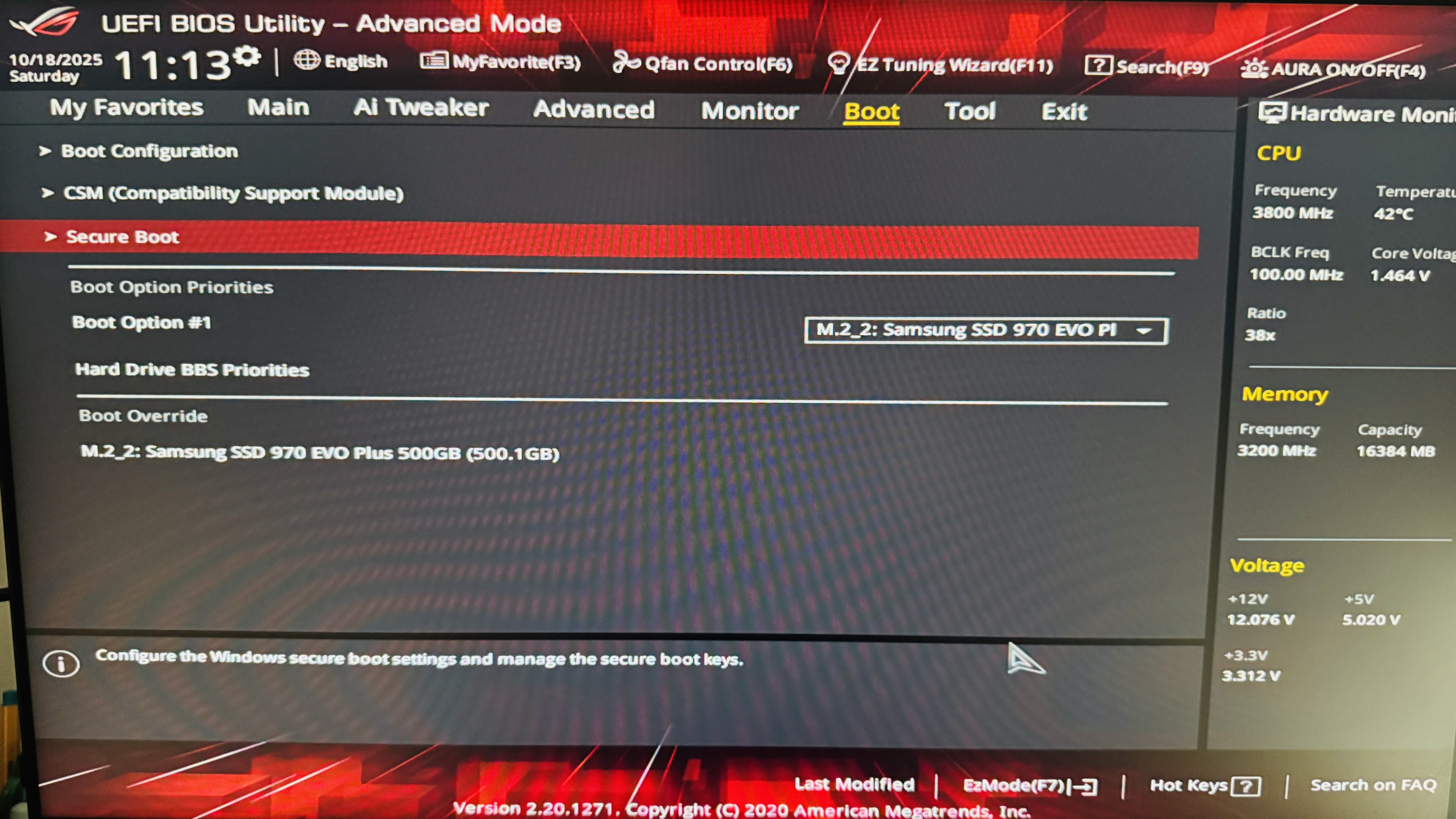

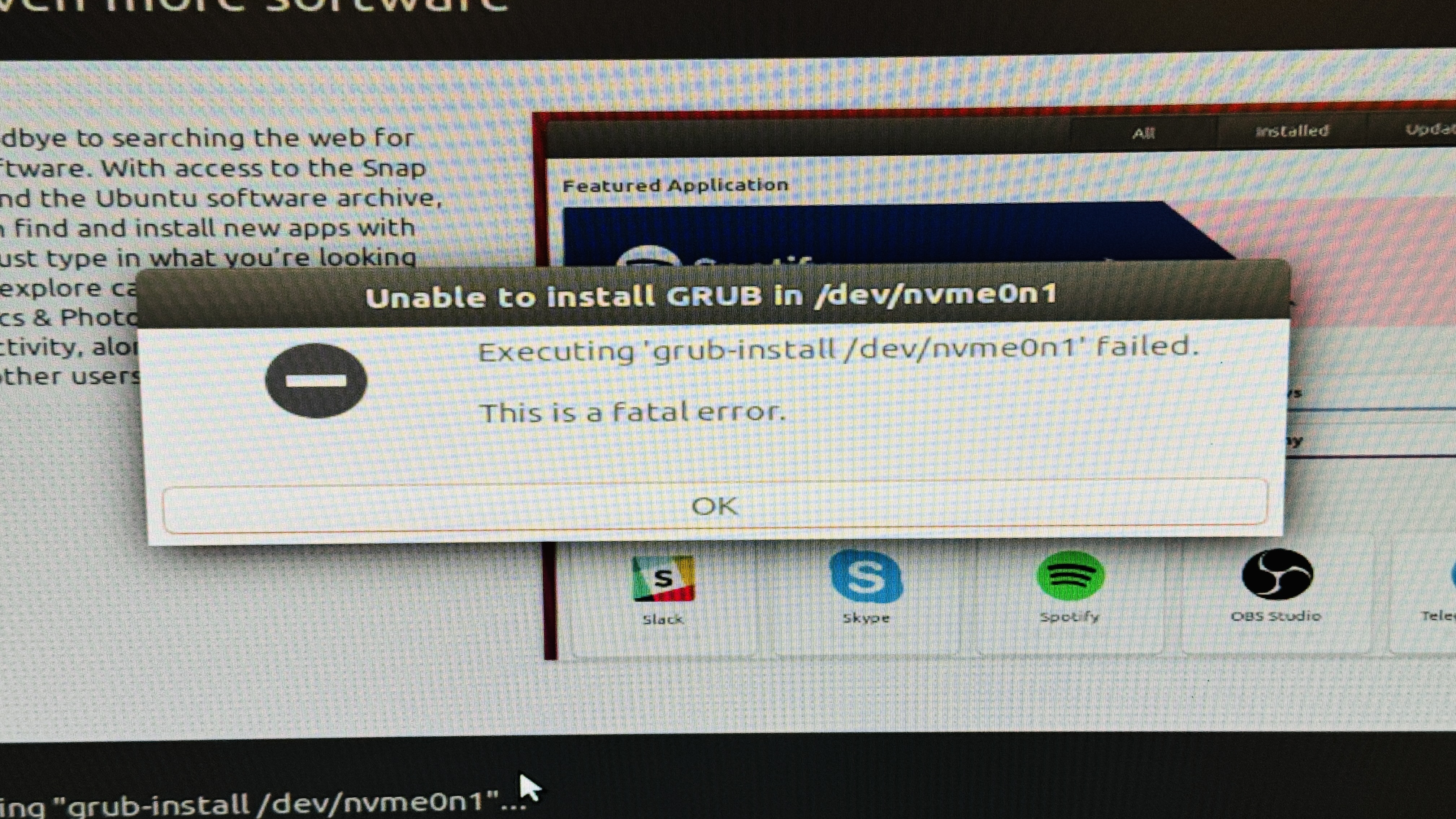

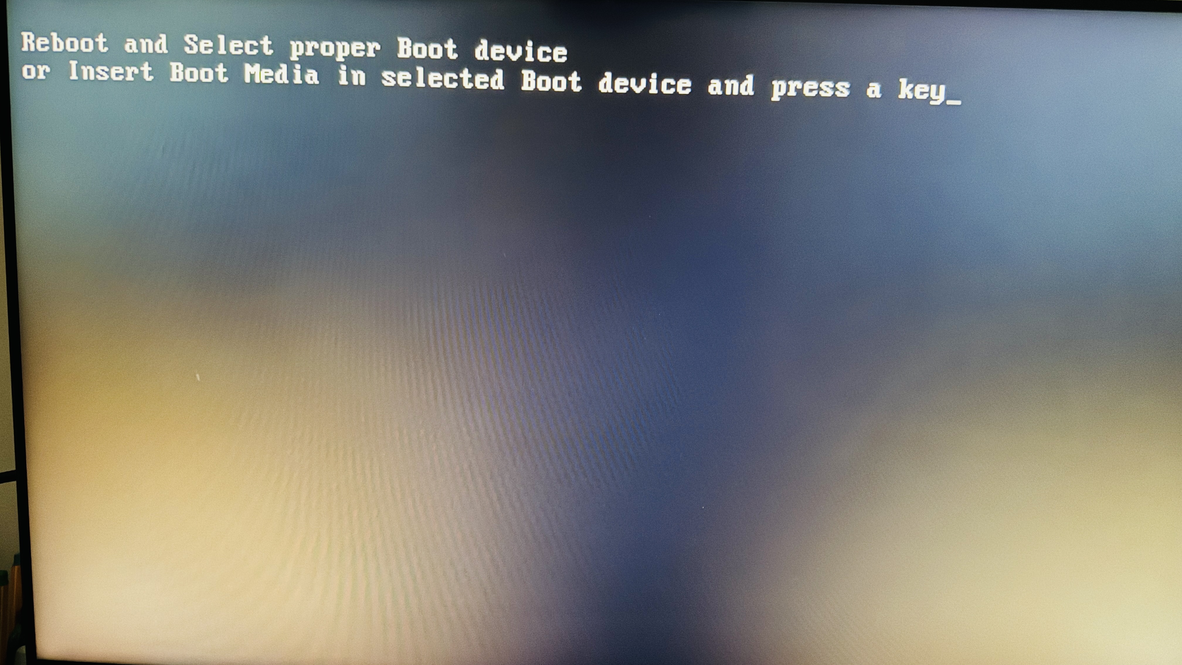

    I tried to install Linux on a secondary disk in my PC and after a failed Linux grub installation my PC didn't boot in Windows 11. I saw the message (Reboot and select a proper Boot device).

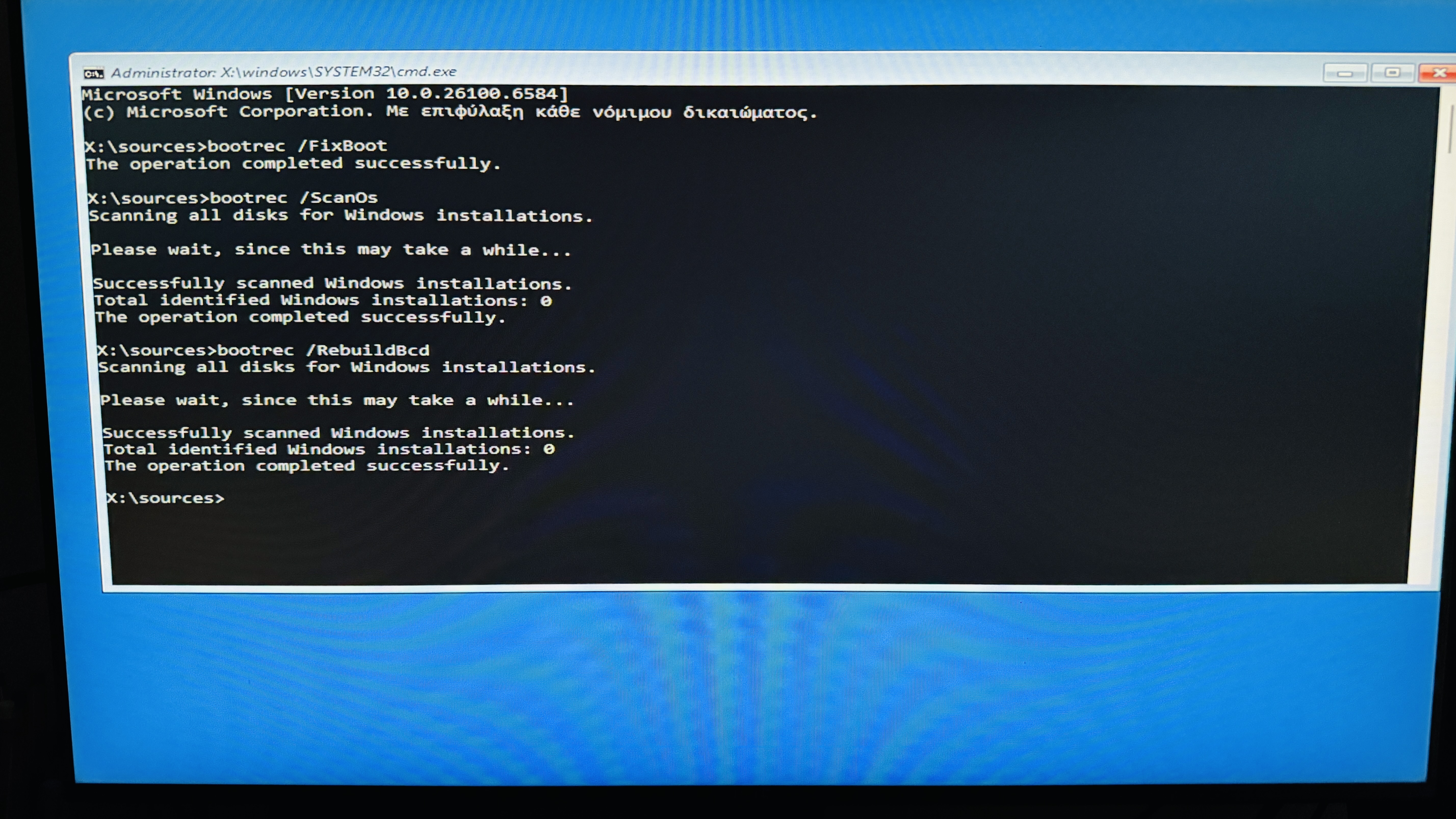

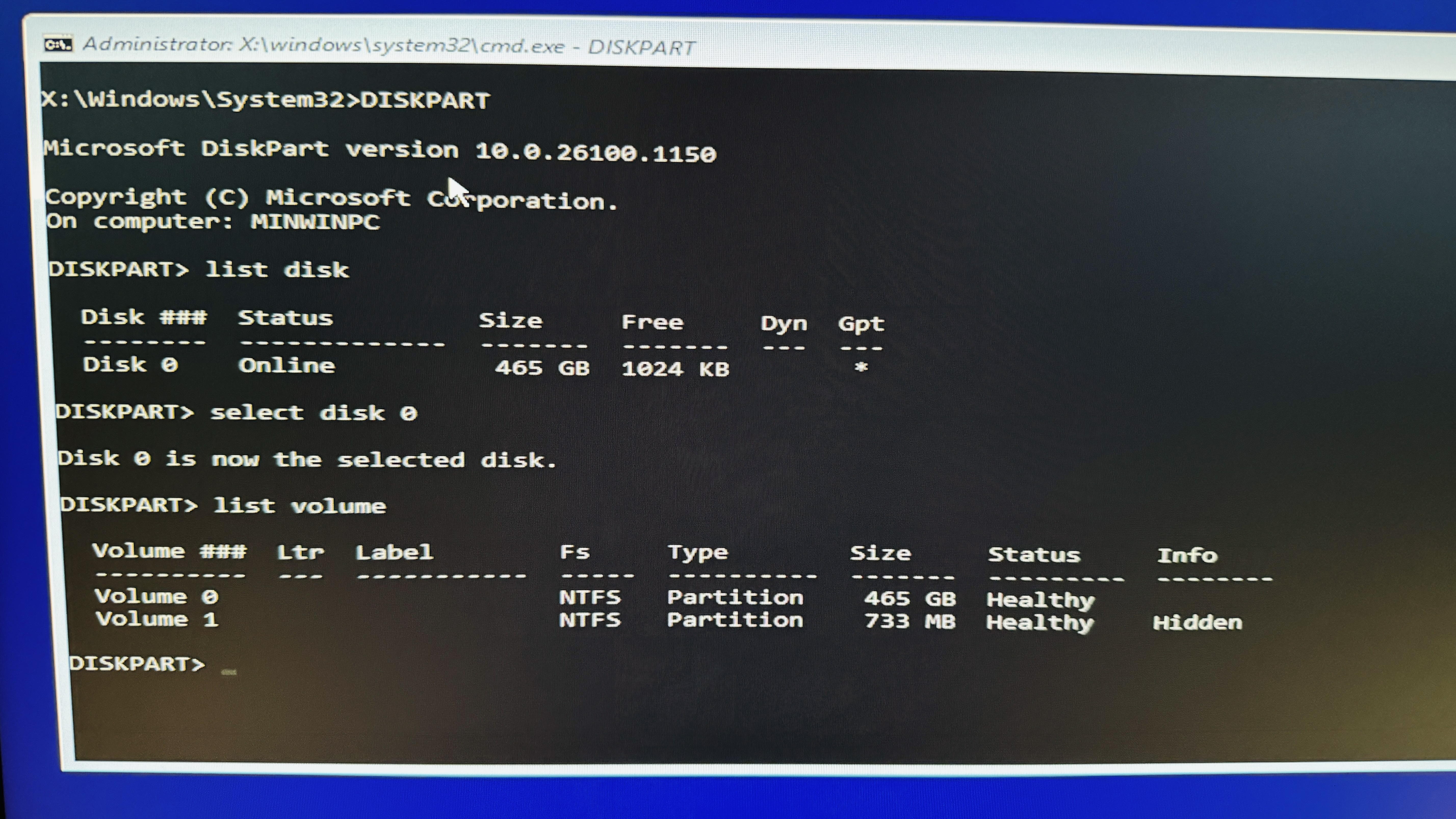

    I made a bootable USB windows 11 and I run the below commands on the cmd but with no succeed.
    DISM /Online /Cleanup-image /Restorehealth
    The DISM.... command shows me the error 87.
    sfc /scannow
    chkdsk
    bootrec /FixBoot
    bootrec /ScanOs
    bootrec /RebuildBcd
    For some reason it writes(Total identified installations 0) like there no windows in the nvme disk.
    How can I repair my disk?

    did the linux installer say that grub failed?

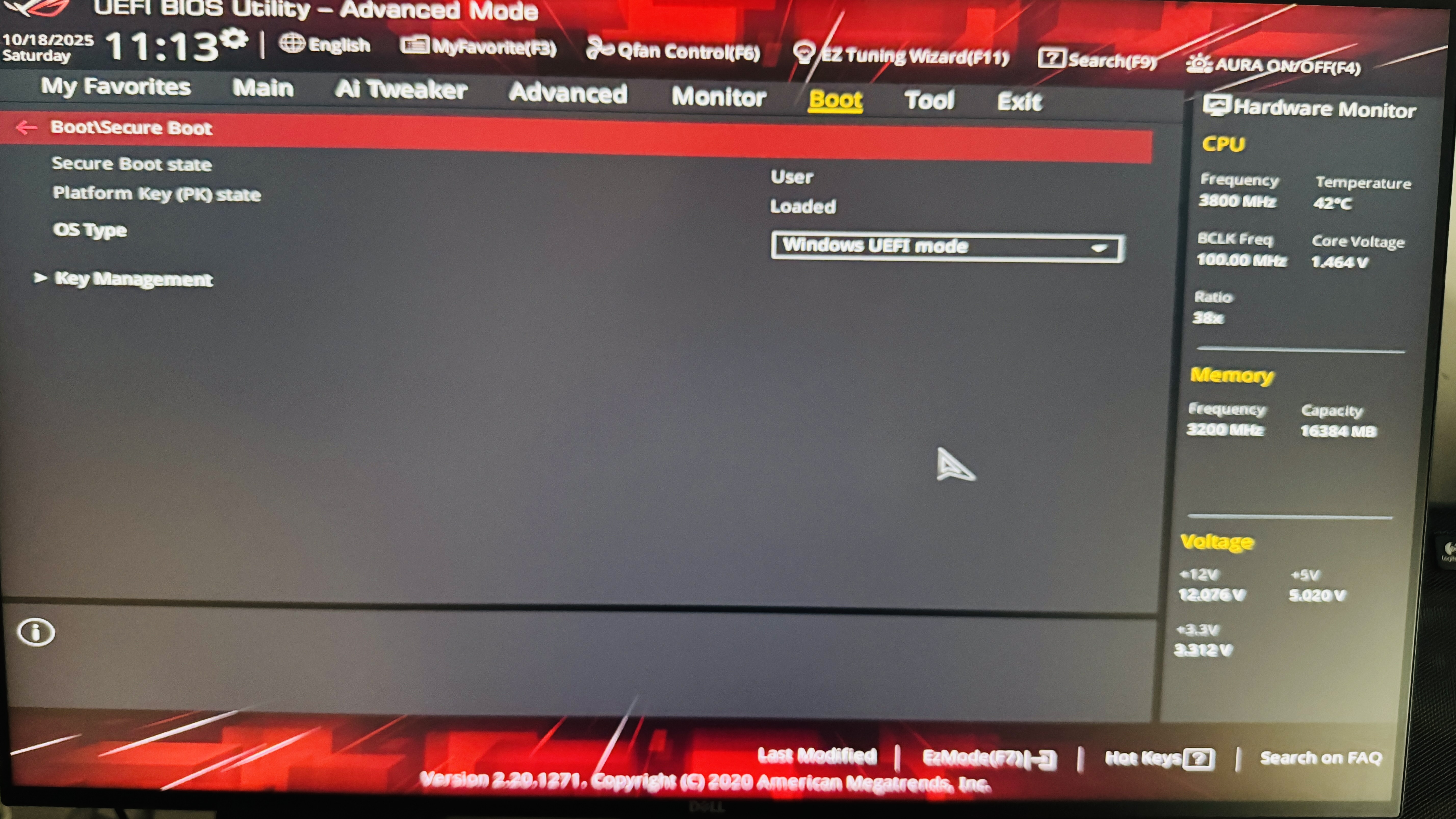

    you dont have secure-boot enabled in the bios do you?

      Yes the linux installer said that.
      I have a secure boot as I saw in bios (attached pictures).
      Now I have disconnect and the linux disk and the only disk in my PC is the windows 11 disk only.

        Try boot repair disk. That used to fix mine a while back.
