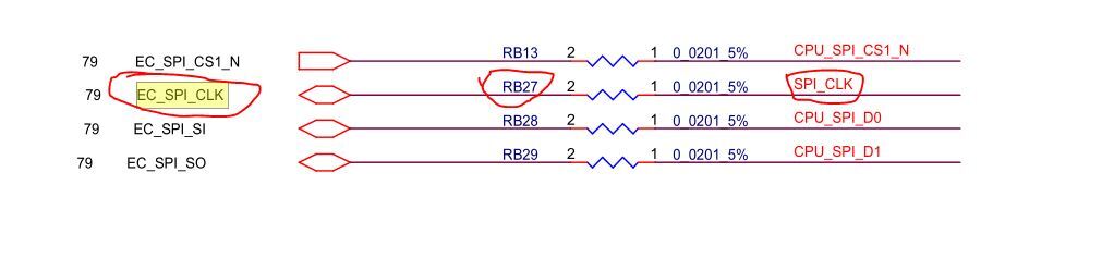

                                ROM_SPI_CK on BIOS pin #6 is 0.01v... something funky going on

                                      • 21845
                                      EC_SPI_CLK

                                      • questore
                                        • Dec 2015
                                        • 563
                                        • csongrád
                                        Originally posted by SMDFlea
                                        EC_SPI_CLK
                                        Click image for larger version  Name:	Capture.jpg Views:	0 Size:	23.8 KB ID:	3717444
                                        Already checked and it is connected. also got 10k resistance to 1.8v ALW.
                                        Tryed a lot of BIOS from here and all of them gives SPI pin 0.011mV but one I found is giving me 1.45v on SPI pin (still NO POST)
                                        attached the BIOS but I dont know what it means.
                                        Also tryed BIOS from davidebeatrici 's post same 0.011mv
