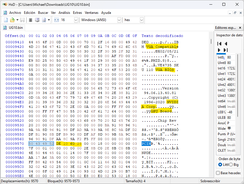

      Sorry but UG10 is GPU VBIOS for RTX 3060 PCI ID 10DE:2560
          This board has a 3060 Rtx
            Oops... thank you for checking. I just verified both boardview and schematics, UG10 is indeed the GPU BIOS and there is no separate chip for the EC unfortunately.

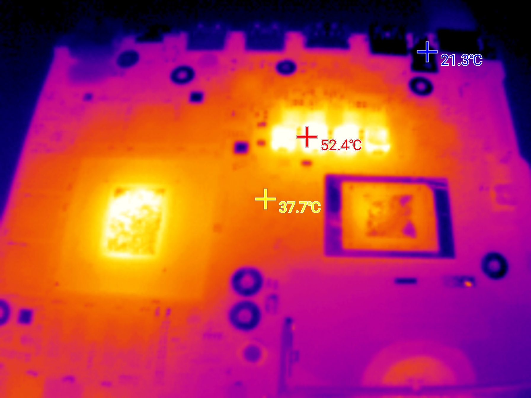

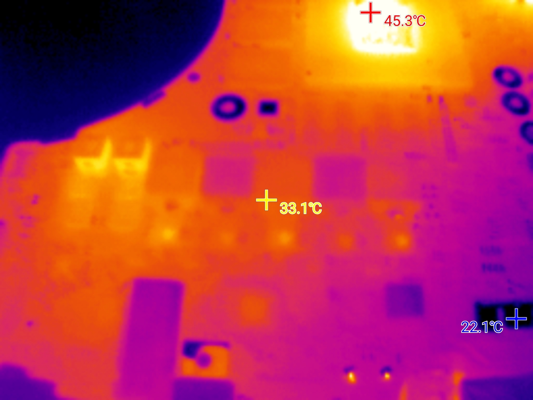

                        more digging around the board:
                        - I have noticed that PU2002 GPU mosfet is way to hotter then the rest (57C degree when others after turned on are 46Celsius, coil also hotter then the rest)
                        - BIOS SPI_CLK pin has a capacitor next to it that is missing CB21 (maybe for filtering and that is why i cannot read onboard with the clip only 1/20 times?)
                        I only have a boardview for REV0.4 and its optional but who knows in REV2.0 maybe its mandatory and that is why the board cannot boot because EC cannot communicate with it properly?

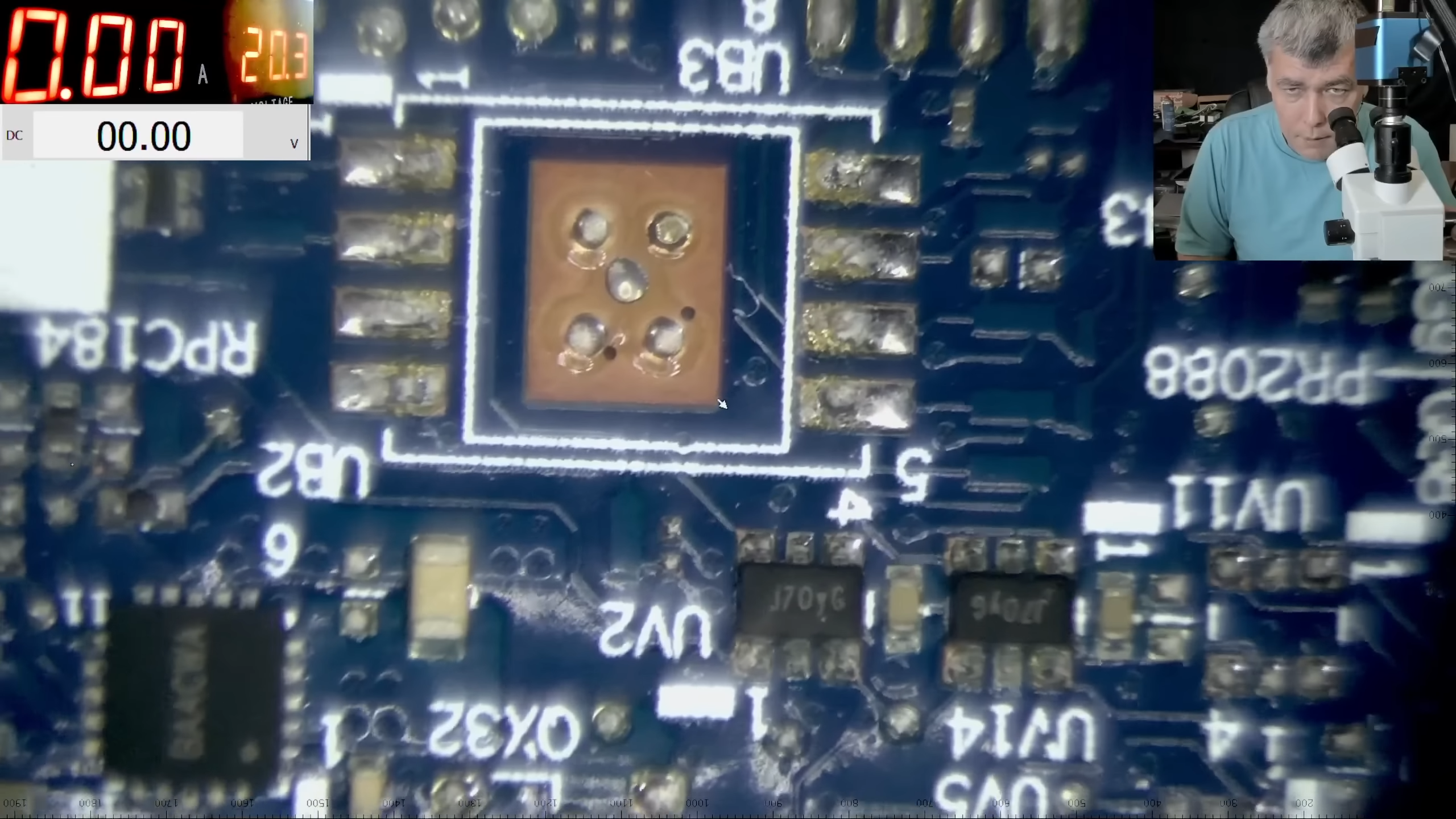

Name:	Lenovo Legion 5 15ACH6H dead after windows updates - Sadly, laptops are dying after windows updates 7-52 screenshot.png

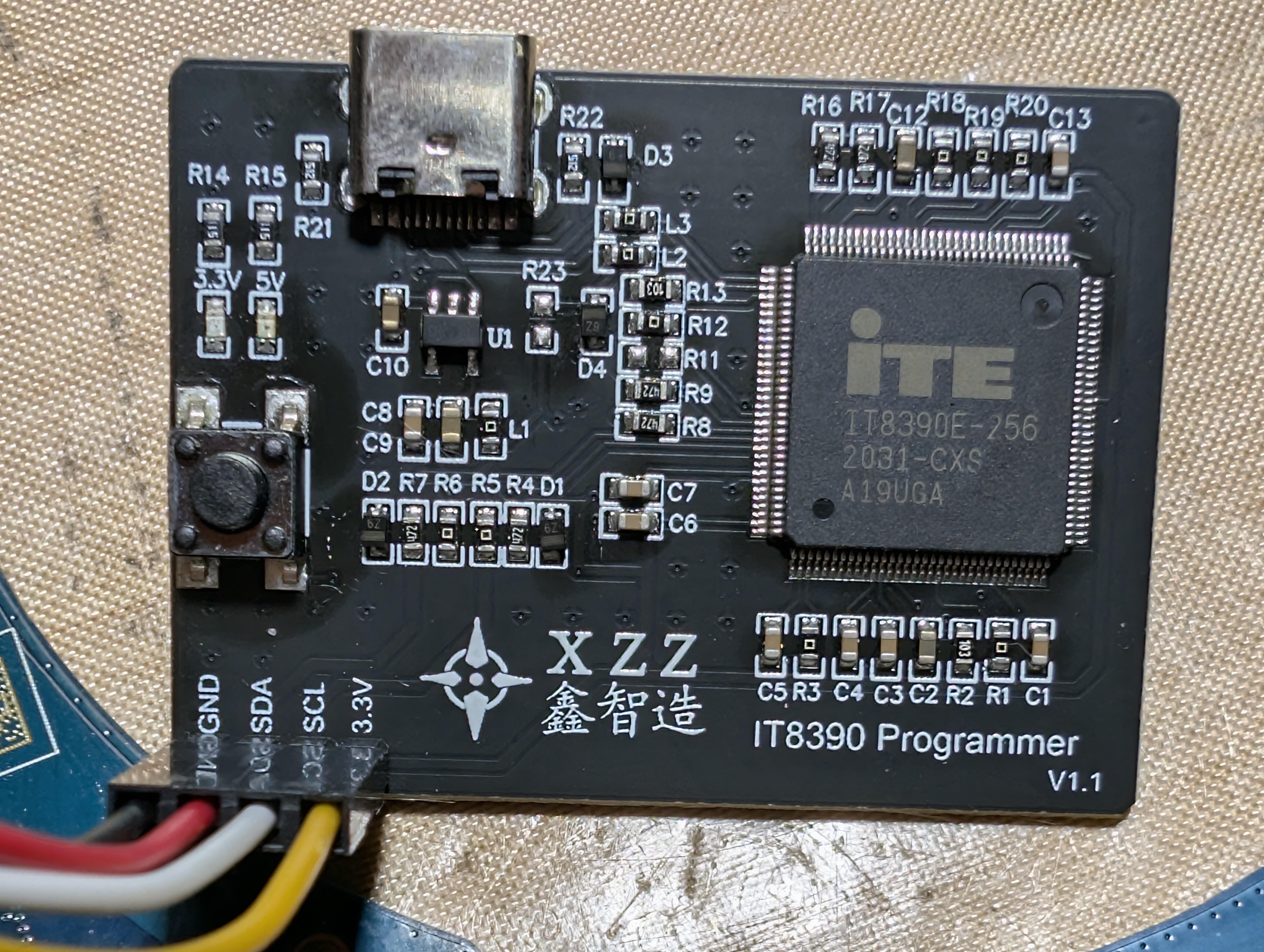

                                  I have an XZZ IT8390 programmer, I could try to reflash the firmware if I can find it somewhere.
                                    I got a firmware. Try it.
                                    If XZZ IT8390 can program trought I2C then tell me how and i buy one

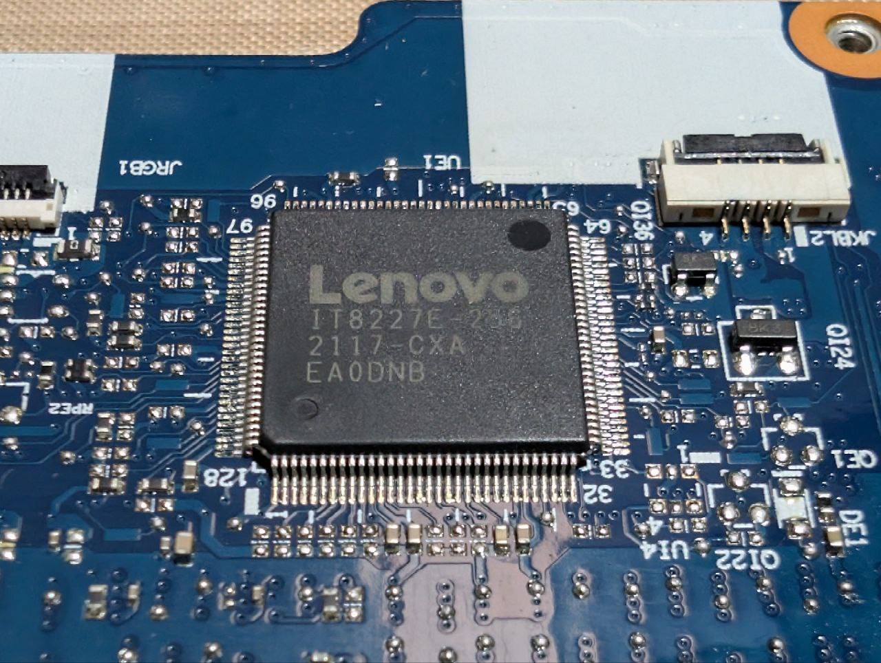

                                      According to both schematics and boardview the EC chip should be a IT8227E-192, but here it's a IT8227E-256, I'm assuming the firmware is still 192 KB.

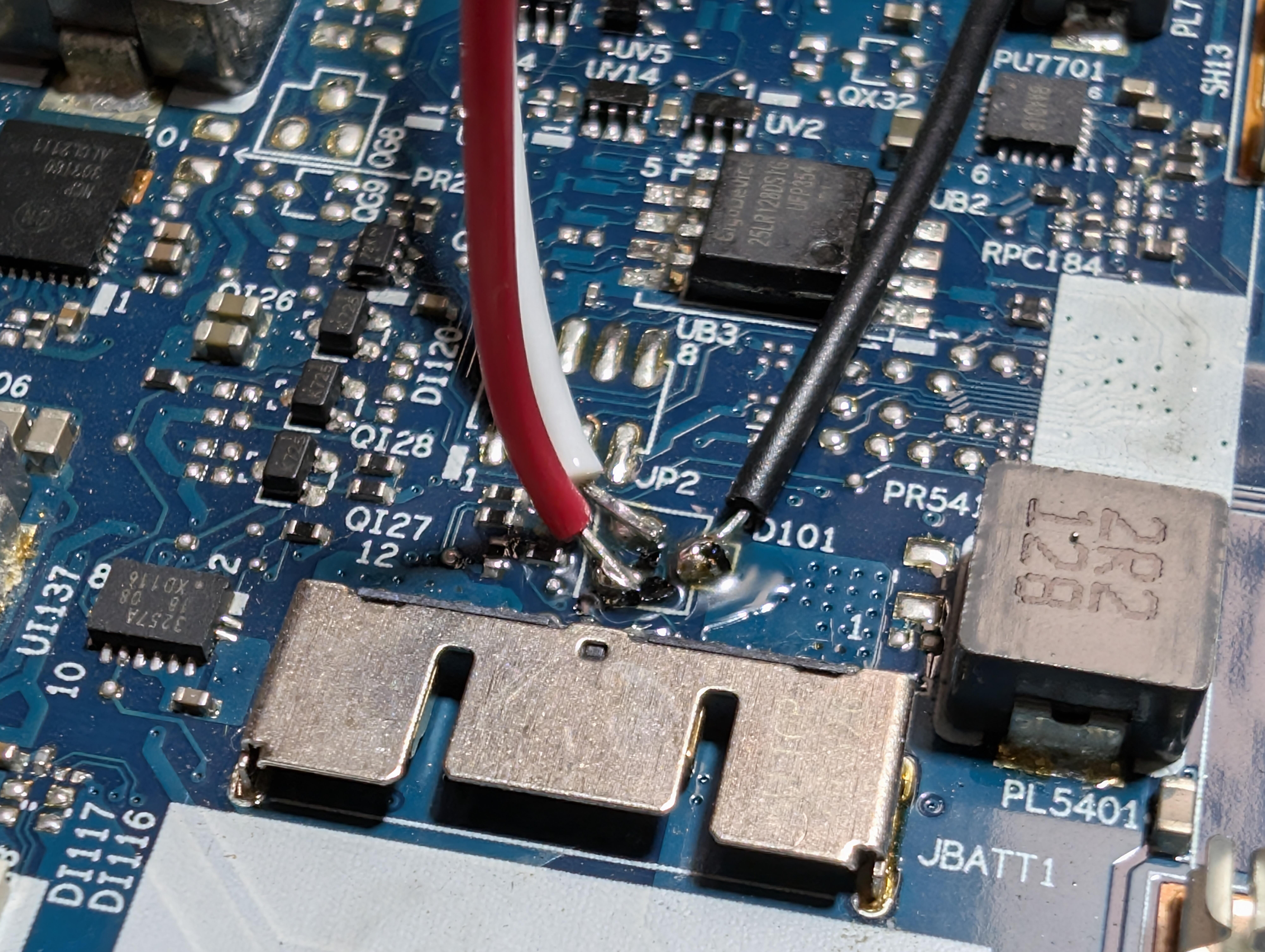

                                        Great news: the programmer is indeed able to read and write the chip through I2C with ITEEC_WinFlash 4.0.1.0!
                                        Click image for larger version  Name:	EC_I2C.png Views:	0 Size:	126.3 KB ID:	3730047 Click image for larger version  Name:	i2c_mb.jpg Views:	0 Size:	2.64 MB ID:	3730048 Click image for larger version  Name:	i2c_programmer.jpg Views:	0 Size:	2.93 MB ID:	3730049
                                        1. Run the program.
                                        2. Press on Setup and check the "Internal Clock for KBS" and "Dual-Flash" options.
                                        3. Solder GND, SDA and SCL on the motherboard.
                                        4. Connect the programmer to the computer that is running the program.
                                        5. Power the motherboard.
                                        6. Press on "Internal-Flash" at the top.
                                        7. Press on "Read Twice to Verify" before performing a Read (optional, but recommended).
                                        I can confirm the firmware that was installed is 192 KB (or even less), despite the internal memory being 256 KB. This means that replacing an IT8227E-256 with an IT8227E-192 should be perfectly fine.
                                        Unfortunately I still get no POST after flashing the firmware you provided me, but I immediately noticed something weird:
                                        1. Powering the board right after the flash results on CS activity on BIOS SPI, which initially made me believe the issue was fixed.
                                        2. Powering the board a second time results in no CS activity on BIOS SPI anymore!
                                        And the crazy part is that a binary diff of the dump(s) reveals several differences, I attached three of them as an archive.
