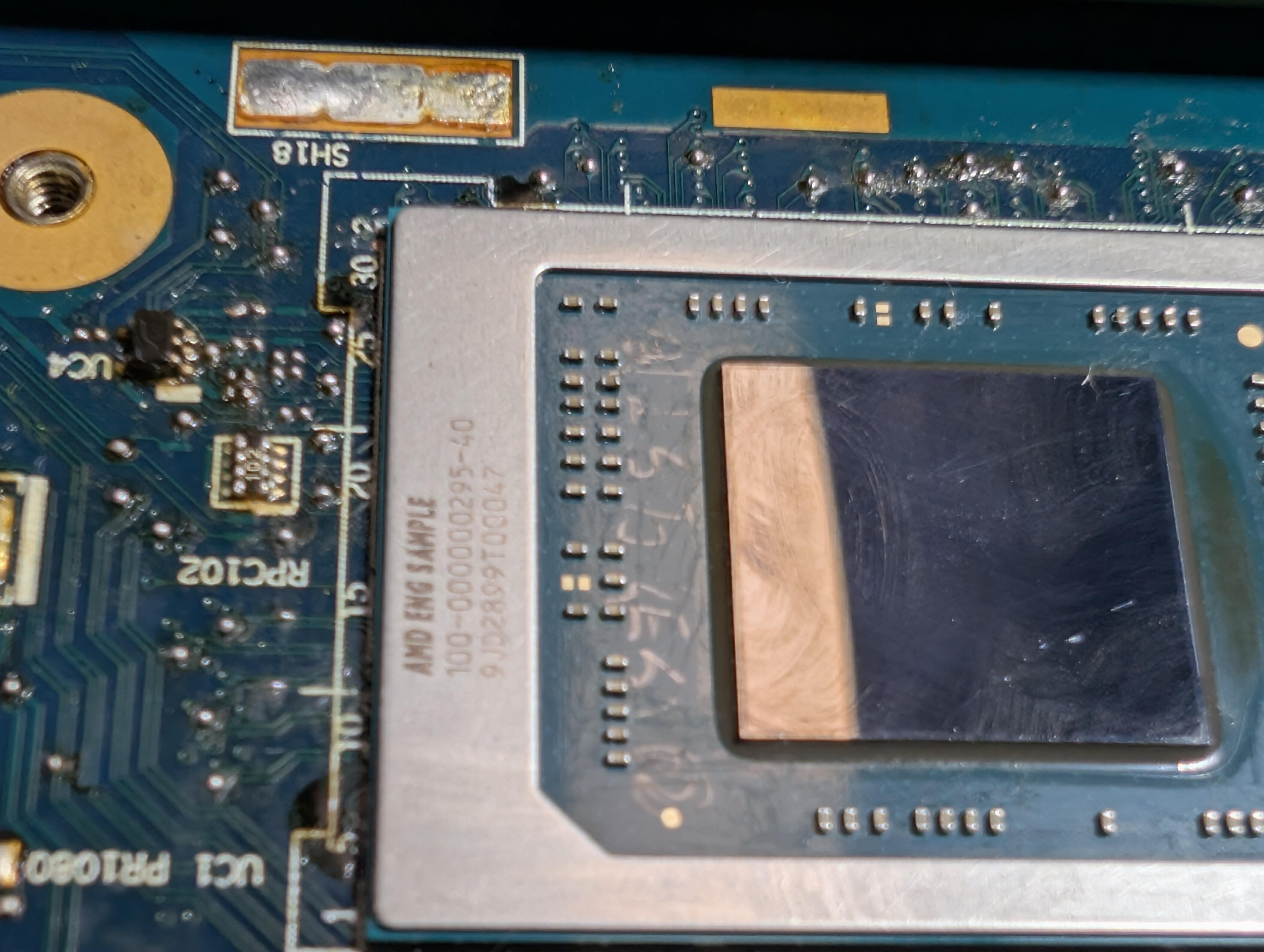

            Keep in mind I have already replaced the CPU:
            Originally posted by davidebeatrici
            I think I have reached your situation now.
            After removing the CPU (and cleaning all pads) CPU_RST_R_N and CPU_PWROK became high (1.8V) and VCORE increased from ~0.8V to ~1.1V.
            I then installed a 100-000000295-40 (ES 5800H) and it gets warm as opposed to the original CPU which stayed completely cold.
            Unfortunately still no POST whatsoever and no activity on SPI_CS for BIOS and VBIOS.
            Four pads were ripped off thanks to the black glue, but fortunately they're all NC (AU2, AV3, AY7 and AW7).

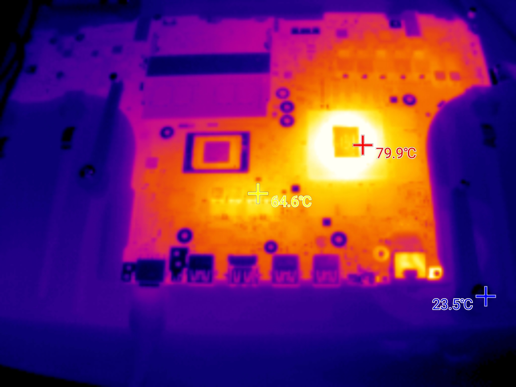

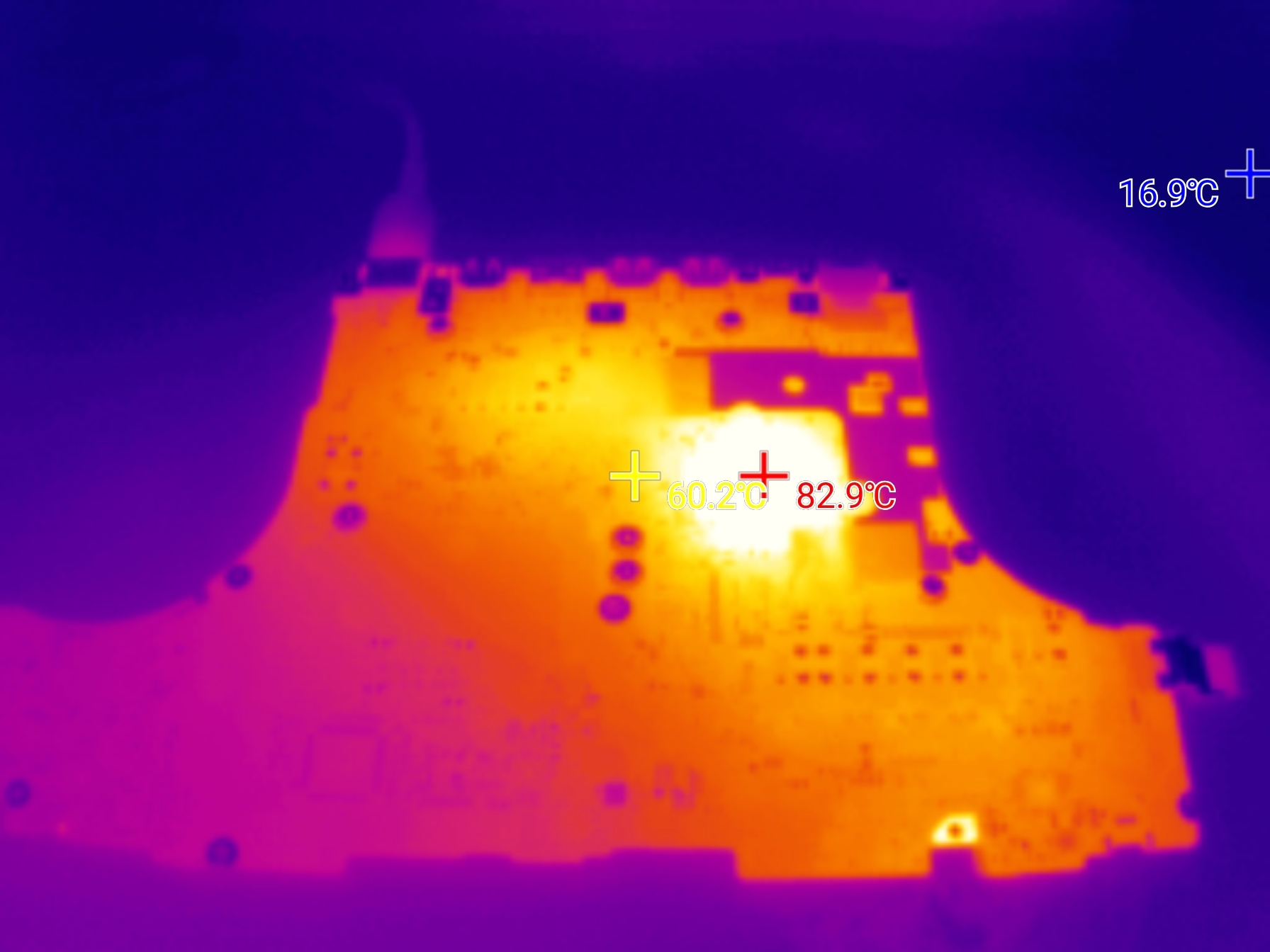

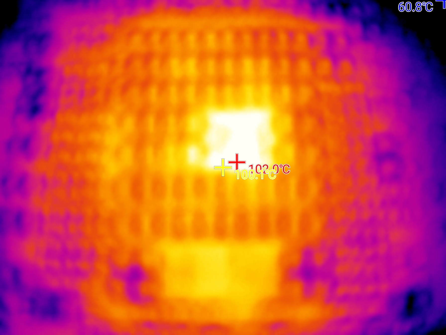

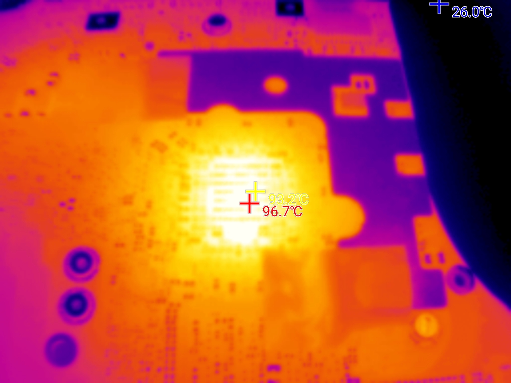

                  I'm starting to think the GPU has an internal short: after leaving the motherboard on for two minutes or so to take measurements on the other side of the board I noticed it became very hot to the touch.
                  I immediately investigated with my thermal camera and noticed the GPU reached the insane temperature of 144°!
                  Click image for larger version  Name:	backside_1.jpg Views:	0 Size:	530.9 KB ID:	3731679 Click image for larger version  Name:	backside_2.jpg Views:	0 Size:	613.7 KB ID:	3731680 Click image for larger version  Name:	backside_3.jpg Views:	0 Size:	700.2 KB ID:	3731681 Click image for larger version  Name:	gpu.jpg Views:	0 Size:	557.8 KB ID:	3731682

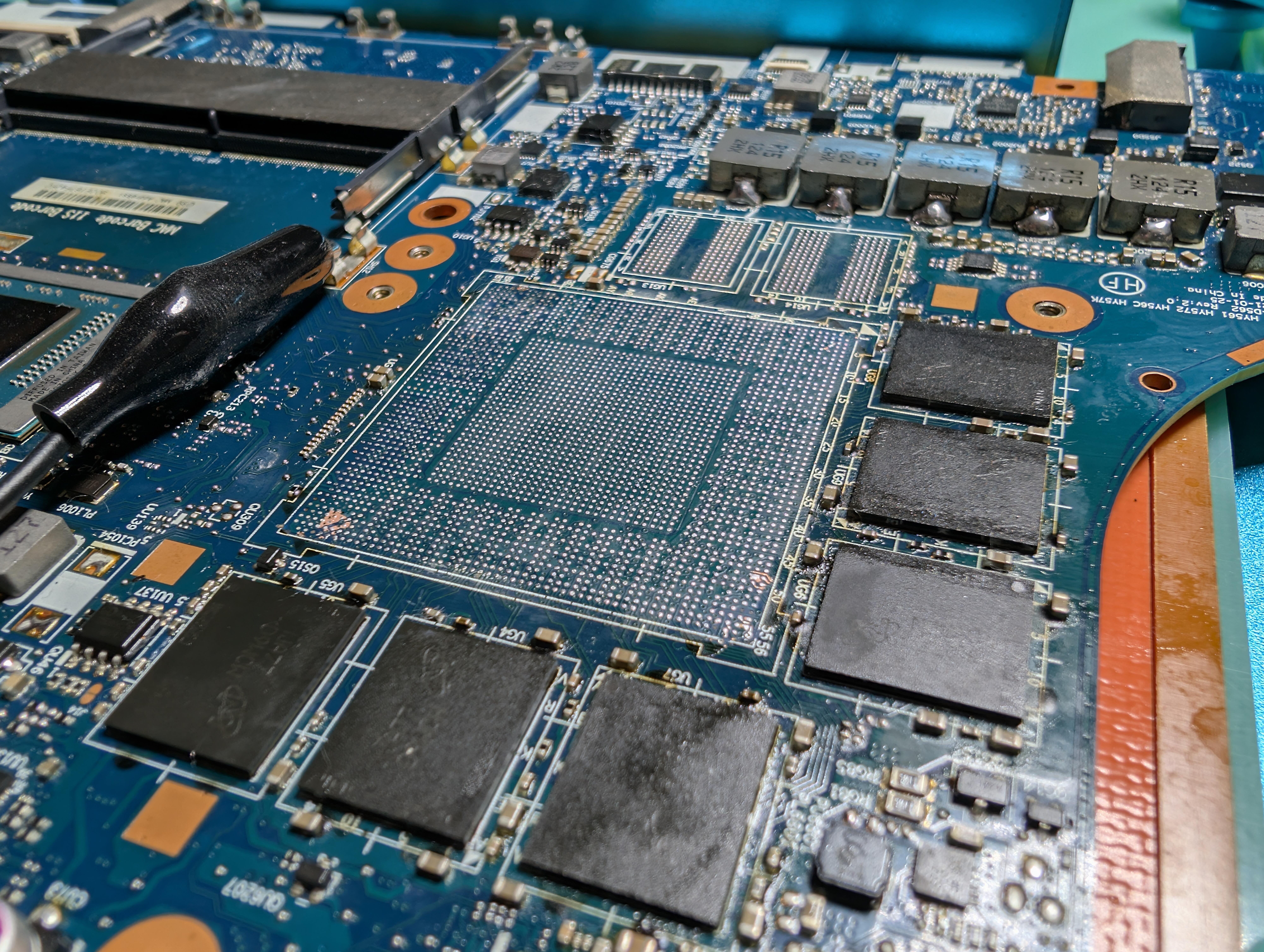

                  I decided to perform a reflow and remove the power coils at the same time:
                  Click image for larger version  Name:	no_gpu_power.jpg Views:	0 Size:	722.6 KB ID:	3731683
                  Still no POST and no CS activity on the BIOS chip. I suspect removing power to the GPU is not enough, especially if the platform expects it to come up before the CPU.
                  Restoring power to the GPU results in it still heating up without doing anything (as far as I know):
                  Click image for larger version  Name:	restored_gpu_power.jpg Views:	0 Size:	594.0 KB ID:	3731684
                  At this point I don't know how to proceed. I have already ordered a replacement EC chip just because it's cheap and I want to keep a spare around, but I'm pretty sure it's not the issue here.
                  Any input/opinion is well appreciated. Thanks to m1ch43lzm we now know how to extract the EC firmware, making sure that's definitely not corrupted. The bytes that change after the flash are probably internal flags that are set on first boot and afterwards.
                    What is your GPU resistance on coils? (Mine are 0.31 ohms )
                    What is strange in yours that in 110 Degrees celsius The board should shut down i think.

                        #51
                        0.00Ω! I don't think it's a problem of the multimeter because it correctly measures ~3.4Ω on the CPU coils when it's cold.
                        Surprisingly, injecting 0.8V right after the coils results in a power consumption of ~1.3A.
                        I expected much more if it's really a short, but the behavior makes sense because the GPU doesn't get extremely hot right away.
                        Also, the current consumption slowly increases, but I didn't wait to see how high it would go.

                          This makes sense if GPU shorted. I have seen many of them going to afterlife like this.

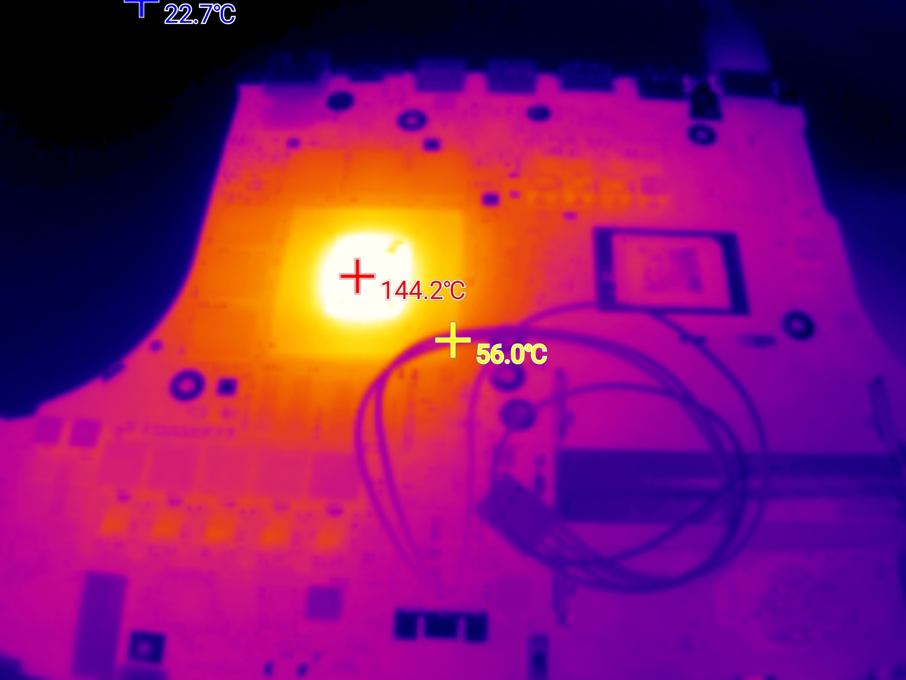

                            Furthermore I have measured some things around the very hot mosfet in the GPU line.
                            Turns out the mosfet had a whole in it. Fused itself to the board and it was very hard to remove.
                            After removing, the GPU coils not getting hot at all. only GPU core is rising slowly until about 60celsius degree, but still NO POST.
                            SPI_CLK is still not rising... 0V
                            waitng for programmer to verify the firmware.

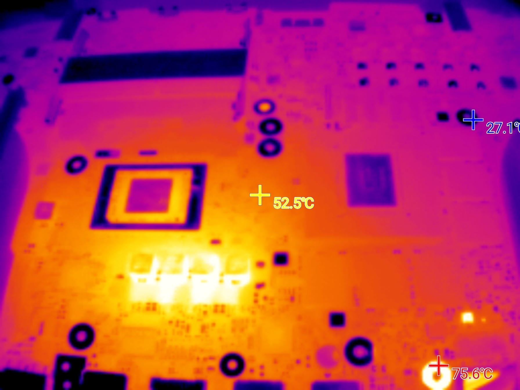

                              If the chip stays around 60° I would say that's fine. Also my GPU coils are not getting hot at all, but the GPU reaches the insane temperature that can be seen in the thermal picture I sent above.
                              Core voltage stuck at 0.76V.
                              The CPU coils, instead, reach 70° with the chip only being warm.
                              Core voltage stuck at 1.1V.
                              I hope it's just an EC firmware problem in your case.

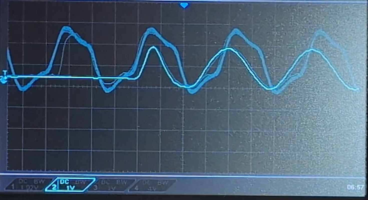

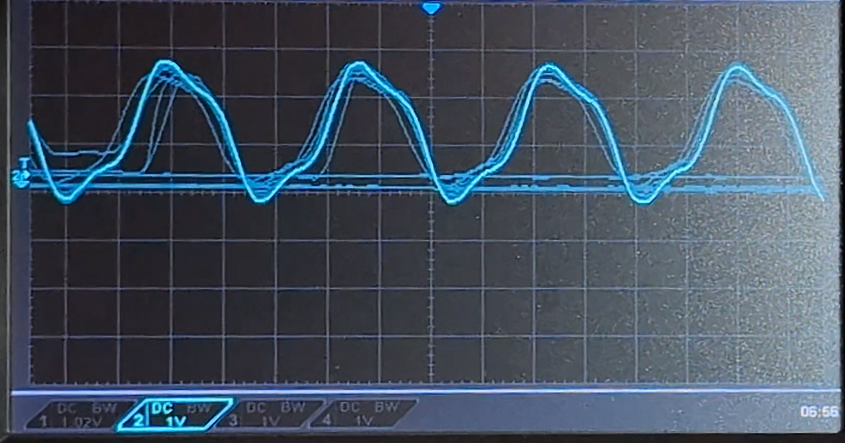

                                I checked the corresponding oscillator (YG1) with my oscilloscope and saw a somewhat sinusoidal wave:
                                Click image for larger version  Name:	yg1_1.png Views:	0 Size:	1.66 MB ID:	3732377 Click image for larger version  Name:	yg1_2.png Views:	0 Size:	1.30 MB ID:	3732376
                                The two oscillators for the CPU, instead, show very faint activity, probably just interference at this point.

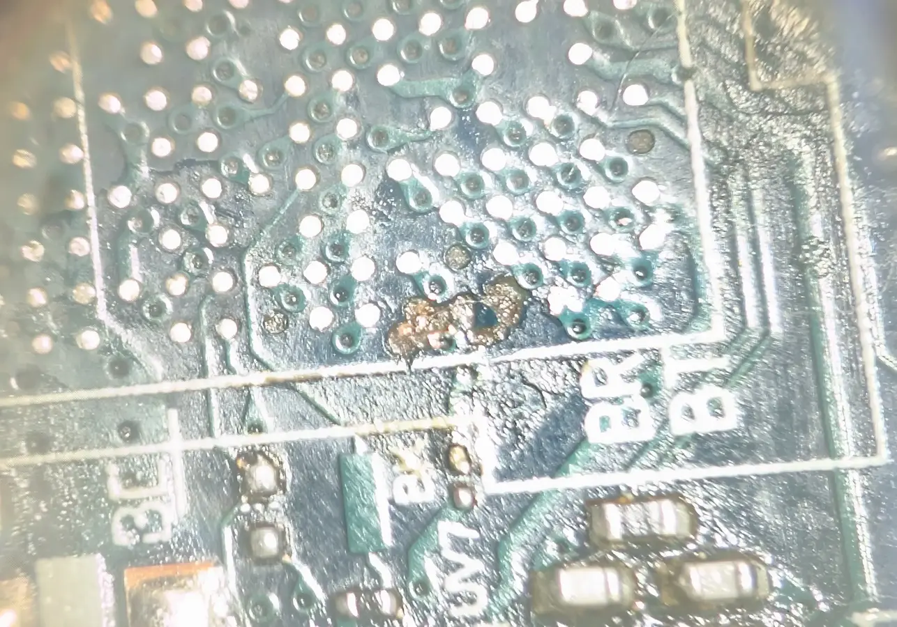

                                I decided to remove the GPU anyway, but no changes in the behavior. Quite a few ripped pads (once again, thanks to the black glue), all NC except two that I'll have to repair somehow:
                                Click image for larger version  Name:	ripped_gpu_pads.webp Views:	0 Size:	137.7 KB ID:	3732378 Click image for larger version  Name:	gpu_removed.jpg Views:	0 Size:	3.98 MB ID:	3732379
