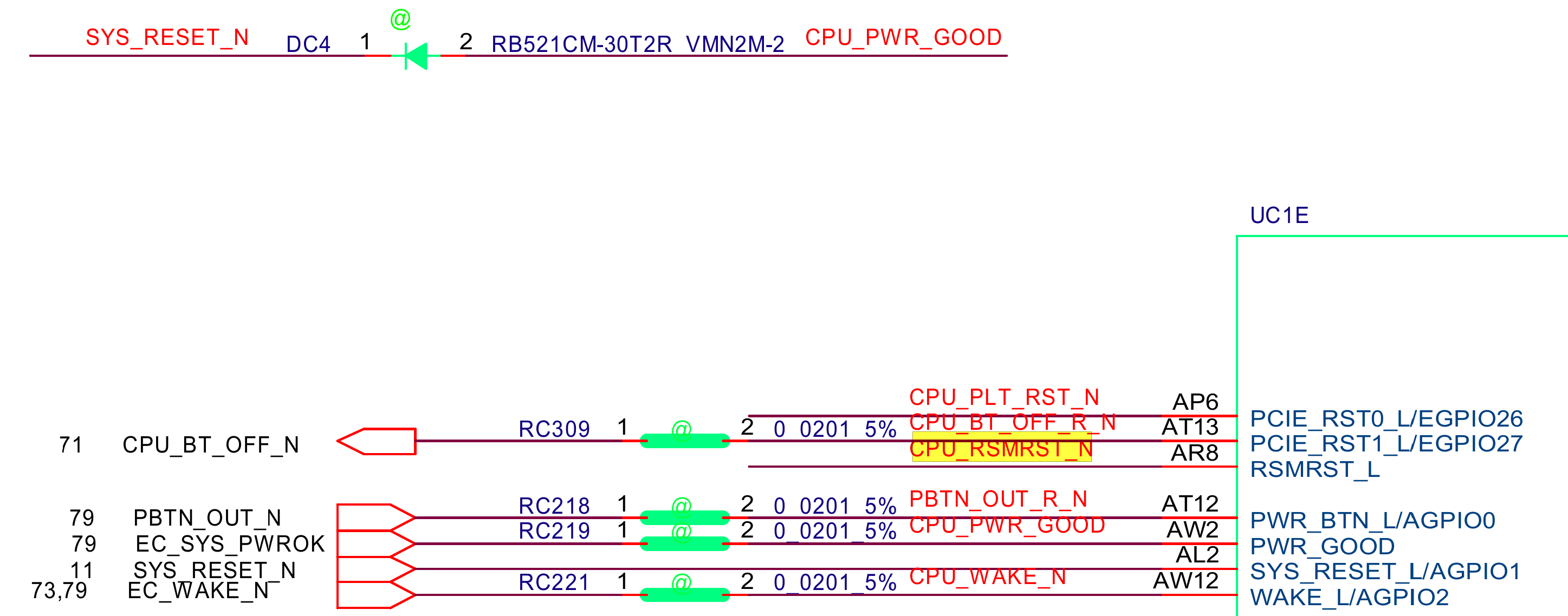

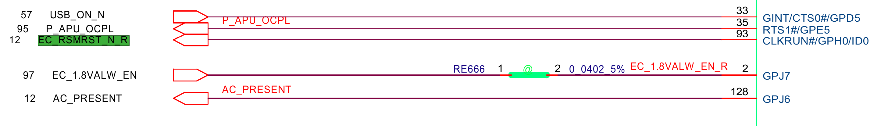

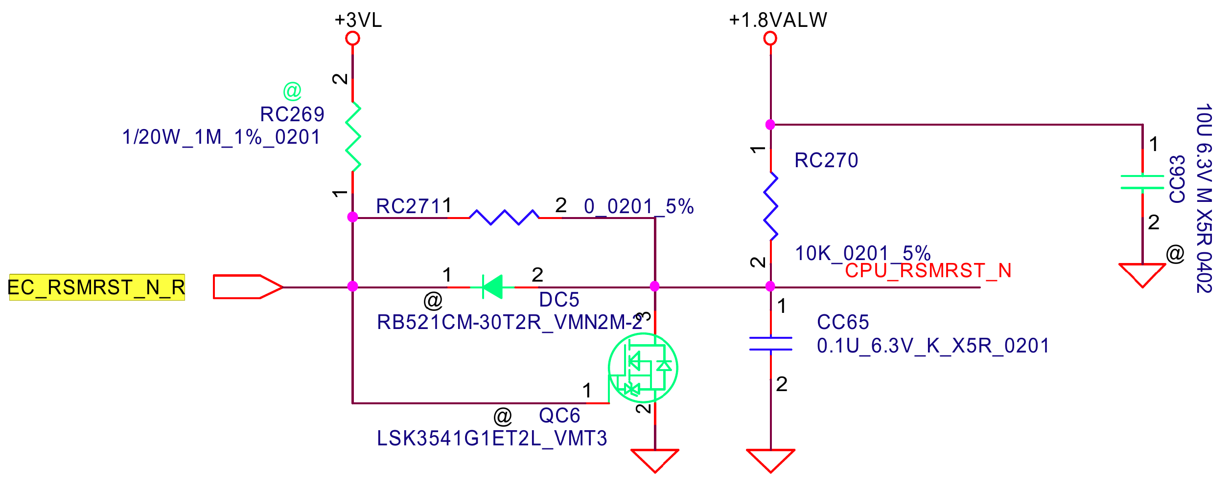

    Both 0V and OL. How's the continuity/resistance to ground in your case?
    I'll check the following signals:
ID:	3732801 Click image for larger version
ID:	3732802 Click image for larger version

      So... I checked the oscillator pins on the original CPU and in diode mode to ground there is indeed a voltage drop from ~0.4V to ~0.6V depending on the polarity.
      I checked the signals anyway and they're as follows.
      EC_RSMRST_R_N: 3.3V
      CPU_RSMRST_N: 3.3V
      CPU_PLT_RST_N: 1.8V
      CPU_PWR_GOOD: 3.3V

              My measurements:
              EC_RSMRST_R_N: 1.7V
              CPU_RSMRST_N: 1.7V
              CPU_PLT_RST_N: 0V
              CPU_PWR_GOOD: 3.3V
              I still think its and EC firmware
              • davidebeatrici
                • Dec 2020
                • 131
                • Italy
                #67
                Originally posted by questore
                Meter in diode mode YC1 has 0.748 Voltage drop on both sides to ground , YC2 has 0.746 on one an 0,830 on the other side
                I get ~0.75 on all four but I think your measurements are good.
                My measurements:
                EC_RSMRST_R_N: 1.7V
                CPU_RSMRST_N: 1.7V
                CPU_PLT_RST_N: 0V
                CPU_PWR_GOOD: 3.3V
                Interesting how the RSMRST signals seem to be floating in a half state. Not pulled up nor down, a quantum paradox basically!
                Let's see if they change once you flash the correct EC firmware.

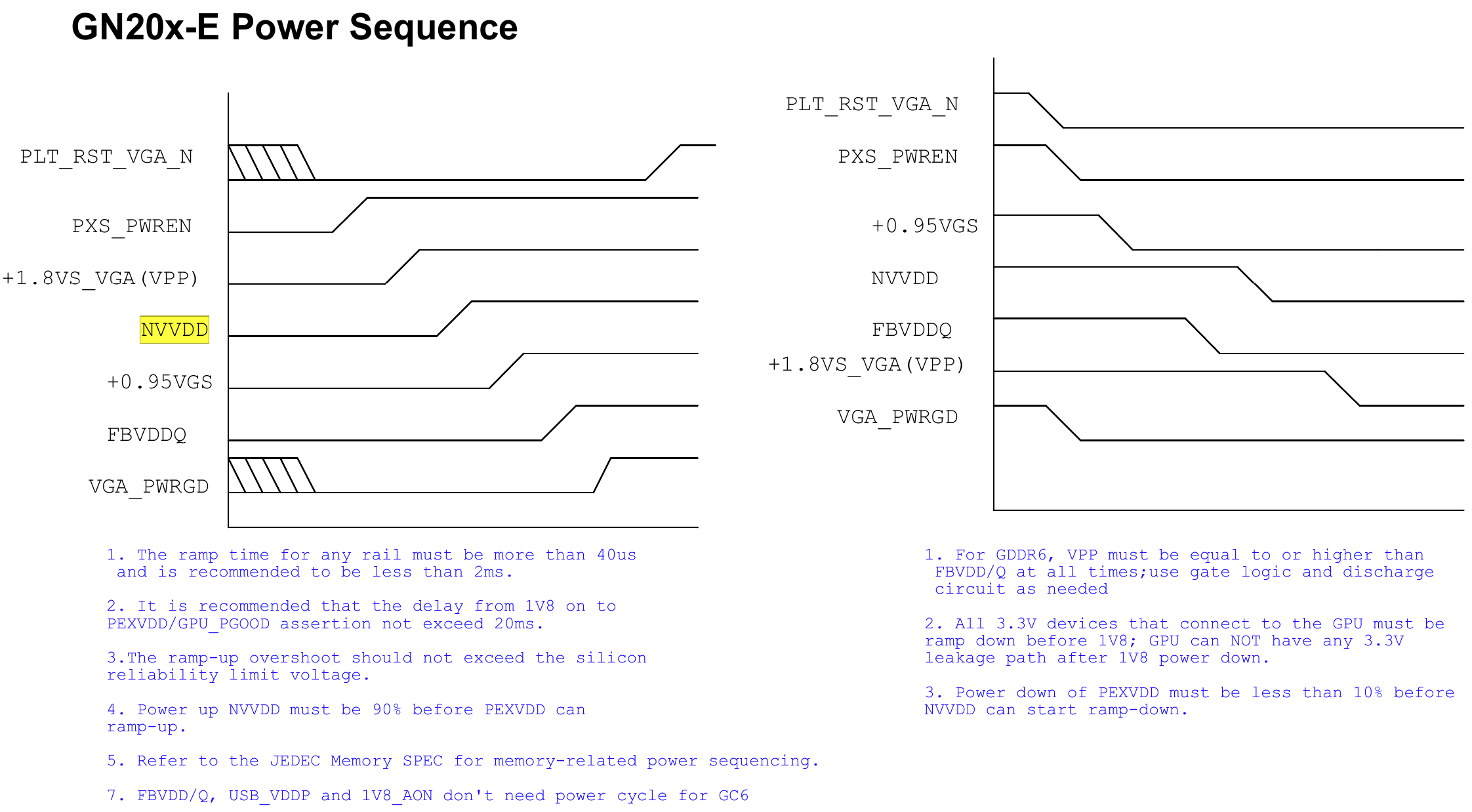

                                      Perfect timing, yesterday I received GPU and GDDR6 chips. Soldered everything, along with the extra capacitors and resistors, but the board is not powering the GPU nor the VRAM.
                                      Click image for larger version  Name:	GN20x-E_power_sequence.png Views:	0 Size:	200.6 KB ID:	3742258
                                      According to the power sequence FBVDDQ should come up after NVVDD. The RTX 3080 is absorbing from ~4.5A at 0.8V, a known working RTX 3060 ~1.5A at 0.8V.
                                      After a few power cycles the board didn't want to turn on anymore, I quickly found the cause to be a short to ground on 20V: turns out the first of the five VRMs/MOSFETs is gone...
                                      I removed it and now the board powers up again, but still no voltage to the GPU.
                                      I suspected the VRM controller expects all 5 phases to be alive, but that doesn't seem to be the case: https://www.youtube.com/watch?v=OwnmAAS3gnY
                                      I remember you removed a VRM as well, did you ever replace it? Do you have NVVDD right now?
