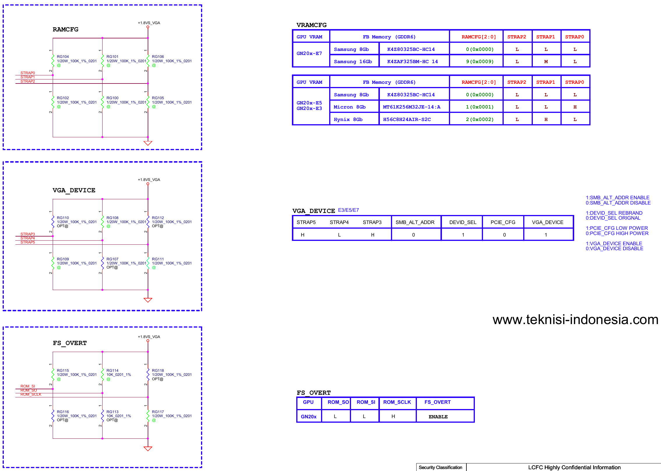

    BTW about your project:
    1. Do you have activity on BIOS Pin 8# when you power it on?
    2. When you have replaced you GPU with a different one, have you checked the GPU bios is good for it?
