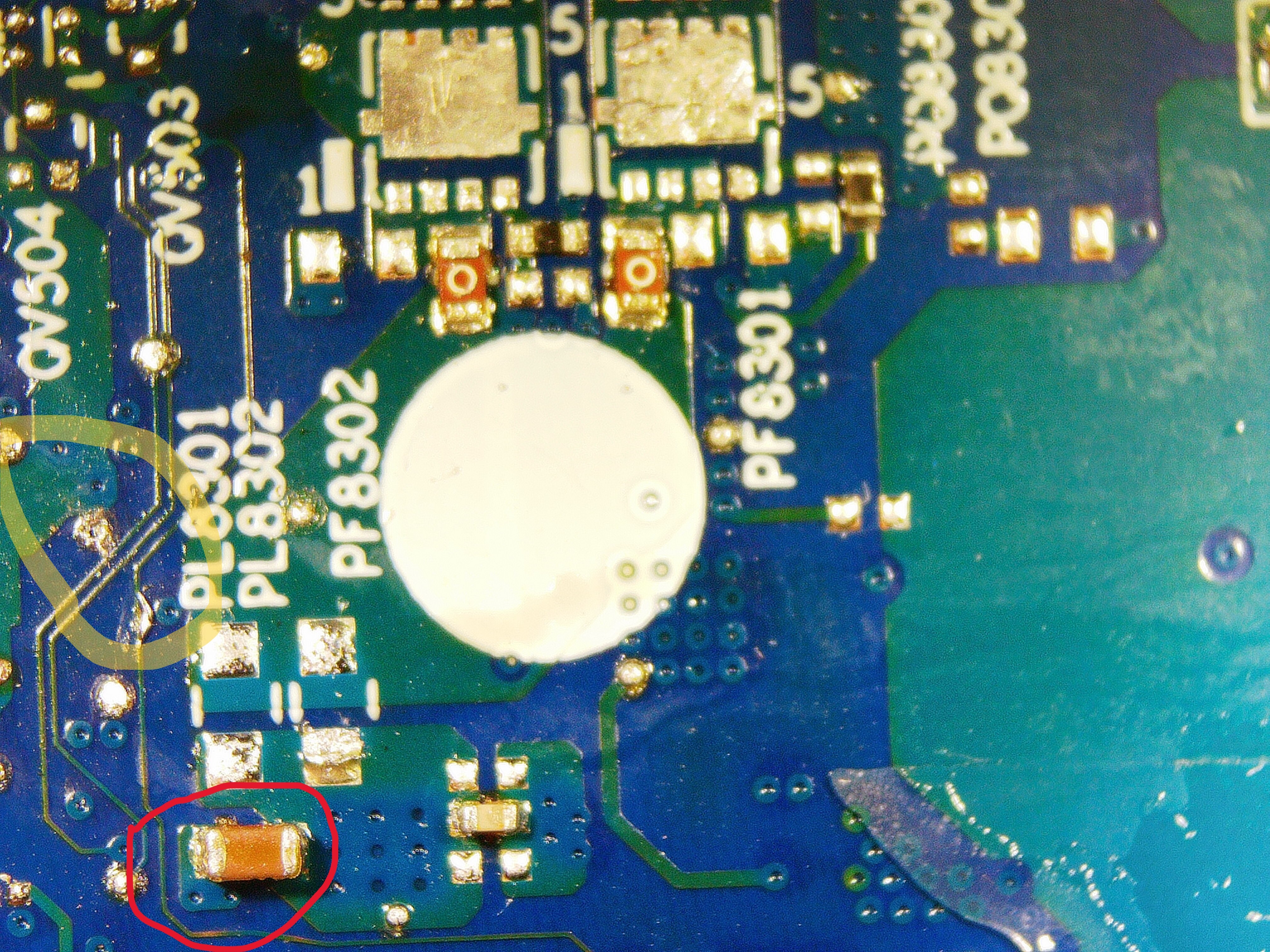

      Edit: please post a picture of the area around both inductors
      One side of the inductors should have continuity to the fuses, the other side won't
      Measure resistance to GND at the fuses

        Here you go!
        Click image for larger version  Name:	2020_0303_074334_002.jpg Views:	0 Size:	2.79 MB ID:	3648257
        Top side of both inductor pads have continuity to the two fuses, the other side don't, like you indicated.
        Question, in my resaerch, a guy on UT said that coils (inductors) are always connected to the positive rail only, is this an accurate statement?

          The short could be in the cap marked in red PC8309, or any other cap near the BQ on the other side of the board
          To double check, measure resistance across PC8309 if you still have 43ohm
          In yellow i marked what appears to be some stray solder? Inspect the board for stray solder blobs
          You haven't posted the resistance measurements, you may edit the picture with the measurements written on it
          If you're confortable with voltage injection, set your bench PSU to 1v (don't go higher, double check with multimeter) and solder a wire to the bottom of PL8301-PL8302, connect that to the + of the bench PSU
          The GND you can connect to a screw hole
          Take note of the current draw, check with the thermal camera which component gets hot, may be a cap near the BQ, PC8309 or PC8307 near the audio IC (unlikely)

            Yes still have 46 ohms across PC8309. Took care of the solder gob. Could you please tel me again what resistance measurements you want?
            Due to space constraints, I'm doing this smd work, not on my work bench but on a table next to my computer. My bench PSU is on my bench, I will have to make room and move my camera over there. I'll get back to you, Thanks!

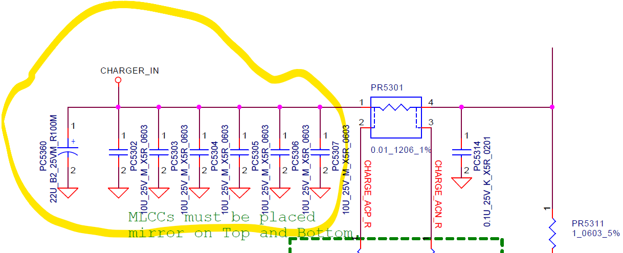

              OK, please post resistance measurements:
              - Across CU206 (+5VALW), should be very high on Kohms - Mohms
              - From PF8302 to GND (TBT_VSYS), now it should be very high in Kohms or more

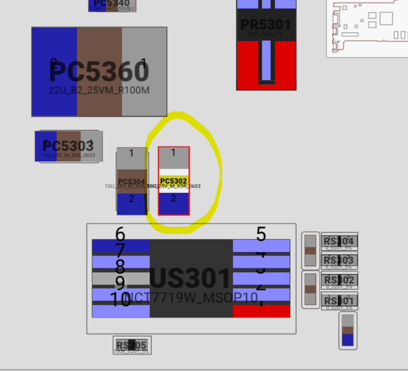

                  I can't see the picture (maybe the forum ate it?), but you can remove PC5302 and the short should be gone
                  Is this one?
                  Click image for larger version  Name:	cappc5302.png Views:	0 Size:	93.1 KB ID:	3648422
                  Unless its one of the caps on the other side of the board
                  But the low resistance on +5VALW worries me (14ohm), could be anything on the board, a cap, the TPS65994 or anything
                    Is this one?
                    Sorry about that, that png must of been to big, here is a jpeg:
                    Is that a different boardview you use, its colorful not black and white?
                        The software i used is FlexBV free edition by inflex aka Paul Daniels (@pldaniels on YT), he repairs mostly Apple laptops, sometimes other brands on his livestreams
                        https://www.badcaps.net/forum/troubl...acos-and-linux

                          Good morning. I'm going to remove PC5302 and see what happens. The two mosfets and two inductors are still out of the board.

                            Removed PC5302. The short is still there, 5 volts 650 milliamps, F**K.
                            Removed PC8309 no difference.
                            After removal of the top two caps, voltage injection no longer produces any current at 1 volt.
