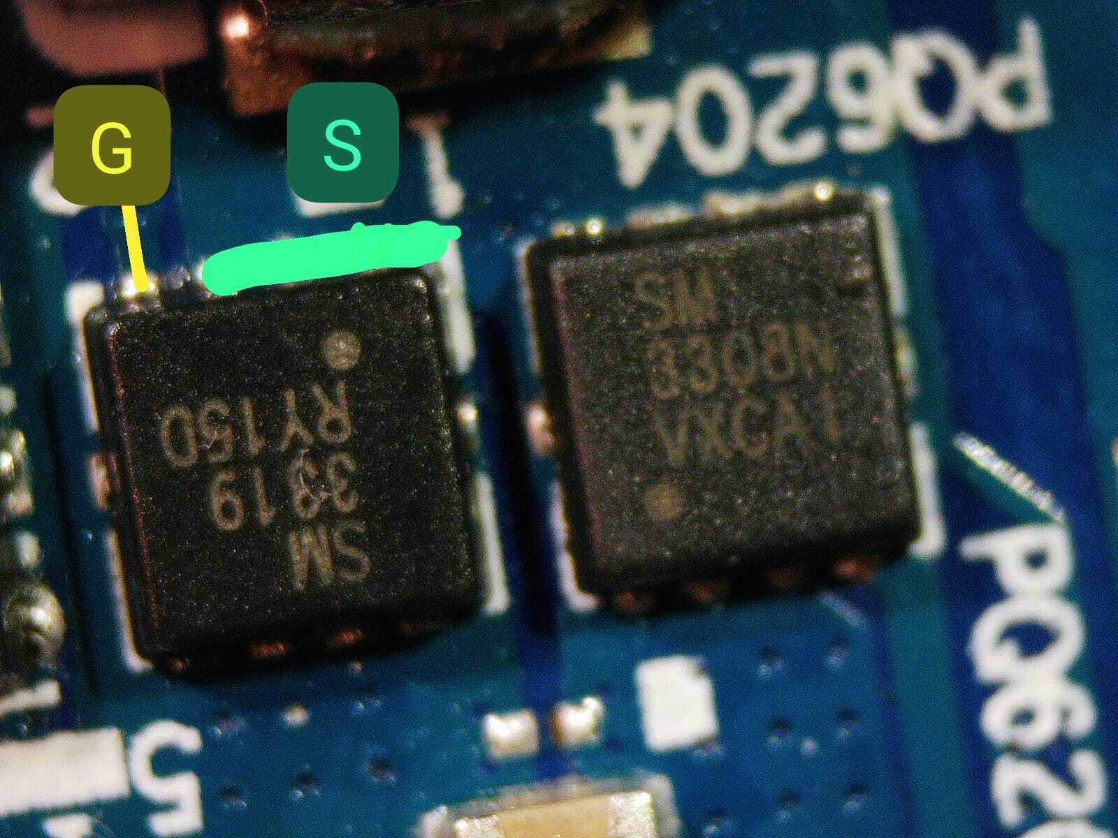

    Originally posted by m1ch43lzm
    That's bad if the resistance measurement is correct
    Click image for larger version Name:	gate source.jpg Views:	0 Size:	200.0 KB ID:	3665844
    PQ6204 is the high side MOSFET, if it's shorted S-G hopefully the RT6585 detected the fault, that's why the 3.3V and 5V supplies don't work
    You can remove PQ6204 and measure it outside the board to confirm, set the hot air to 450-460 C
    With the MOSFET removed measure again S-G pads on the board, resistance should be higher
    If the MOSFET is shorted S-G outside the board, it's definitely faulty
    Always measure resistance without power applied, don't connect the battery/charger until the MOSFET is replaced with an appropriate one
    Charger won't work anyway as the TPS65994 is missing from the board
    Dammit, I measured S TO G AGAIN ON 6204 and got 1.7 meg. (I tripled checked this time). My bad. Thanks for the hot air setting too btw.

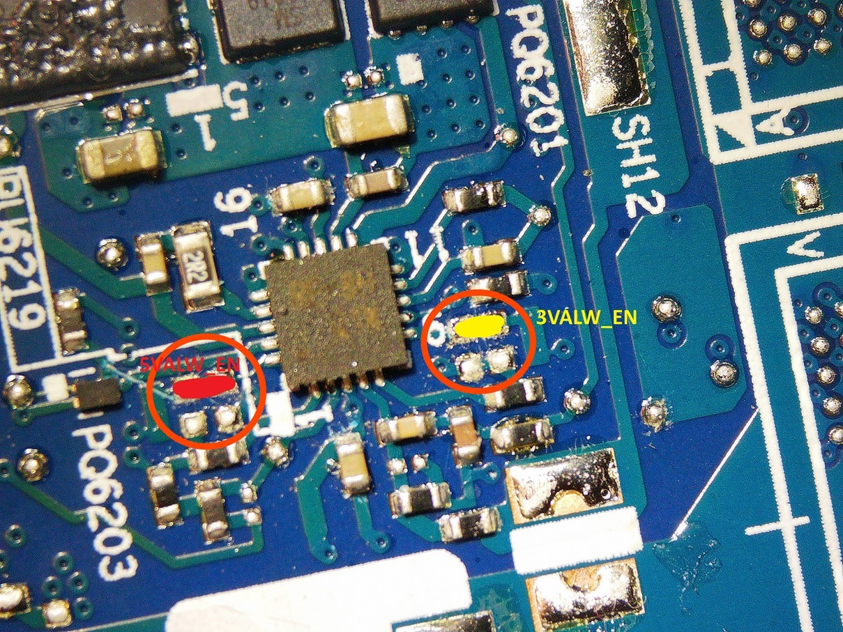

              Mich, I'm just spit balling here and tell me what you think of this: I asked this above, The question is is this flashing the result of a component touching a ground where it shouldn't (that would be a short right)? Or is a component getting power from two sources at once? Now if the flashing is from a short to ground, you would think something would heat up wouldn't you? I just checked the board with the charger and battery plugged in with my thermal camera and the only thing I seen light up a little was the BQ chip and that was only at 80c. Now would it be feasible to try some voltage injection? I got a voltage injection tool a few days ago. at this point do you think that would tell us anything?

                The flashing you see on the enable lines, could be that the 3VL is unstable; or the EC doesn't like something, as it has connections to the BQ25710 and the TPS65994, so the EC keeps restarting over and over, it could be pulses ef 3.3V on the enable signals but you can't measure that with a multimeter, you need an osciloscope if you want to check this "flashing"

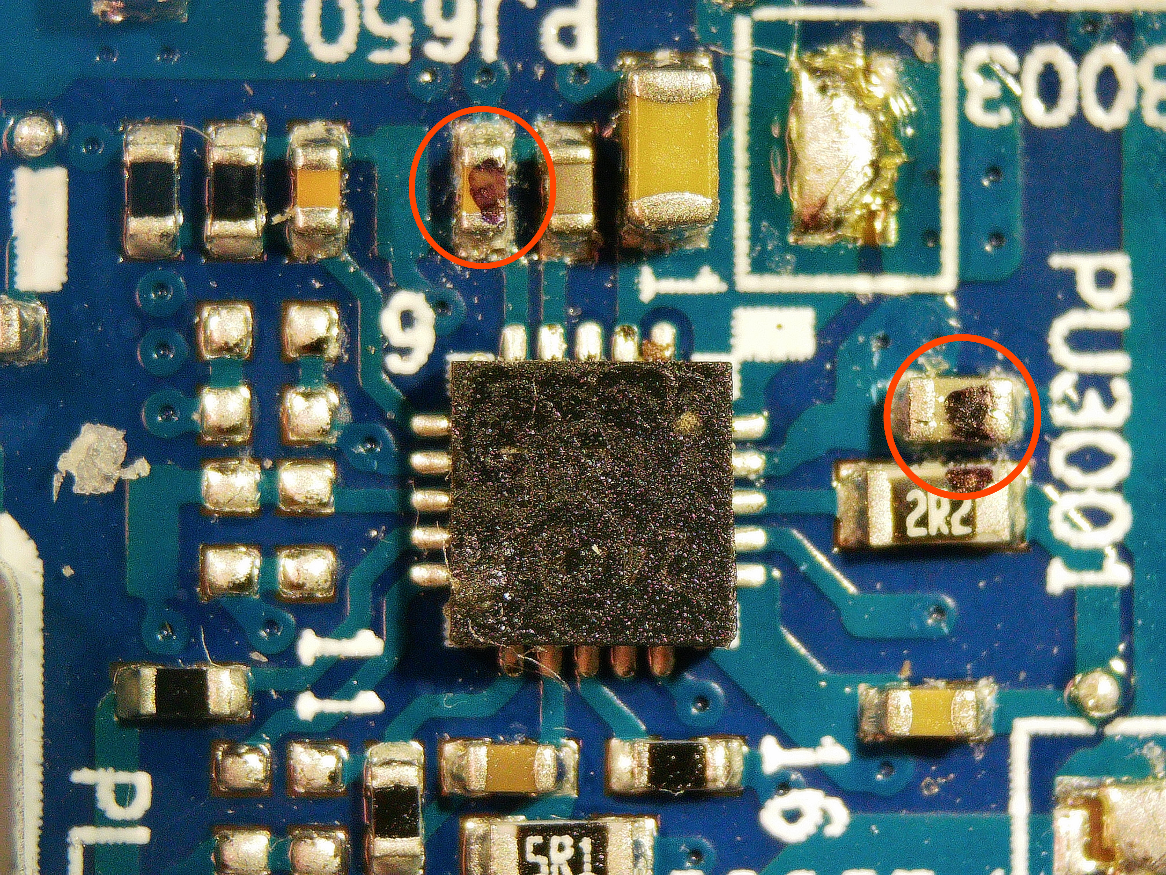

                    Mich, do these two caps look like they they could be shorted? Maybe one or the other or both, I believe they are connected to each other. I tested them to gnd. with my meter in the diode mode and both beeped on both ends of the cap.
                    They are PC3005 AND PC3018 LOCATED NEAR PU3001. What say you?

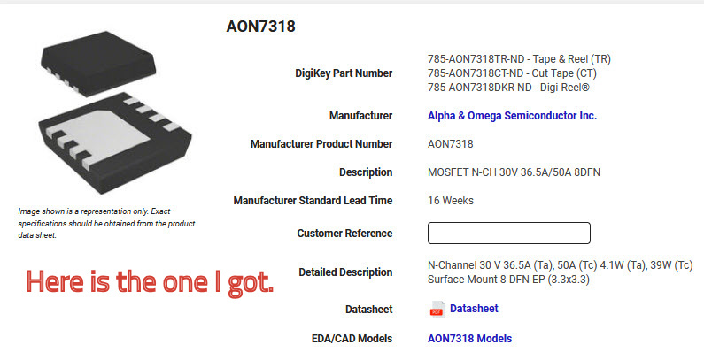

                      It probably doesn't make a difference but just to be sure: OK?

                        It depends on the reading on your meter; around 100 ohms, maybe a bit less, may be a bit higher is completely normal, as it's the 1.2V power supply for the RAM
                        Usually low voltage and high current supplies have low resistance to GND, how low, it depends; for example on a good working CPU the reading may be around 5-10 ohms, maybe a little less depending on CPU type
                        Measure again in resistance mode
                        Yes, both are in parallel. The reading should be the same at PJ3002 or PL3001​

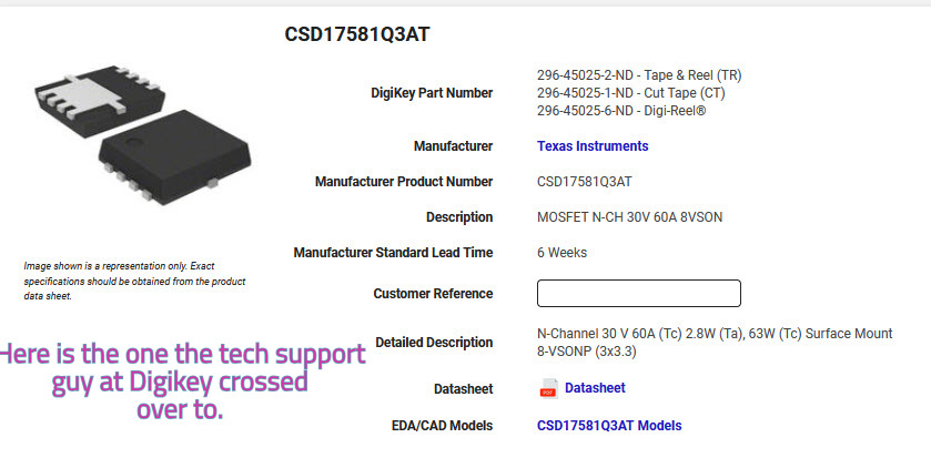

                        Those are slightly bigger in size (3.3mm*3.3mm) than the originals (3mm*3mm), which ones you received?
                        https://www.digikey.com/en/products/...6LDK-7/6010148
                        This one is the exact same size (3mm*3mm), has similar specs to the original (Id 46.2A, 7.5mOhm Rds(on))

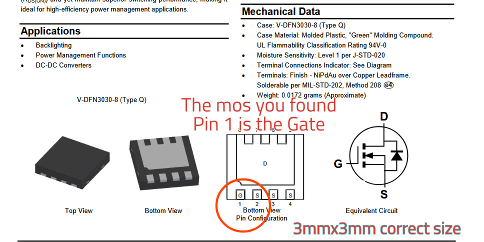

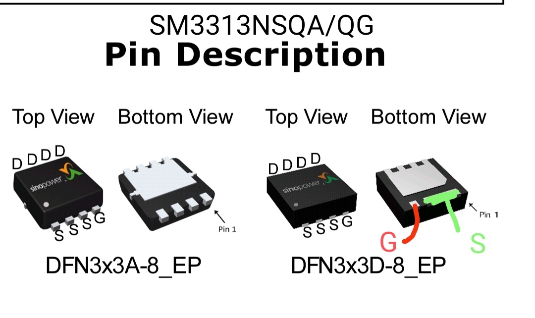

                          #172

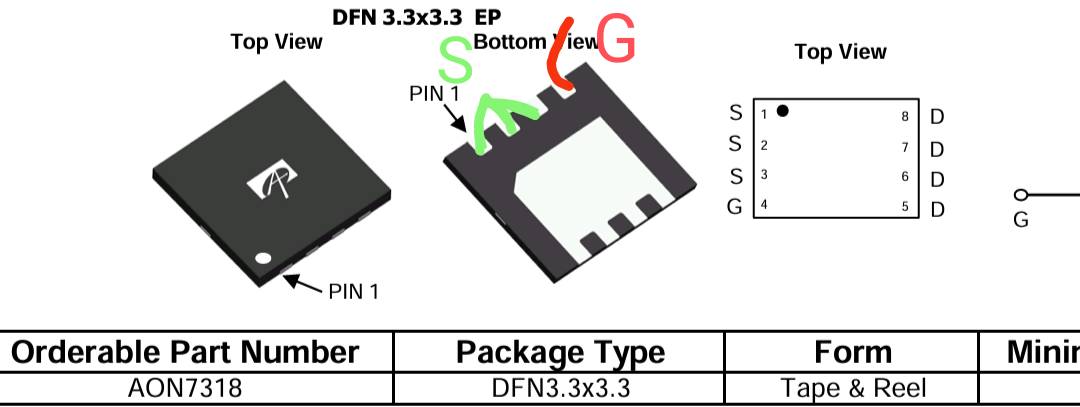

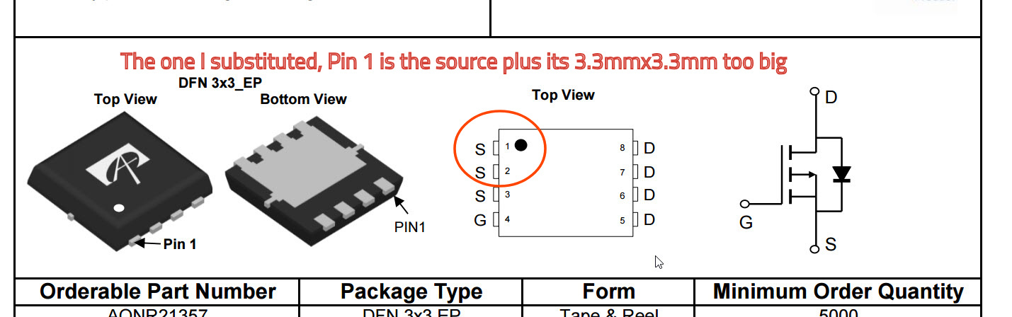

                          I'm confused now. I measured the original mosfet that I took off the board with a dial caliper and it measured 3.0mm x 3.0mm. The ones I got are 3.3mm x 3.3 mm as you said. The bigger ones are a pain in the ass cause you can't see any of the traces underneath it and I just centered it where I thought it looked the best.
                          Did you notice this?
                          Looking at the data sheets, the mos I got and the mos you found has a different Pin layout for the gate and source. Could this be the whole problem we are having? The one you found will work right?
                          Give me the word and I will order the ones you found!

                          Wonder why the Digikey tech guy didn't suggest the one you found?

                            Look where it says "Bottom view", it means you flip the MOSFET and you're looking at the solder pads
                            Top view is when you're looking at the case/markings
                            Both are correct, maybe on the Diodes one they labeled the pin numbers differently, but the order is the same if you look at the bottom side
                            Click image for larger version  Name:	sub mos 2.jpg Views:	0 Size:	162.5 KB ID:	3669245
                            Click image for larger version  Name:	Mic mos 2.png Views:	0 Size:	233.5 KB ID:	3669246
                            Here's the original one
                            Click image for larger version  Name:	sm3313.jpg Views:	0 Size:	124.0 KB ID:	3669295
                            And the AON7318
                            Click image for larger version  Name:	aon7318.png Views:	0 Size:	94.6 KB ID:	3669296
                            The AON7318 is slightly bigger, the pin order is the same if you look at the bottom
                            Same pin order with the DMT3006LDK
                            Also doesn't help that each manufactures labels their package type differently, but they're compatible, also that leads to confusion on 3*3 and 3.3*3.3 until you look at the mechanical drawings...

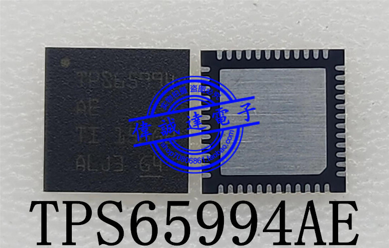

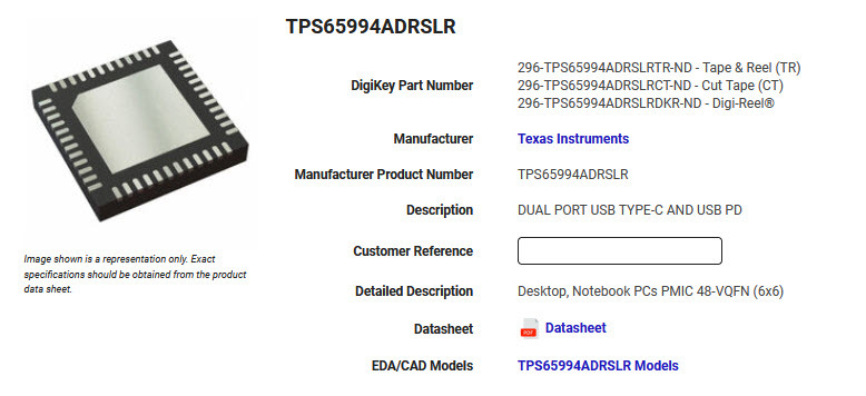

                            EDIT: Also, which version of the TPS65994 did you order? Was it the AD or AE?
                            Here's the AD version
                            https://www.digikey.com/en/products/...DRSLR/13245681

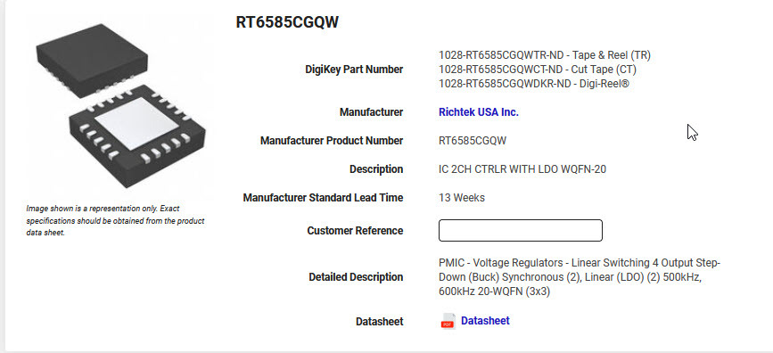

                            While you're there maybe order the RT6585C
                            https://www.digikey.com/en/products/...5cgqw/16376843

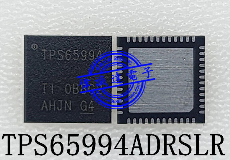

                              Here is the TPS chip I ordered.
                              Do You want me to order this chip now?

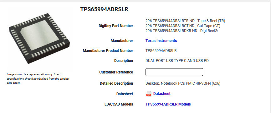

                              So our mosfets appear to be right, Not sure about the TPS chip. I'm pretty sure I just typed in the info that was on the old chip and that is what it crossed over to.
                              Where do we go from here?

                                On the MOSFETs, slight difference in packaging as the DFN3x3A-8_EP package from Sinopower is actually 3.3*3.3mm, according to the mechanical drawings
                                And the SM3313NSQG original ones are the DFN3x3D-8_EP package, slightly smaller 3*3mm
                                Had to look at several datasheets to be sure
                                Thst's why the new MOSFETs don't fit properly, they should align themselves when the solder melts, and when poking with tweezers
                                Another tip when soldering these type of packages, is to flux+tin the pads with the soldering iron on the part itself, just a bit on the center pad (no need to make a "pillow")
                                Reference video how to solder these packages (it's a QFN like the TPS65994), not in English but the technique is understandable, you'll notice he tins the pads on the IC itself, and also the board

                                I found a picture of the "AE" version and it does say "AE" below "TPS65994"
                                At this point I'm not sure anymore what's the underlying fault, but I recommend to get new mosfets that fit properly, and just in case new TPS65994 and RT6585C

                                  On the TPS65994AD you got from digikey, does it say "AD" below "TPS65994", or is it an empty line like the original one? Once more. here is the one I ordered and got from digikey.
                                  Click image for larger version  Name:	tps65994ae.jpg Views:	0 Size:	102.2 KB ID:	3669495
                                  I will order the "new " modfets that fit right and the two other chips you suggest. Thanks and talk to you in a few days!!!

                                    Mich, just to be clear, can you tell me what exactly what TPS chip I should order? This the mosfets I will order, DMT3006LDK-7, correct?
                                    • m1ch43lzm
                                      • Mar 2019
                                      • 756
                                      • Peru
                                      #178
                                      MOSFETs, get at least 4 https://www.digikey.com/en/products/...6LDK-7/6010148
                                      Just in case RT6585C https://www.digikey.com/en/products/...5cgqw/16376843
                                      Check the markings on the original TPS65994, if the next line is blank after "TPS65994" i think is the "AD" version, according to pictures from ebay/aliexpress sellers
                                      TPS65994
                                      (blank line)
                                      TI XXXXX
                                      YYYY ZZ
                                      TPS65994AD https://www.digikey.com/en/products/...DRSLR/13245681
                                      Also compare with the one you got from digikey, the XXXX YYYY are just date/lot codes

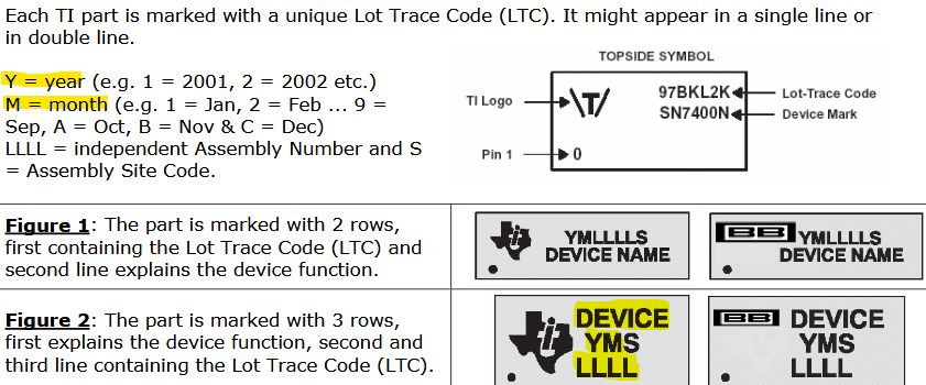

                                      I'm suggesting to get another one, as those ICs can be damaged with too much heat for long time; or if badly soldered
                                      Also solder it with leaded solder; tin the pads on the chip itself with leaded solder too before soldering it to the board
                                      If instead of the blank line it says something else, it's the "something else" version, example for the TPS65994AE:
                                      TPS65994
                                      AE
                                      TI XXXXX
                                      YYYY ZZ​

                                          Originally posted by bogart219
                                          The rest of the numbers on that TPS65994 are : TI 218 G2 A9D6 G4. I ordered another one from digikey when I ordered the mosfets but Mon2 said those have to be programmed. Is that something I can do if i get one of those inexpensive programming boards?
                                          Do you think I screwed that chip up, well yeah it was something I did cause it wasn't drawing 6-700 milliamps before I changed those mosfets out. I thought maybe one of those caps was shorted causing those readings on the TPS65994. Hopefully Mon2 has an idea. Thanks!
                                          Going back to this post on page 4, it's the AE version from your latest pictures; now which one was the original?
                                          Click image for larger version  Name:	tps 2nd chip.bmp Views:	0 Size:	5.93 MB ID:	3670357
                                          It says
                                          TPS65994
                                          AE
                                          TI 218G2
                                          A9D8 G4
                                          This one "AE" appears to be older, "218" maybe means year 2022, month 2 (february), maybe it's the original one after all?
                                          The other one "blank line" says "338", maybe 2023 , month 3 (march) (newer)?, since you said you ordered the "AD" version from Digikey, this one is the AD...
                                          Click image for larger version  Name:	Original tps.bmp Views:	0 Size:	5.93 MB ID:	3670356​
                                          Here's the link for the AE version, hopefully you can change your order
                                          https://www.digikey.com/en/products/...erslr/14634219
