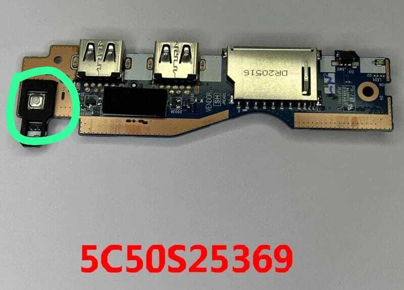

                            Check voltage at the power button, it should have 3.3v on one of the pins
Name:	USB board.jpg
                            May need to remove the gasket to access the pins on the button itself
                            Just the motherboard, battery and daughter board for now

                              I'm not reading any voltage anywhere on or near the power button.

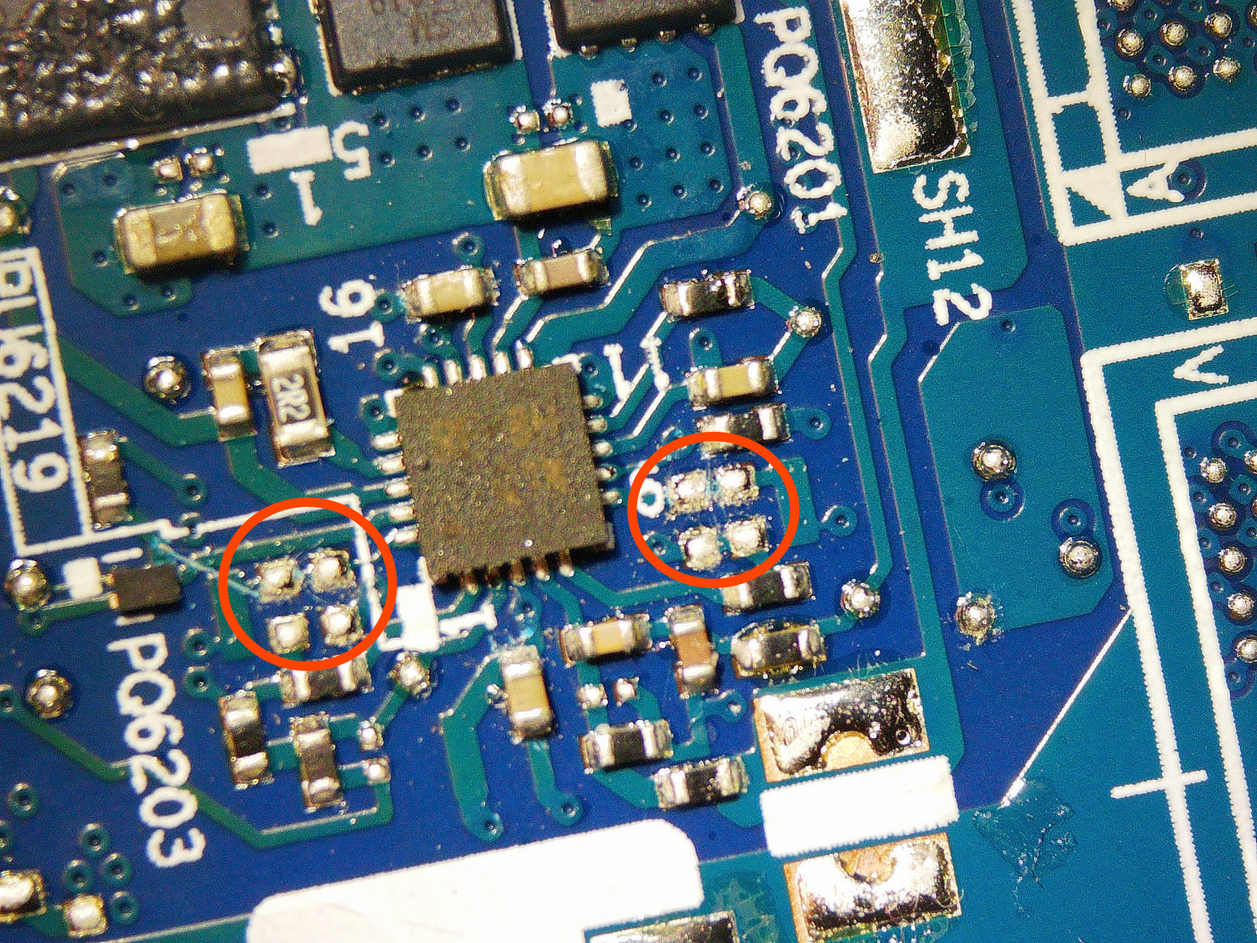

                                    +3VL at PC6205, near PU6219 0 VOLTS
                                    +3VALW at PJ6201 0 VOLTS
                                    +5VL at PC6204 (one side is GND, the other is +5VL) 0 VOLTS THESE ARE WITH THE CHARGER ONLY PLUGGED IN.
                                    +5VALW at PJ6206 0 VOLTS
                                    +3VALW_PCH at J2 CAN'T FIND!
                                    +1.8VALW at PJ7912 0 VOLTS
                                    +3VS at J5 0 VOLTS
                                    +5VS at J4 0 VOLTS
                                    +3VL at PC6205, near PU6219 3.28 VOLTS
                                    +3VALW at PJ6201 THE METER JUST RAPIDLY FLASHES!
                                    +5VL at PC6204 (one side is GND, the other is +5VL) 5 VOLTS
                                    +5VALW at PJ6206 THE METER JUST FLASHES RAPIDLY! THESE READINGS ARE WITH THE CHARGER AND THE BATTERY PLUGGED IN!
                                    +3VALW_PCH at J2 CAN'T FIND?
                                    +1.8VALW at PJ7912 .06 VOLTS
                                    +3VS at J5 0 VOLTS
                                    +5VS at J4​ 0 VOLTS

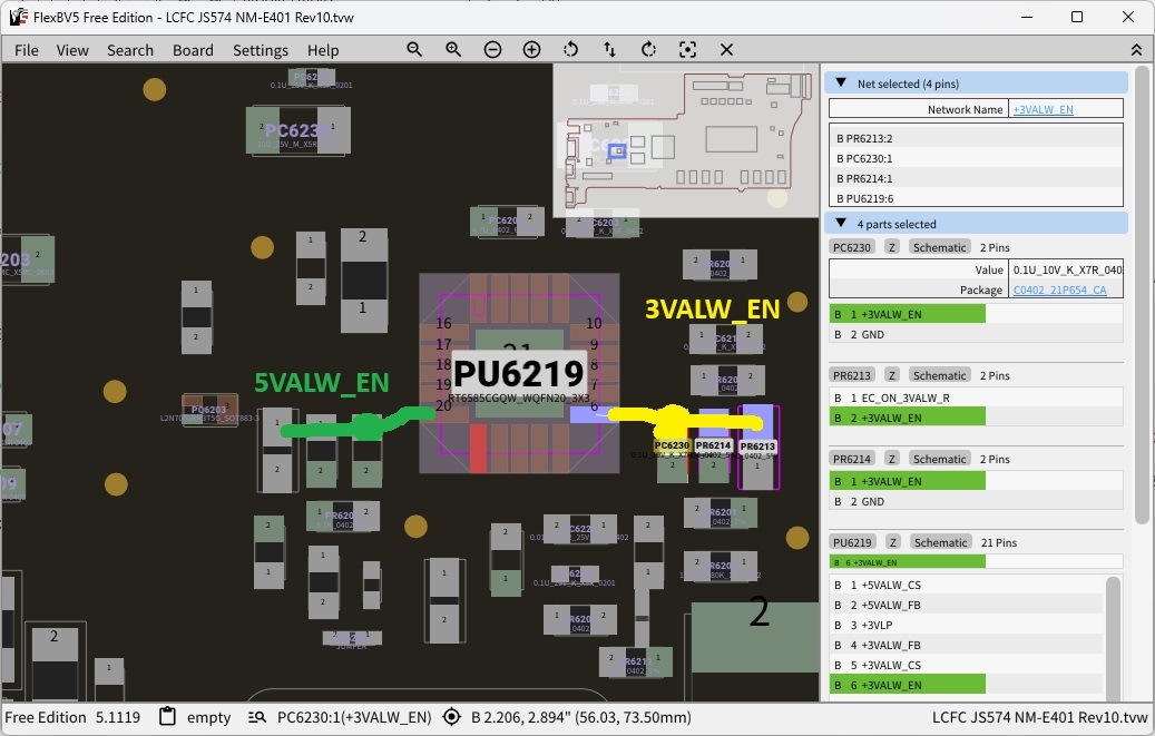

                                      You're missing both +3VALW and +5VALW, those are very important, if those are missing the power on sequence stops there
                                      Measure +3VALW_EN on PC6230 (may be missing from the board, that's ok)
                                      and +5VALW_EN on PC6231 (may be missing from the board)
                                      Those should be high level, 3.3V, if they're 0v something went wrong
                                      I've marked the location where you can measure those signals, in green for +5VALW_EN and yellow for +3VALW_EN
ID:	3661993 Good morning. with just the charger plugged in, 0 volts on both. with the charger and the battery plugged in, I get that rapid flashing OL symbol on the meter on both. Its seems like something is getting two sources of power at once or something.

                                          Try setting your multimeter to volts, manual range appropriate for 3v, if it's auto range
                                          If manual range set to 20v range
                                          Just want to confirm if that chip is being told to enable the 3VALW and 5VALW outputs by the EC IT8227 (it's branded "Lenovo", a BGA chip which may have black glue on the corners, it it has the glue better not to try to remove it, as the pads on the PCB may become damaged)
                                          Inspect the area first for stray solder blobs
                                          Expected steady 3.3v on those enable signals
                                          Also check RE4501 and RE4505, should be 0 ohm resistors, or may be just traces, those feed 3VL to the EC
