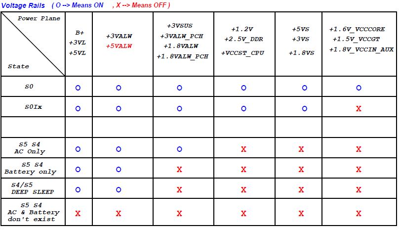

                The chart is for reference which voltages should be present, do not apply power yet until after checking resistance values

                    With only battery connected, before pressing power button you should have
                    +3VL
                    +5VL
                    +3VALW
                    +5VALW
                    You can measure those voltages, on the caps I listed, the board view shows which side is + (no need to measure voltage from GND to GND 😀, of course the side of the cap you measured 0.1ohms to GND is GND)
                    That's S5 state (power off)
                    S0 is power on, After pressing power button you get all voltages
                    S0Ix is the "modern standby" state after power on, when you close the lid/after some time when the laptop sleeps

                        The S5, S0 are the power states
                        S5 means "power off", S0 is "power on" that's what the chart means, on each power state there's the expected voltages
                        So when the laptop is powered off, it's in S5 state
                        When it's powered on, it's in S0 state

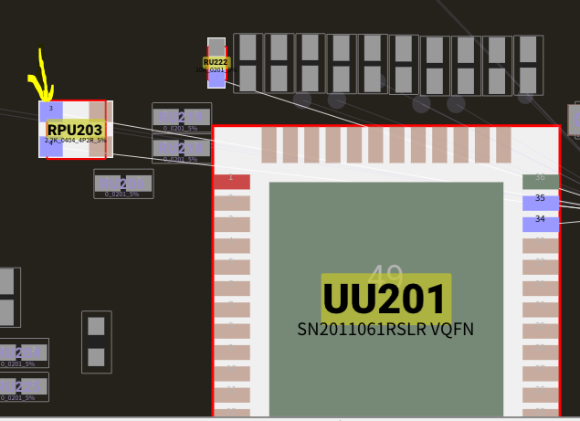

                                  At that point you should even get 5v on PL8301-PL8302 with only charger plugged in, if nothing gets there, the MOSFETs are not turning on
                                  With charger plugged in, measure VCC3_LDO_PD1, you can check at the left side of RPU203, should be 3.3v
                                  At the D of PQ8302-PQ8303, or the D of PQ8304-PQ8301 depending on which port you connect the charger, you should get 5v, or 20v when everything works properly
                                  At this point the 5v only reach the S of PQ8302, or S of PQ8304, again depending on which port you connect the charger, that's straight from the USB-C ports
