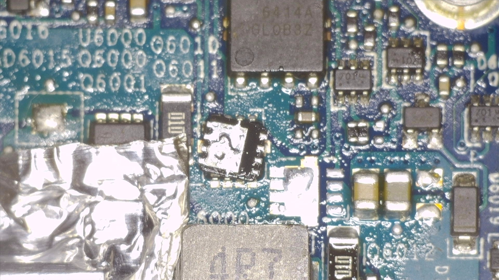

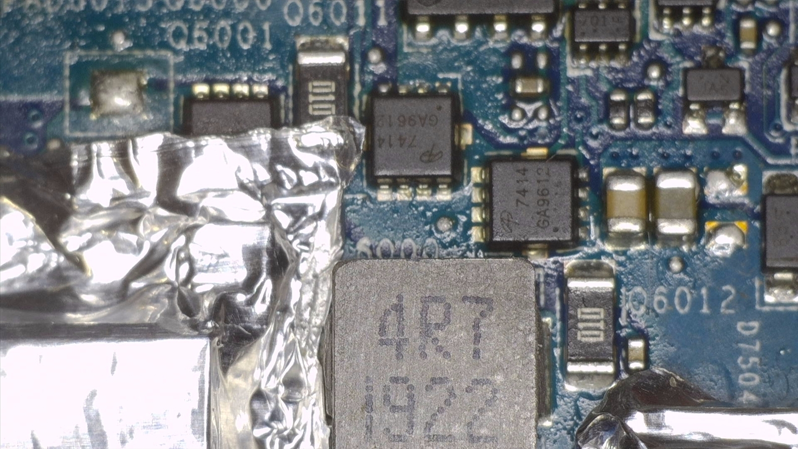

    Ha, I was practicing on an old board I trying to remove an, what looked like a mosfit, 8pin.I put some flux on the pins and a little solder then used this heat gun.It seemed liked it took for ever at least a couple minutes and then the gun shut off. I even tried turning it on a couple hours later and it still don't work. I'm thinking about this one I found from amazon, it has the air pump like you suggested so it should work a lot better hopefully.

        I used aluminum foil adhesive tape to shield a plastic keyboard connector on that board
        The Quick 861DW is a good option, also look at Atten ST-862D (i have this one), those two are the most widely used by repair shops, Amazon is selling some 861DW knockoffs under random brands (while using the real Quick product images) but can't guarantee they work for long
        Noticed they have gone up in price recently, the website mon2 linked has the Quick 861DW at the lowest price at 250usd (around the same it was before)
        Took me around 50 seconds with the Atten to remove it, 430 deg. C/airflow 70% (while i was distracted setting and looking at the stopwatch on my phone )

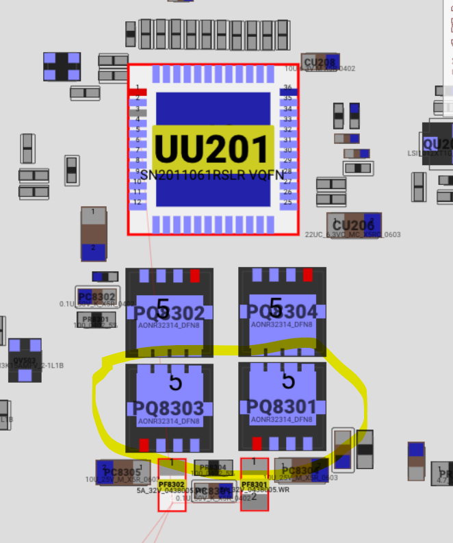

                Well I replaced those two mosfets, what a pain in the arse. The new ones were a little bigger than the original so it was hard to see exactly where to place it. I got them on, put everything back together and then put power to it. I was still getting 5 volts but now I was getting 6 to 700 milliamps! Oh Oh, not good. I must of shorted something. Took motherboard out of unit again and fired it back up. I got out my thermal camera and seen the charge controller was red hot. I unsoldered the two mosfets I put on, didn't make a difference. I getting some pictures together and will post tomorrow, I'm exhausted now. I was real happy with the Atten 862D and the Andonstar scope. I now have to learn how to use them right. Hope I didn't trash this board. Til tomorrow.
                • m1ch43lzm
                  • Mar 2019
                  • 1087
                  • Peru
                  #68
                  As long as the S and G pins physically match on the board, and they're not shorted it should be fine, always use flux when soldering
                  Check for solder bridges on the MOSFETs you replaced, and on the components around them (it's a tight fit)
                  With both mosfets removed measure resistance to GND at TBT_VSYS (bottom of PF8301-PF8302)
                  Which chip gets hot? The BQ25710 (PU5301) or the TPS65994 (UU210)?
                  Take your time, it's a good idea to measure for shorts before powering on and before/after replacing components, also keep practicing on dead/scrap boards, you'll get the hang ot it, laptop boards really absorb a lot of heat

                    I believed that those fets i put down seemed ok, doing a diode test on them. They must not of been the problem with the high current.
                    Bottom of pf8301 and pf8302 to ground = pf8301 & pf8302 both read 47.1 ohms. These are fuses correct?
                    TPS65994 gets real hot. Five +5VALW pins (11,12,17,25,26) on UU201 all measure 14.4 ohms to ground. Measuring across CU201 & CU206 , both read 14.4 also.
                    Yes I need practice no doubt. I put Kaption tape all around those mosfets before I heated them. I used gel flux and ended up setting my temp at 400* and air at 60%. Man, you have to be coordinated to hold that heating gun and hold that chip down on the board with tweezers, while watching the screen, crazy. After I put down those new mosfets, I couldn't help but say "perfect" in my Sorin voice LOL. Thank You!​

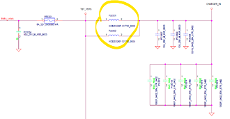

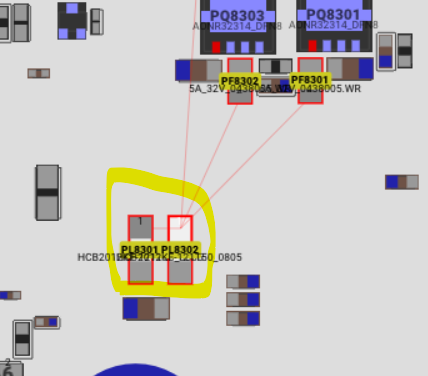

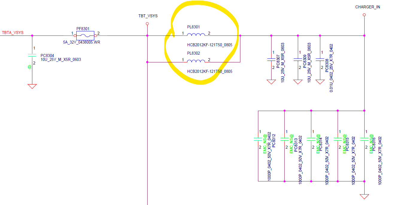

                            After those fuses, according to the boardview it goes to both PL8301 and PL8302, and back to UU201 (TPS65994) pin 3, TBT_VSYS
                            After both PL8301, PL8302 (CHARGER_IN) it goes to the input of the BQ charger through PR8301
                            You can remove both PL8301 and PL8302 (you can move them so they make contact with only one pad on the board, that way you won't lose them) to isolate which side is shorted, if it's the TPS65994 or the BQ25710

                                Measure resistance to GND at the main rail (labeled 20VB+, but it's the main battery voltage) at PJ6202 (it's a solder blob), should be in the Kohm range or more, don't want a short there
                                Also, measure resistance to GND at the S (1-2-3) of both PQ8302 and PQ8303, that's the input from each USB-C port, that also goes to the TPS65994, you should have several Kohms or more
                                I want to confirm if the short is on the TPS65994 side, by removing PL8301 and PL8302 the input to the BQ charger gets isolated
                                Click image for larger version  Name:	pl8301-2.png Views:	0 Size:	80.8 KB ID:	3647834
                                The components in green marked with @ may not be present on the board

                                  Do you want me to remove those inductors, PL8301 & PL8302?
                                  • mon2
                                    • Dec 2019
                                    • 14766
                                    #77
                                    Yes, to isolate the power rail.
